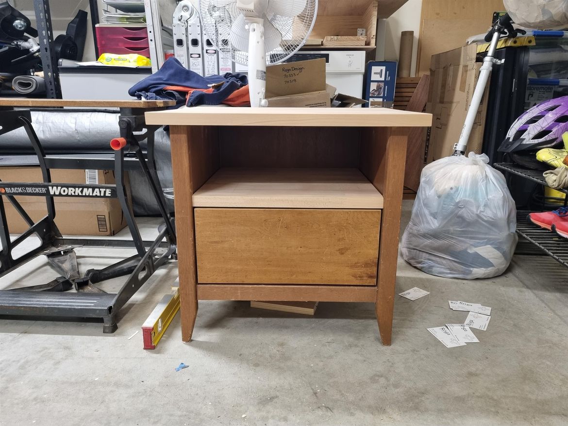

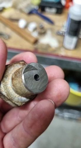

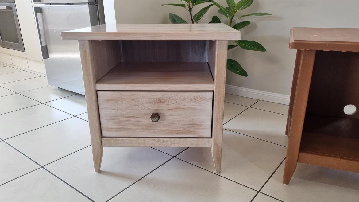

Pre loved side tables were in deperate need of a new look and additional storage. I removed the old tops and replaced them using 26mm Beech Laminated Panel. I had enough panel to make both tops and a shelf for books etc with very little wastage.New top, shelf & drawer frontI added a new storgage drawer with soft close runners and upcycled an old, solid drafting board to create some sentimental drawer fronts, thanks Dad! I picked up an old bolt on the beach from under a bridge in Barwon Heads, Vic and decide it would make the perfect drawer pulls. I cut the bolt in half and tapped a thread to attach.
Barwon Heads bolt (drawer pull)
The bolt, cut!
Drawer pull

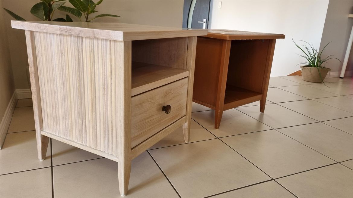

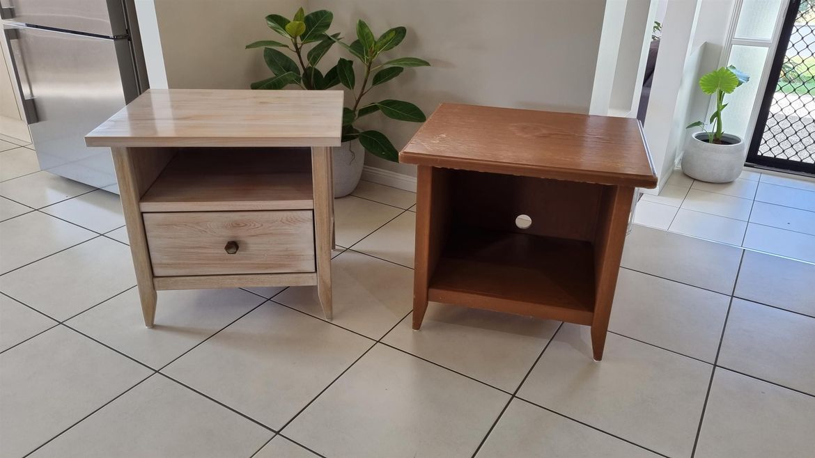

New top, shelf & drawer frontThe sides were clad with Tassie Oak 18 x 6mm flybead for an updated look.Tassie oak fly beadI sanded all sufaces back to raw and coated with a simple whitewash before sealing with a few coats of Cabots CFP floor in satin. I find the CFP floor very hardwearing for busy surfaces.Old to NewFinshed tables gave the bedroom a lighter feel and plenty more useful space.Hope you enjoy the project!Rob
Old to NewOld to New

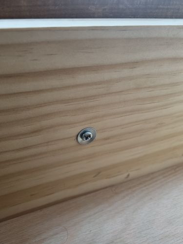

Love the bolt idea! So is it attached with a nut on the other side or you inserted a nut into a draw panel? And also did you put a clear coatover the bolt?
Ahh, I drilled and tapped a thread into the centre of the bolt after it was cut to length. Was worried that the metal would be too hard, but managed to get it done. Then just a screw from inside the drawer like any other drawer pull 👍
