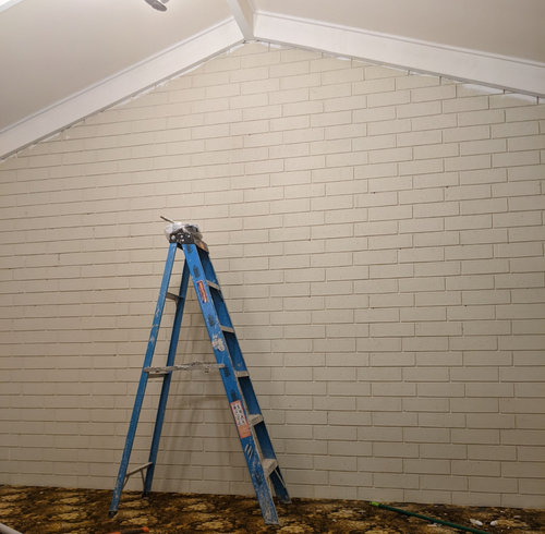

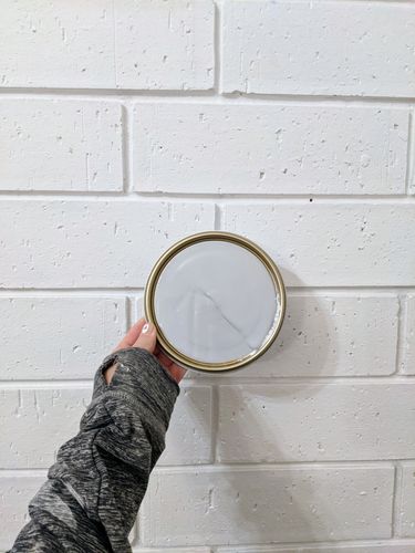

Step 1 : paint both bricks and mortar lines white using a rat tail paintbrush for mortar lines and roller for the bricks.
Note: use the paintbrush to coat any textured bricks or patches that the roller does not reach.

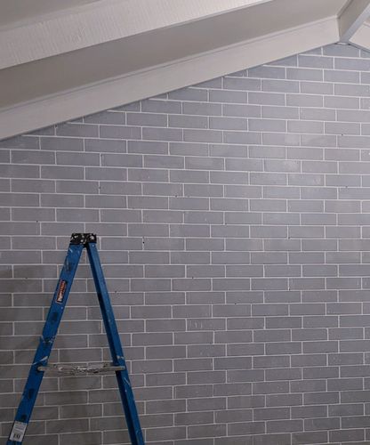

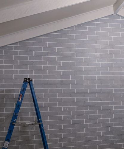

Step 2 : use a roller only to apply grey paint or colour of choice to bricks, leaving the mortar lines white.
Repeat step 2 for greater coverage and a more contrasted look.
Note: ensure that there is only a light coat of paint on roller to reduce chance of paint dripping into grout lines.
3 coats of paint later, we are super happy with this wall and it's now the focal point of our living room!
