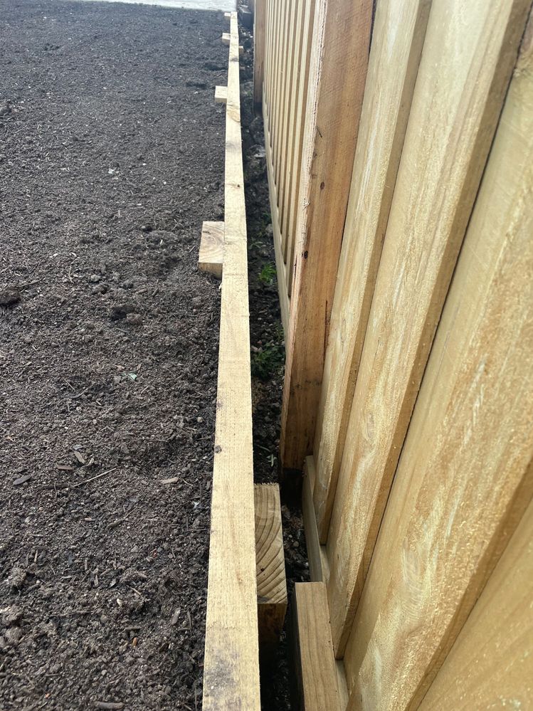

I recently had some concreting work done and my backyard in the process of being levelled. My block had quite a slope towards the back fence, so a retaining wall was installed and filled in.

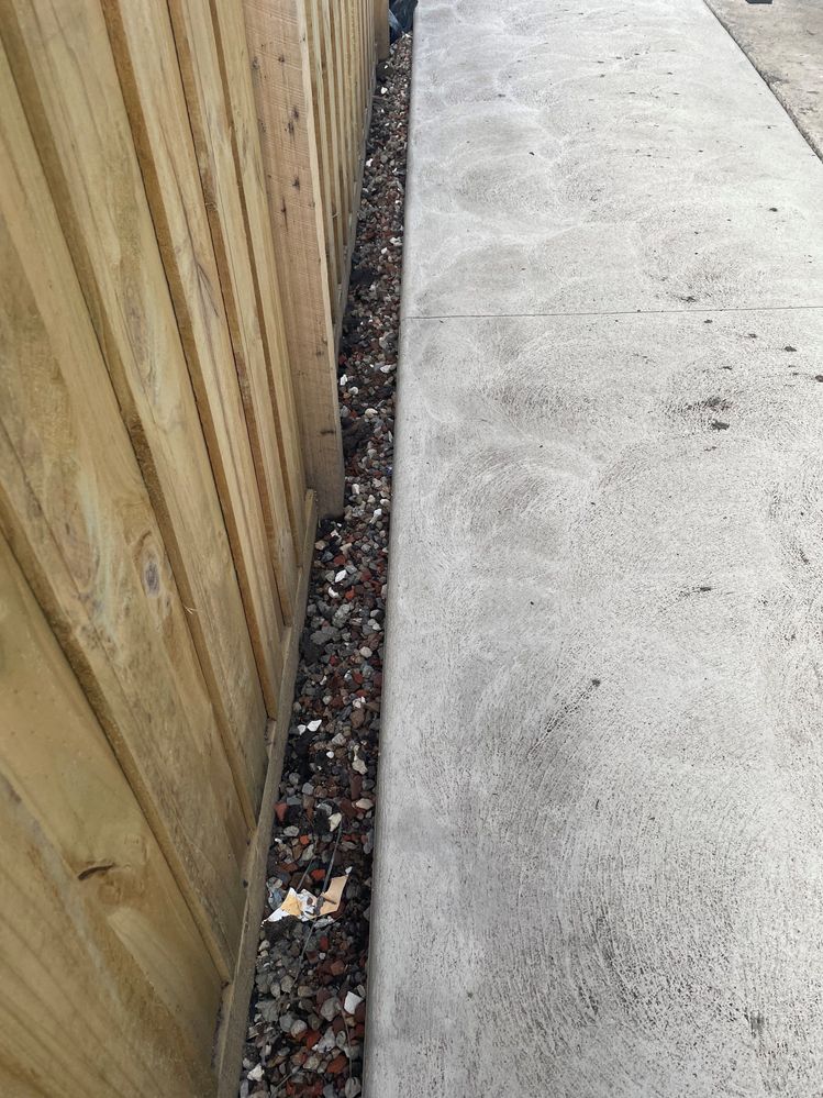

For both the concrete and the retaining wall, there is a small gap with has been left to keep both off the already installed fence which I am looking for advice on filling in. For the gap between the concrete and fence, I have been told large river rock is a good option as it allows water to drain to keep the fence from rotting. Is this true?
I am mainly unsure about what I can do with the gap between the retaining wall and fence. At its deepest, its about 1m roughly from the top of the wall to the ground. I have small children, so wondering what is the best way I can block/fill this gap, whilst not exposing the fence to increased deterioration?
Any help would be much appreciated. I have added pictures of the areas for reference
Concrete gap
Wall gap
