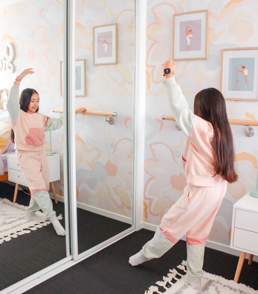

When redoing Savannah’s bedroom for her 10th birthday, one thing she asked for was her own little dance area. With a double bed, a desk, cube storage units and a set of draws, the available space for a dance area was pretty limited!
I decided to makeover her wardrobe and give her mirror sliding doors (doubling as her own dance mirrors) and try my hand at a little DIY for a ballet barre.

I got Savannah to stand facing the wall and pretend she was holding a barre so I could measure an estimated height the bar needed to be to ensure it wasn’t too short or too tall for her.

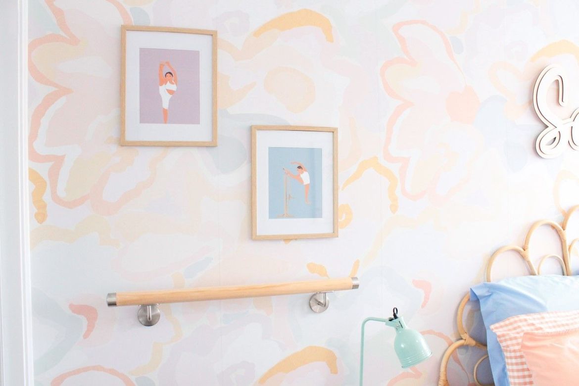

Once home, the process really was quite simple. We cut the dowel to our desired length (ours is 80cm) and attached the two end caps.
Step 5

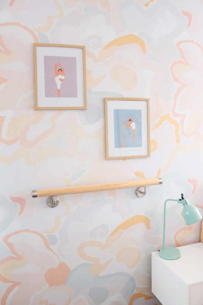

I checked the desired height again on the wall. I used a pencil to mark the positions for the brackets and then used screws to attach the brackets to the wall with a hand drill.
Step 6
The last step is screwing the dowel to the hand rails. I lined the dowel up to ensure it was centered and used the provided screws and a hand drill to attach the dowel to the brackets.
Step 7
The final step was to give it a quick wipe down and it was ready to use!
