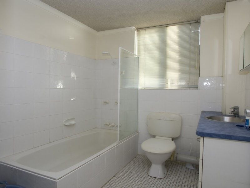

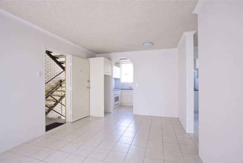

As you can see, the kitchen, bathroom and living area were all stuck in the '80s.

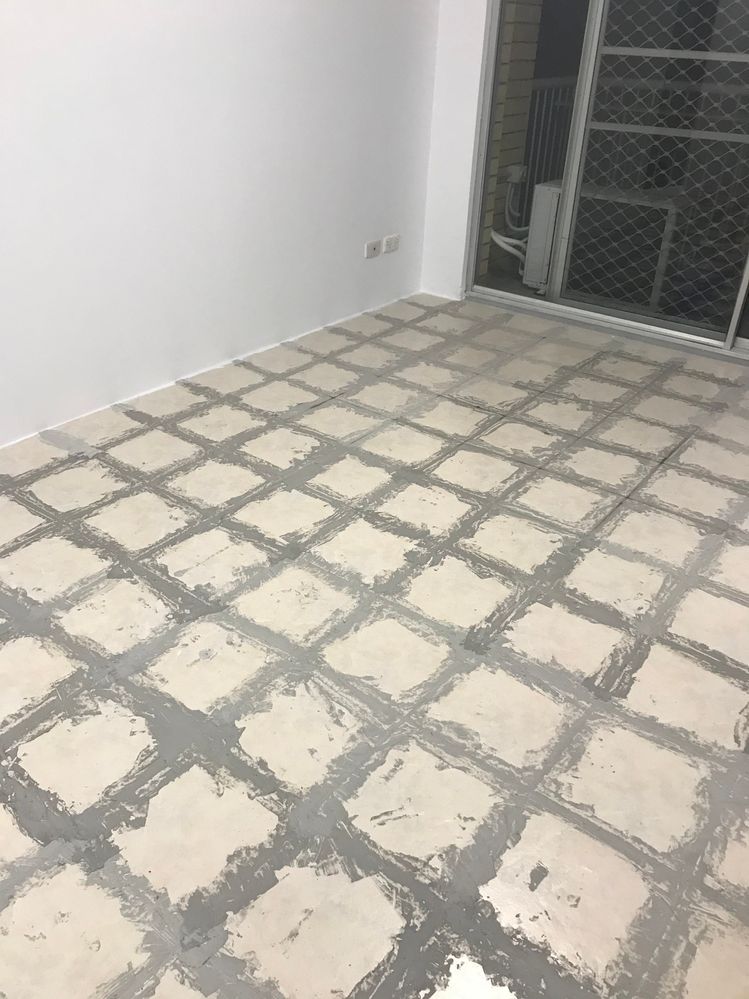

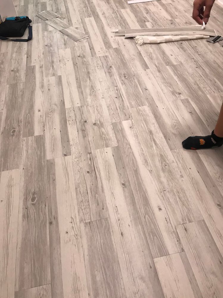

8. For the Gerflor vinyl planks, again, follow the instructions. Realise that filling the grout gaps between tiles to achieve a smooth subfloor takes hours. It’s back-breaking work and really hard on one’s knees. But if you want your floors to look good and remain smooth, it must be done. Allow three times as long as you think it’ll take.
Use the Dunlop compound to fill the grout gaps between tiles

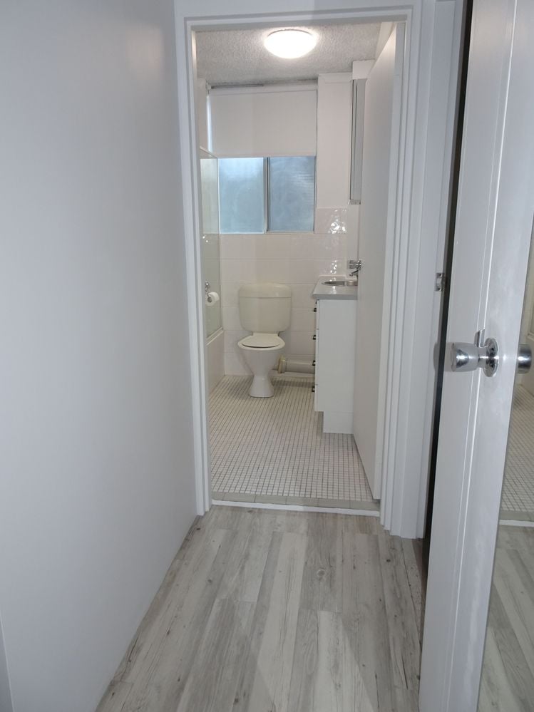

9. Laying the Gerflor vinyl planks is relatively easy; the tricky thing is the measuring of the fiddly bits for cuts around corners, etc. Factor these into your estimate … and then double it! I laid the entire floor (kitchen, living/dining and hallway) in one night but I saw the sun rise and didn’t finish until 10am.
10. When laying the vinyl planks, replace your Stanley knife blade at reasonable intervals. You’ll need a few.

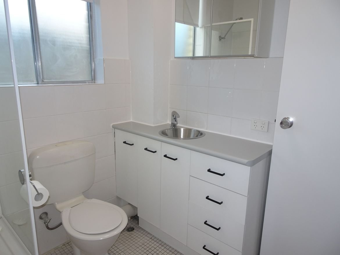

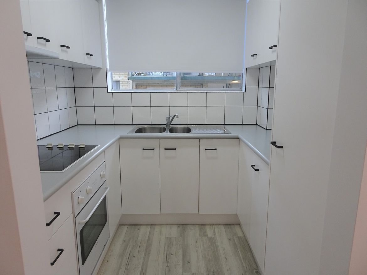

11. Spray your cabinets, if possible, as it gives a very professional finish. We used the idea recommended in the Dulux videos of resting the doors on blocks with screws in them. My husband did the primer first on both sides of the doors; then he followed with two coats of the top coat on the back of the doors first, let them dry for a day or so, then flipped them for two top coats and two coats of clear gloss to seal them. Again, let these dry for as long as possible before you reattach the hinges.
12. Mark the doors correctly. We wrote in each of the hinge holes, then covered that with painter's tape so it wasn’t sprayed with paint. We also wrote the corresponding numbers on tape and placed those in each cabinet and drawer. I also did a little map of each numbered door and drawer. This prevents wasting time on working which door goes where – the more time you muck around with each door increases the likelihood of damaging the paint before it’s cured completely.

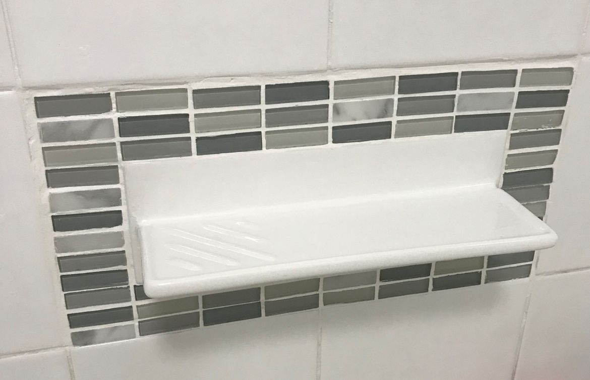

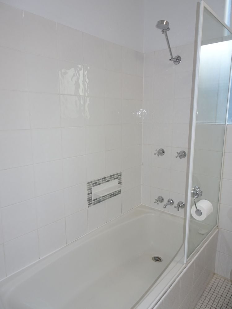

Bonus extra tip: Back yourself. You can do it! Have a go and be proud of the results. I'd never tiled before but I was able to change an outdated soap dish to a contemporary shower shelf.
Here is the 1980s soap dish...
... and here is the modern shower shelf!
