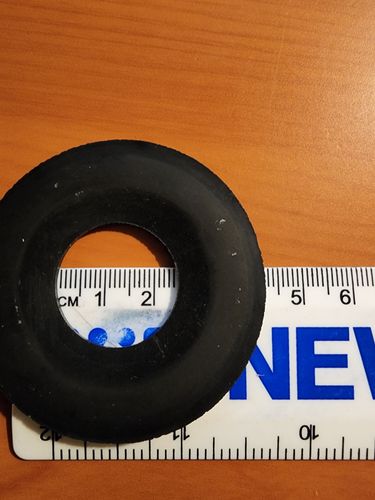

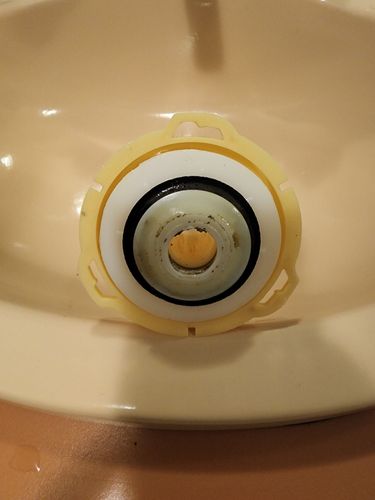

hi, would anyone know what model cistern this is. It's a coroma dual flush from aroind 1988?. Is this the correct seal for this model?

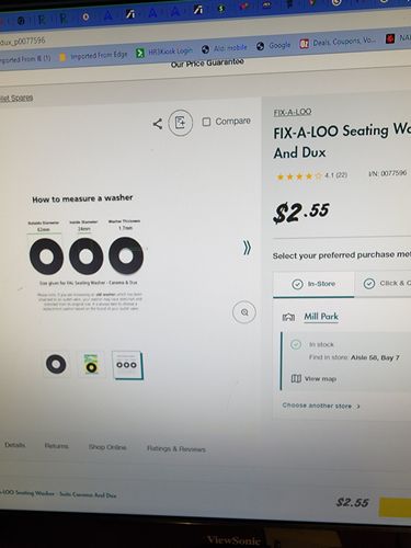

You're absolutely correct that is a Caroma Dual-Flush system. You have two sets to choose from the Kinetic Seating Washers - 2 Pack or the FIX-A-LOO Seating Washer - Suits Caroma And Dux. I suggest bringing the flushing arm with you to make sure that the washer fits neatly at the bottom.
My best tip is to bring the old washer with you to the store so that it will be easier to compare sizes.
