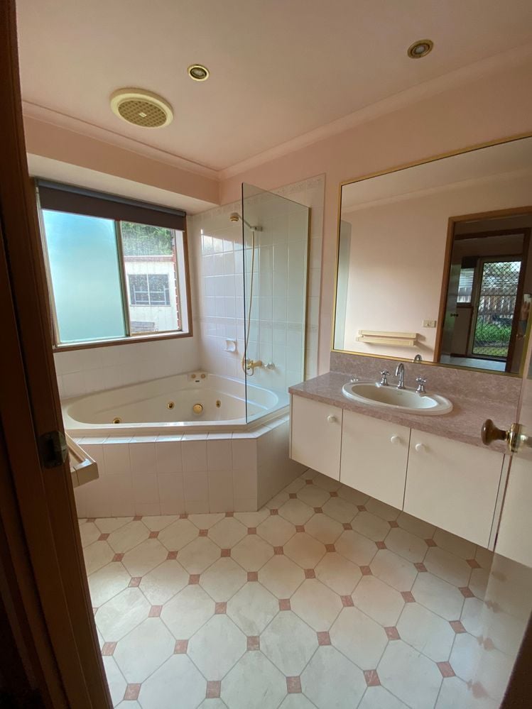

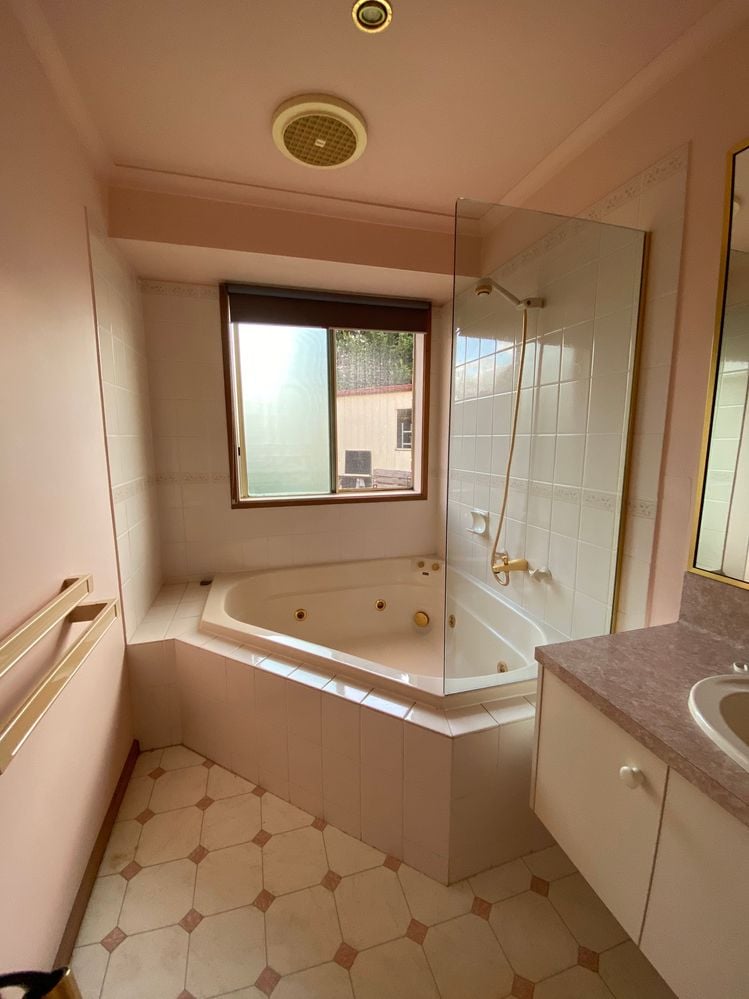

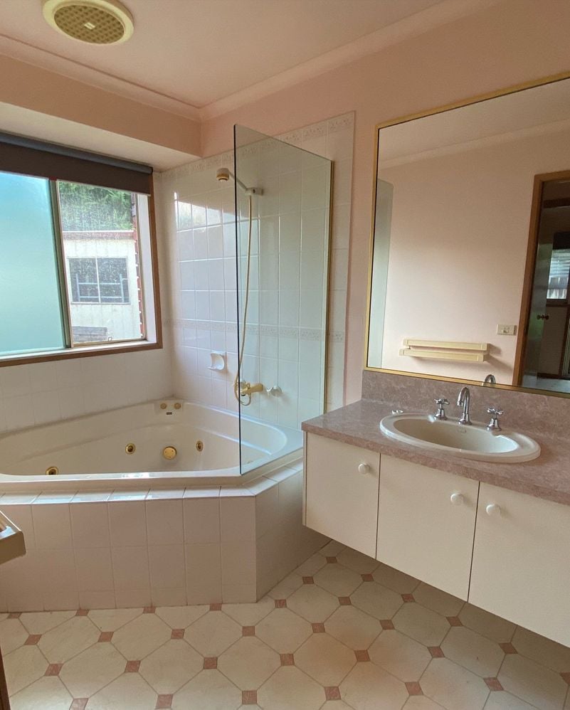

Our main bathroom was small and dated and had all the original features from when the house was built. We set out to design a bathroom from scratch as part of our full house renovation.
From working out how to fit a bathtub, shower and vanity into a small space to selecting all the products and finishes to create a light, bright and clean look, we completed almost every aspect of the bathroom renovation ourselves over a couple months. The only trade we employed was a plumber, who roughed in the new plumbing. What was once a dated, pink bathroom is now a light and bright space.
Demolition

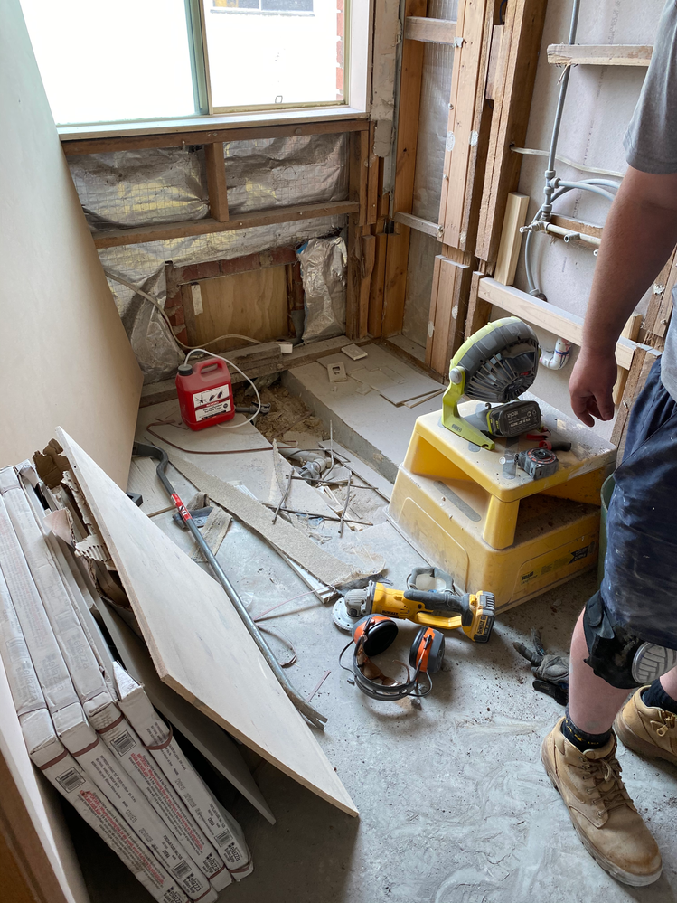

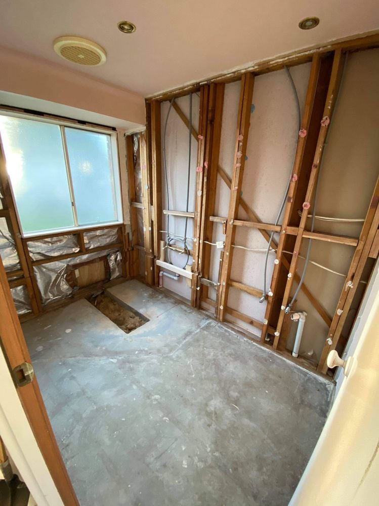

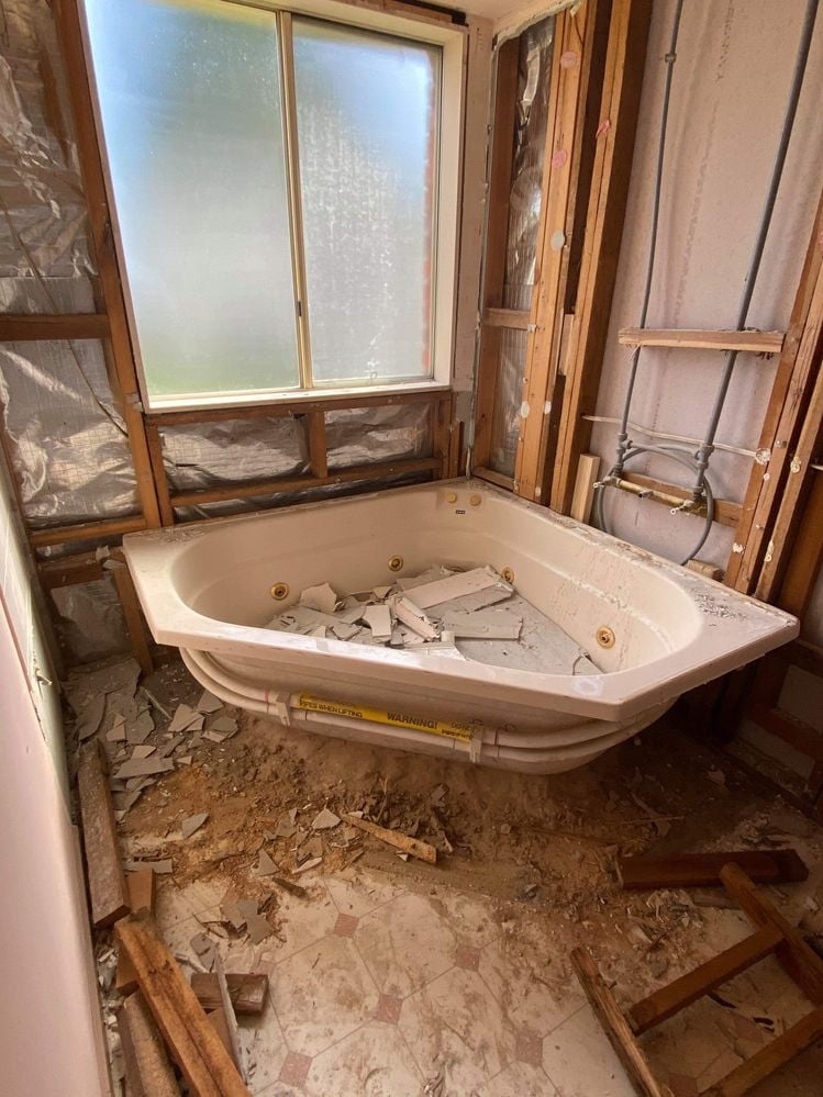

We started by demolishing the whole bathroom: removing the tiles and linoleum flooring, removing the plasterboard walls, dismantling the old vanity and sink, removing the glass shower screen divider and removing the old corner spa bath.

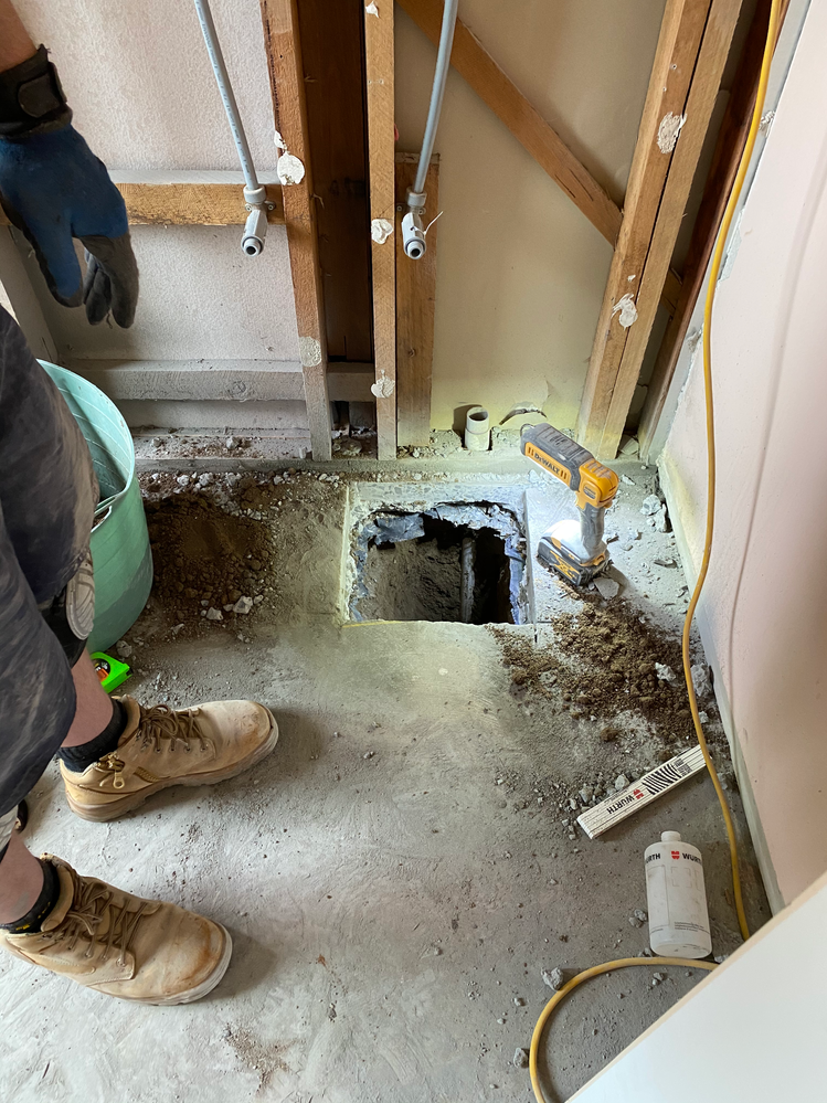

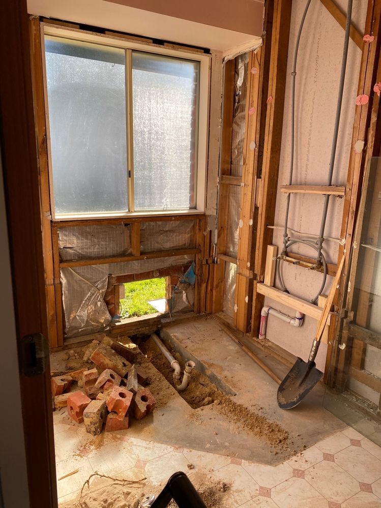

Once the corner spa bath was removed we had to cut the slab for new plumbing wastes for both the new bathtub and the floor waste for the bathroom.
Plumbing slab work.
We gutted the bathroom, opening up the walls for new plumbing to be run, and cut the slab to create a new waste location for the shower (where the old vanity had been).
Cutting the slab for new shower waste plumbing.
Cutting our the slab further for the bathroom floor waste.

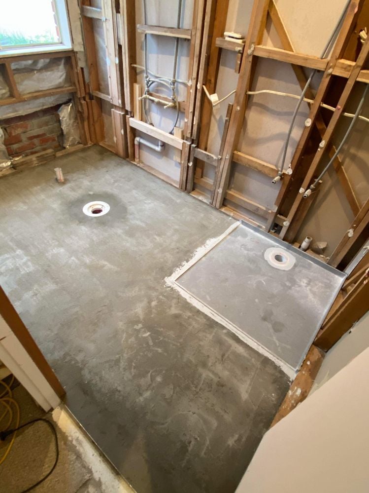

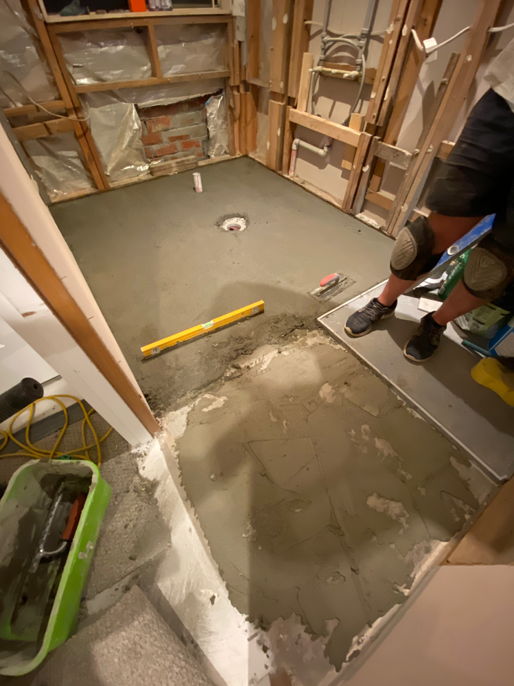

Once all the floor plumbing was done, we installed a tile-over shower tray, as well as an aluminium angle in the doorway. We then screeded the whole bathroom floor, ensuring that the screed bed fell towards the floor waste.
The materials we used included:
Screeding.
Screed completed and new shower tile tray installed.

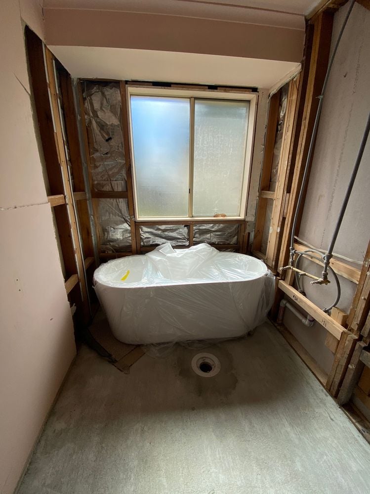

Test fitting the bathtub in the tight space.

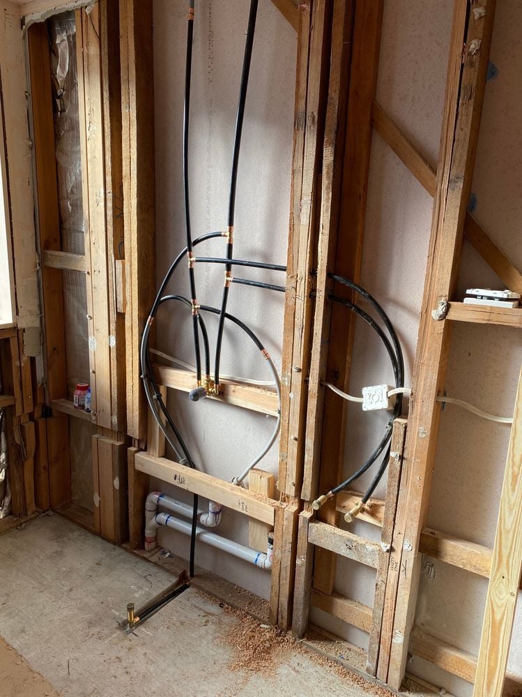

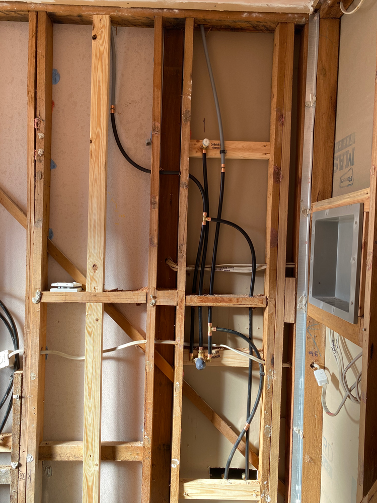

We installed additional studs in the wall for the shower-screen mounting locations and studs for the Mondella 365 x 320 x 90mm Shower Niche. We then called a plumber in to run new lines within the wall cavity and on the floor for the new bathroom layout.
Additional studs.
New plumbing layout, including floor connection for bathtub spout.

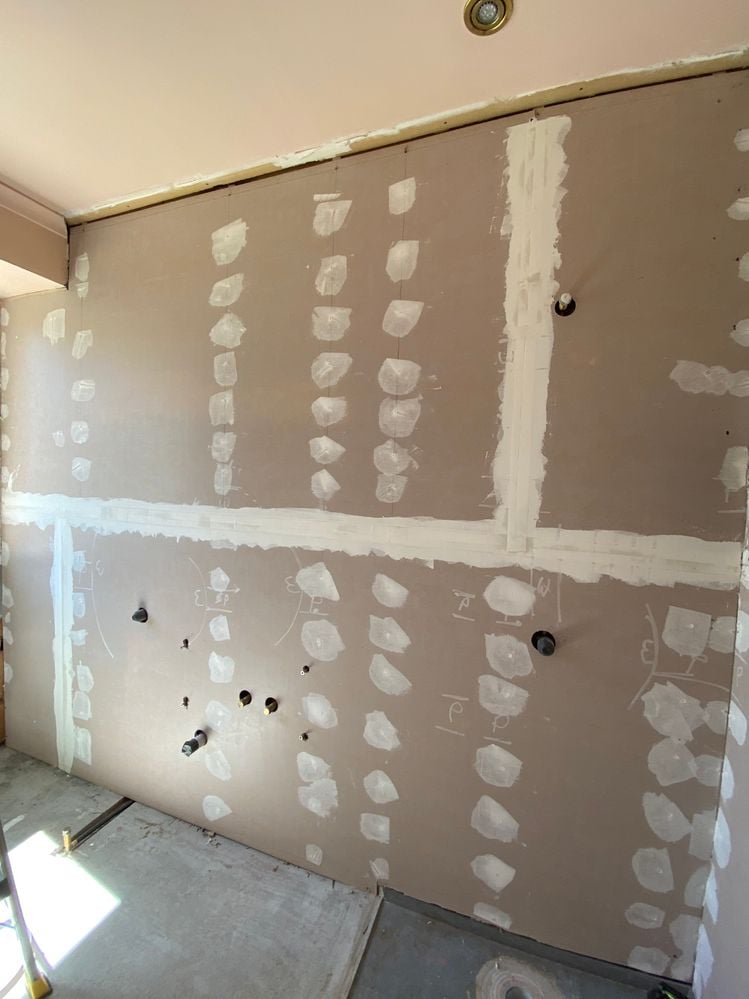

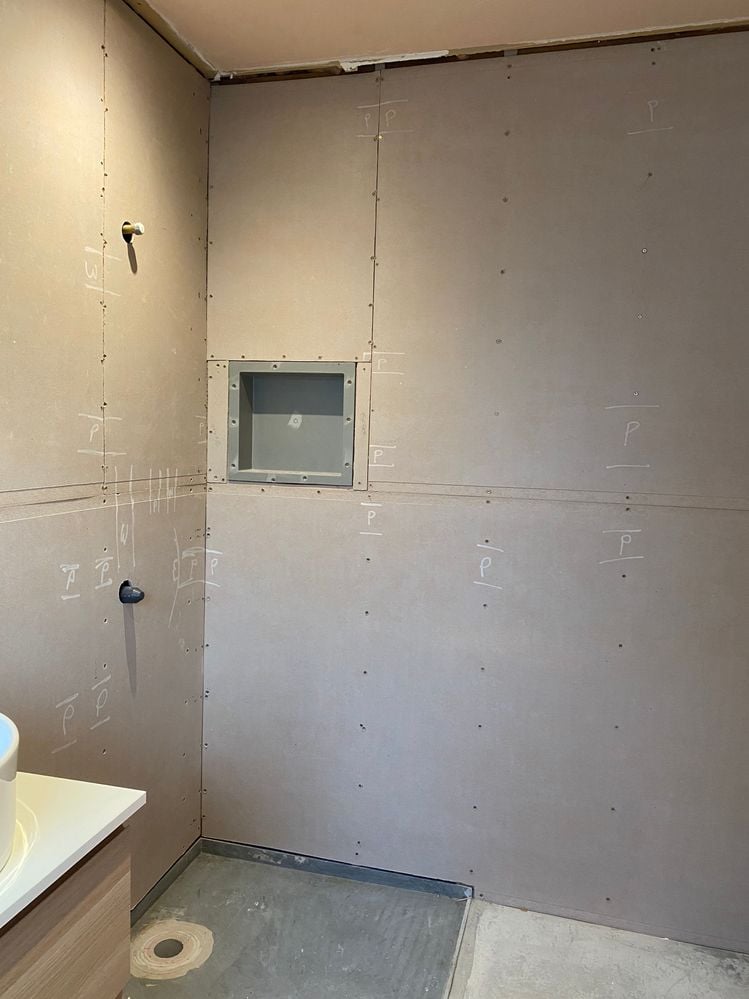

We then lined the walls with James Hardie Villaboard from Bunnings.

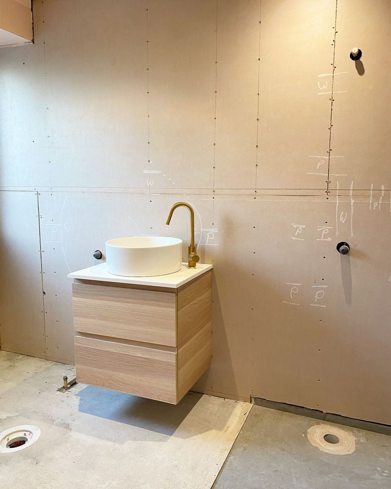

We test fitted the vanity for the height of the sink as well as width clearance between the bathtub spout and shower screen.
We used Gyprock Ultra-Top Topping Compound and mesh tape on the joints. Then we filled the screw holes and tape joints. We followed a Bunnings video tutorial and continued it all the way around the room on all the Villaboard-lined walls.

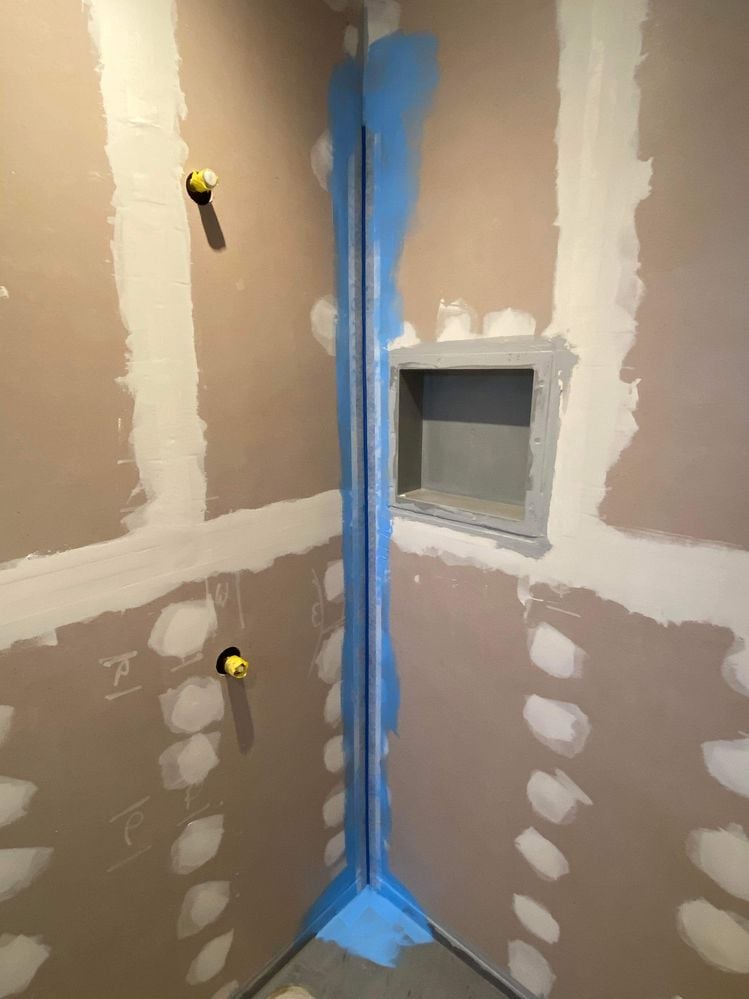

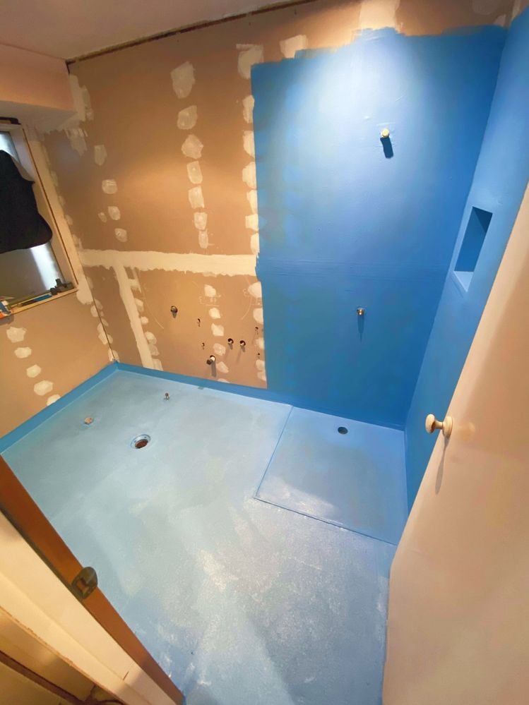

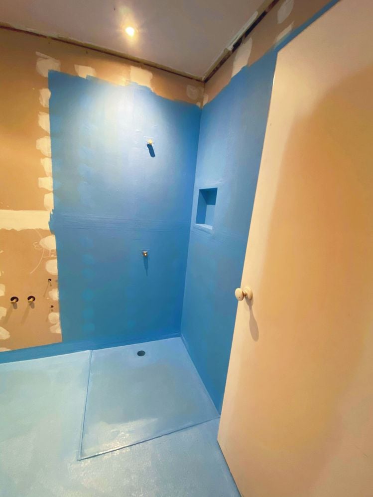

We used Gripset Betta Easy Seal Bond Breaker on the wall joints and shower base joints and around the plumbing outlets.

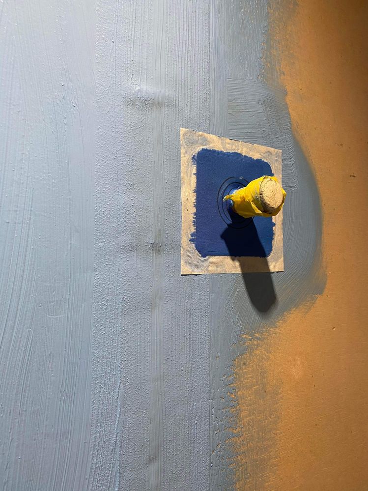

We applied a primer to the whole room and applied Gripset Betta Under Tile Waterproofing Membrane.
Applying Bond Breaker to the wall junctions.
Waterproofing around plumbing.
Waterproofing in progress.

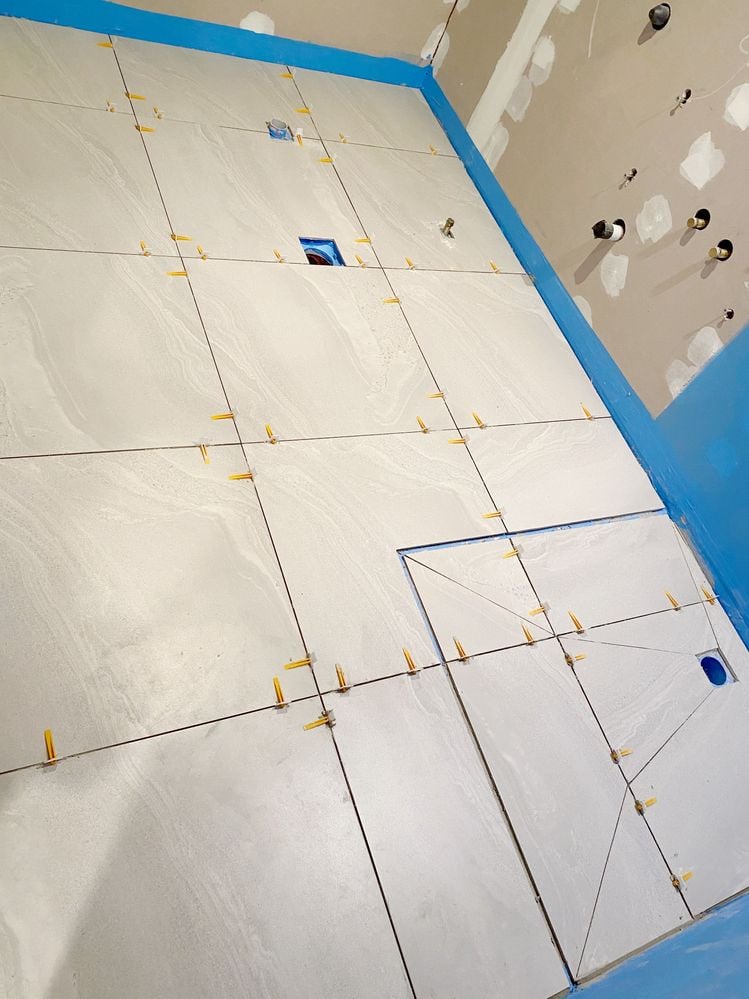

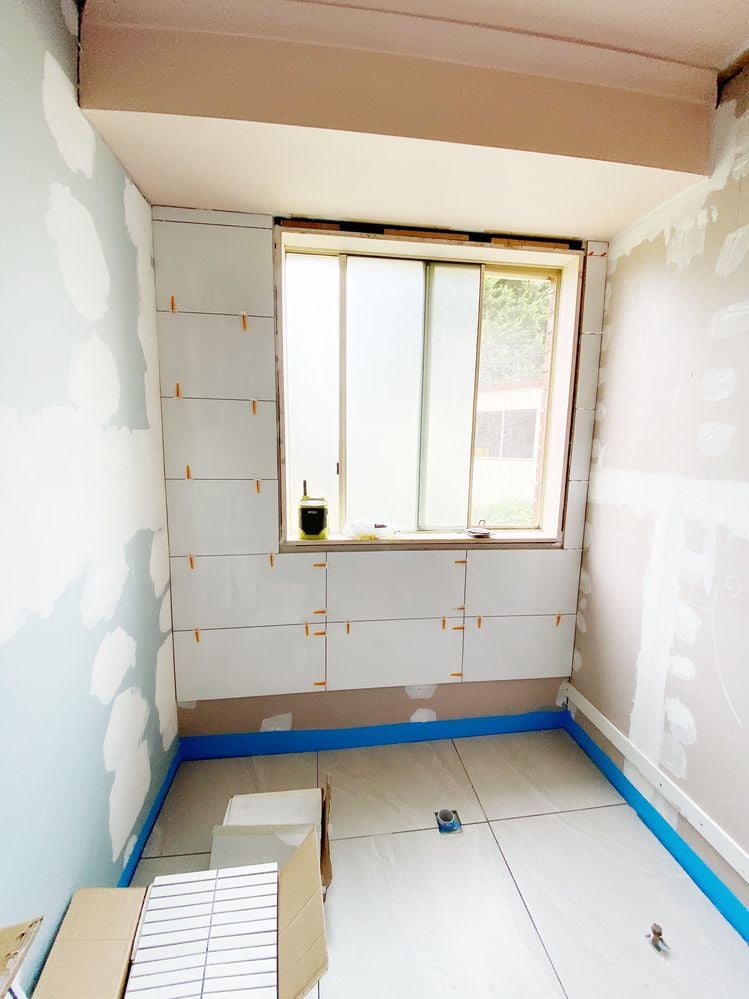

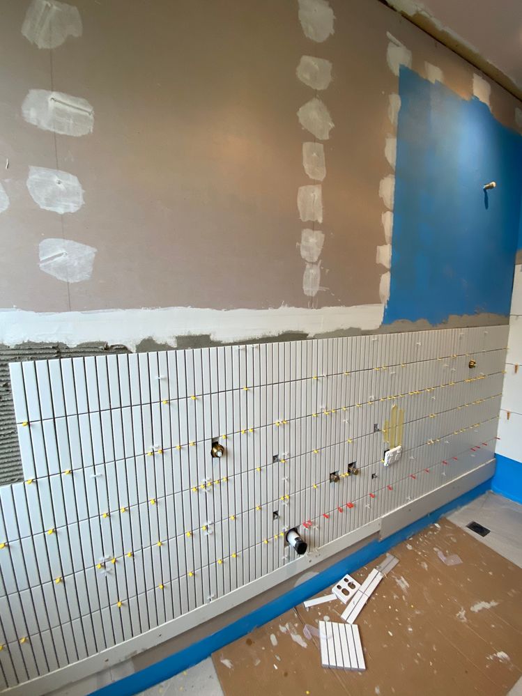

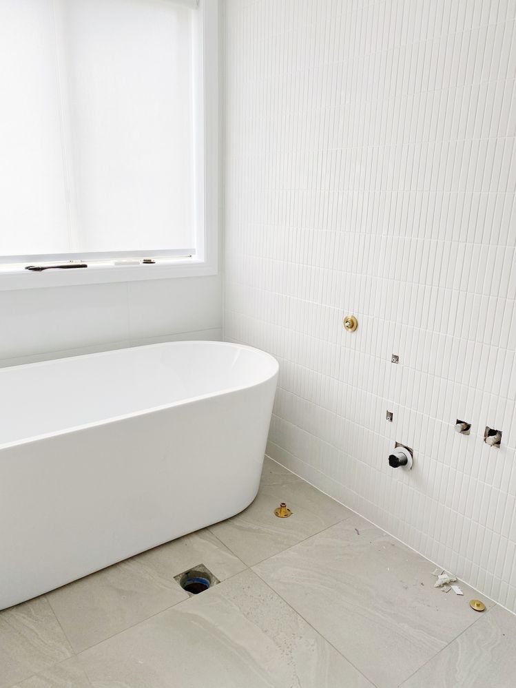

Tiling was a tricky process but we learned a lot from our previous ensuite bathroom renovation. It also helped that we used the same tiles for both bathrooms. This time around we knew how to perfectly cut each tile without breaking and wasting too many. The White Gloss wall tiles were easy to cut with a DTA 1000mm tile cutter from Bunnings. The large-format floor tiles, though, proved difficult and did not cut perfectly. For those we used a diamond blade and angle grinder to make each individual cut.
Once the tiling was done, we grouted all the tiled walls.
Tiling details:
Floor tiles and tile-levelling clip system from Bunnings.
Gyprock Aquachek lined on to the left wall.
The long process of tiling the back wall with Kit-Kat-style mosaic tiles.

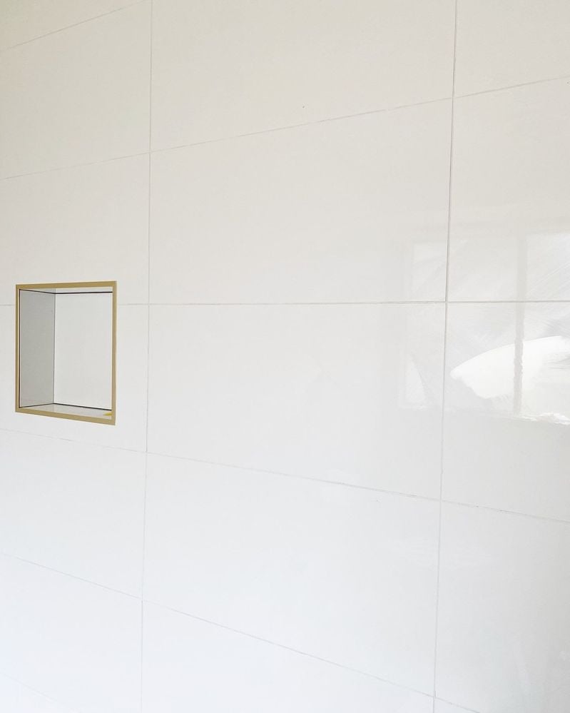

We used gold L-shape angle tile trim to box in the niche. It was much easier to install a trim piece than to cut a mitred edge on the tiles.
Tiled right-hand side shower and wall with tiled niche.

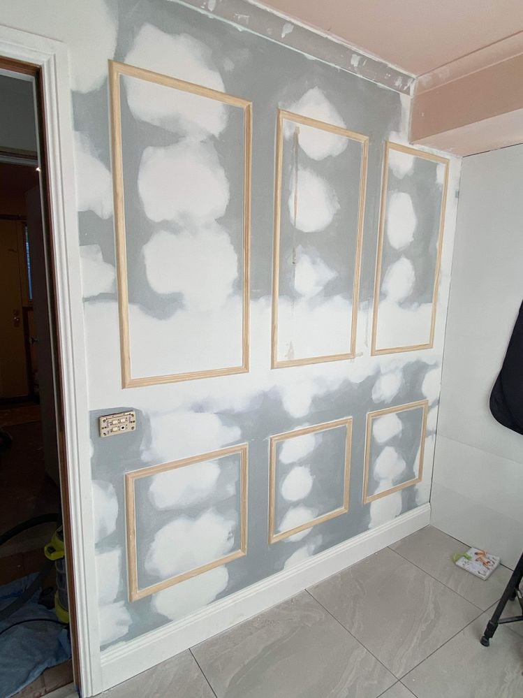

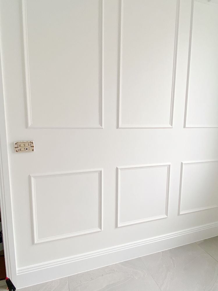

We lined the un-tiled wall to the left with Gyprock Aquachek and made it a wainscot feature wall to add some character to the room instead of having all four walls with floor-to-ceiling tile. We didn't want the bathroom to feel boxed in and it also allowed us to add a traditional element to an otherwise modern bathroom.
We installed new cornices around the bathroom, new window architraves, door architraves and bathroom door (all the same moulding that was used for the rest of the house).

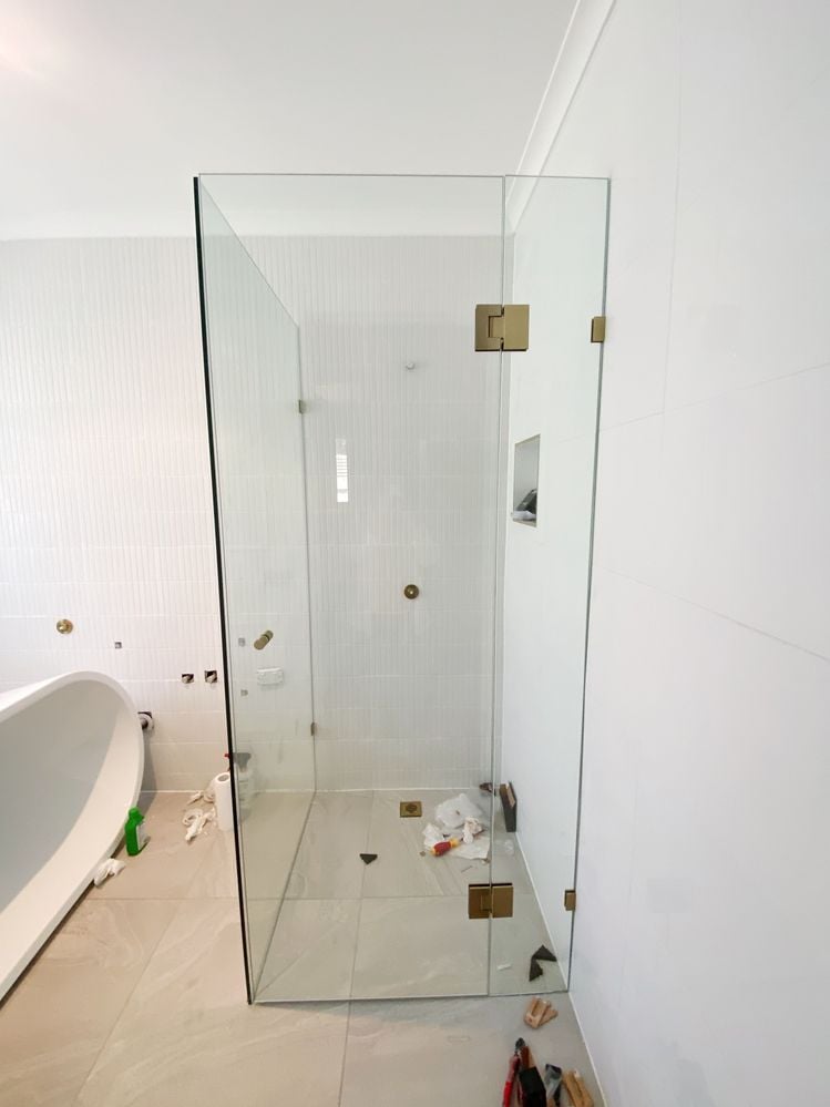

We were now on the home stretch! We installed all the tapware, frameless shower screens, bathtub, vanity, mirror and other bathroom accessories over a weekend and had everything siliconed and ready to use the following week. We opted for all brass fittings and finishes so that all the metal finishes looked cohesive in the space.

Frameless shower screen and shower floor grate installed.
