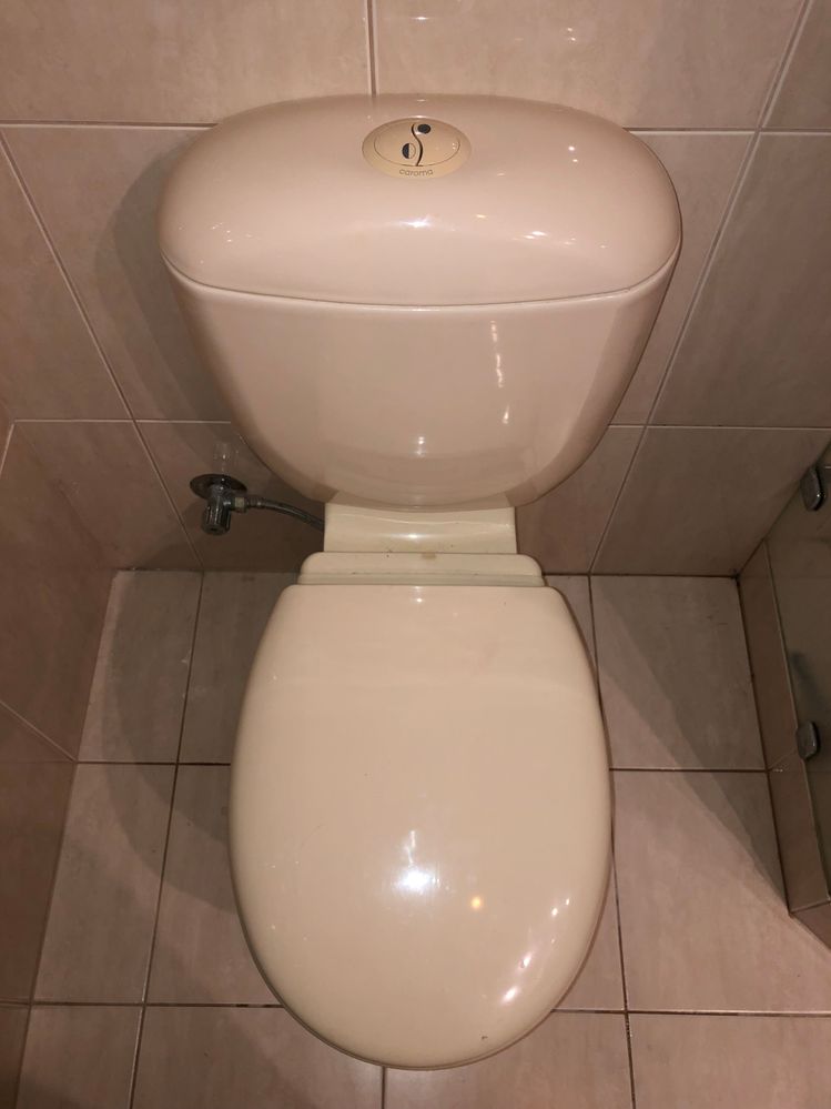

I have a Caroma dual flush toilet purchased in 2007.
I need to replace the pictured square outlet valve.
I don't know the Caroma model.
There is no information on the inside lid.
I did find this Fix-A-Loo product however how can I ensure its the correct part?

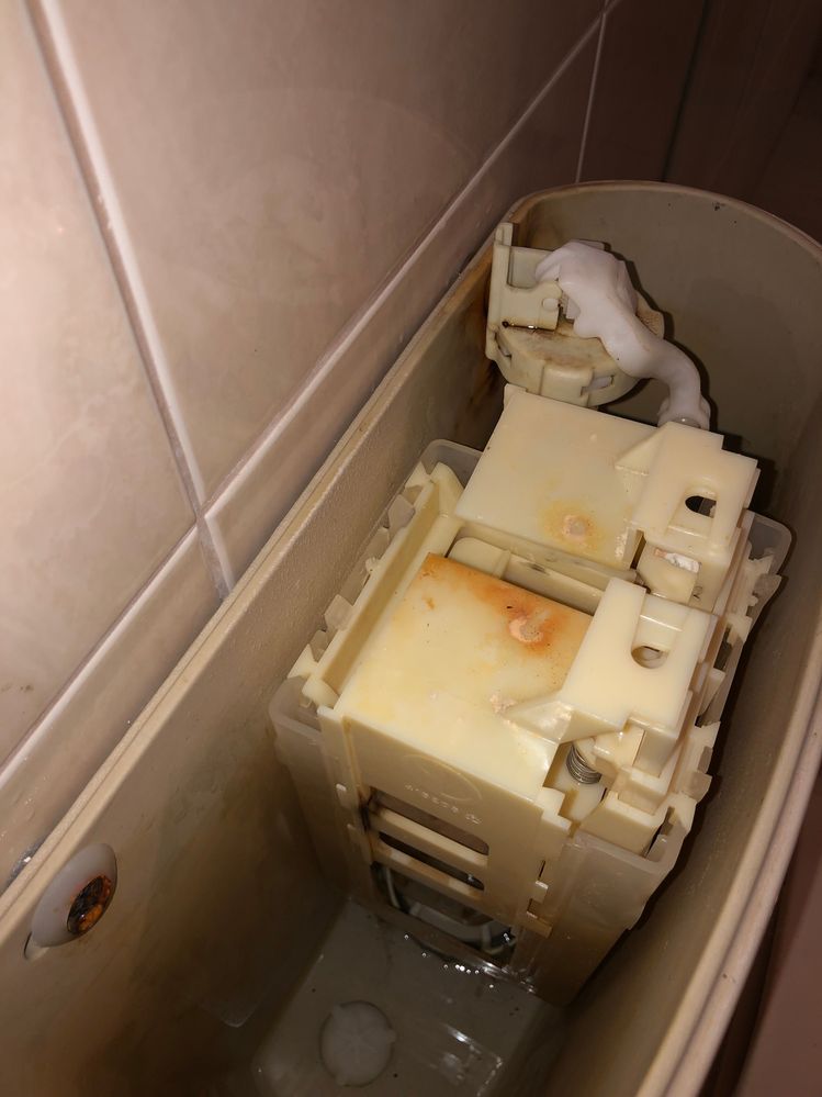

Hello @enzo60
Welcome to the Bunnings Workshop community. It's sensational to have you join us, and thank you for sharing your question about repairing your Caroma dual flush cistern.
Looking at the picture you've posted, it seems that the flushing system is still in good condition. I don't see any broken parts or cracks in the housing. However, if you have a leak that is letting water through to the pan, then all you need to replace is the washer for the flush mechanism. The only reason to replace the entire assembly is if there is a leak coming out of the body of the cistern itself.
I've placed a picture below that shows you the locking pins that are holding the flushing arm in place. I suggest gently pulling the two locking pins at the front to allow you to pull the front piece up. Then push the other two at the back so that you can pull the housing up. Bring the flushing arm to the store so that you can get the correct flushing seal for your set.
Once you've replaced the washer, put the flushing arm back into place in the same position making sure that the locking clips engage.

I recently replaced the washer with a Fix-A-Loo product suitable for Caroma & leaking continued.
Therefore i arranged a plumber to fix.
Plumber found another problem being a broken inlet valve which he replaced.
He reckons I correctly attached the new washer to the outlet valve.
looking at the unit I believe the flushing arm does not properly sit after a flush.
Any insight you may have would be welcome.
One of the things to watch out for is that the seating washer has to be positioned dead centre of the flushing arm. Even a small deviation will cause it to leak. The reason for this is that you are using a generic replacement part. I suggest using instead the Kinetic Seating Washers, specifically the orange one. In my experience, this washer has the highest rate of success with dual flush systems.
Another possible cause is that the bottom seat for the flushing arm is damaged or may have developed a crack in which case it might be time to replace the set. Give the flushing arm another go and if it still fails, then perhaps it's time to consider a full placement of the flushing set.

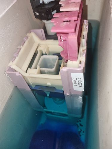

I looked for a caroma Dual Flush Valve type 1 413275 and was told on the how to replace this value that it will be replaced for free. Is this true
Hi @josephsavona,
The information you've received about this replacement part being free is likely related to whether the toilet is still under warranty or not.
I'd suggest having a read through the Caroma Warranty to see if this applies to you.
