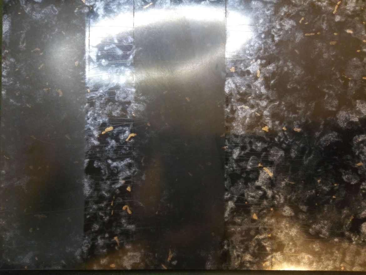

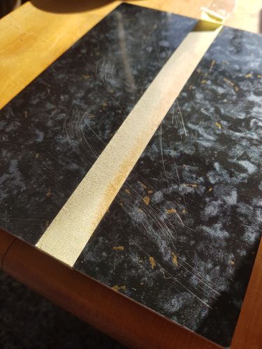

I have attached a photo - this is a kaboodle sample I bought and have been trialing different products to see which is the most effective.
I have slightly rubbed a nail file over the surface to replicate the damage to my actual benchtop.
I have tried Watson Hard Wax and Gillys Restoring Polish. Both of these would work perfectly if it was a wooden surface, but unfortunately made no difference to my sample piece 🙁
In case you were interested, @lisa847, I picked up the same sample to see if the scratches could be cut and polished out of it. Unfortunately, the iridescent particles and pattern are in the topmost layer. By the time I could cut out even the finest of scratches, I was already burning through the pattern. There was no chance of removing the deeper scratches at all. A straight polish without cutting compound made the scratches slightly less noticeable, but once again, the pattern was dulled considerably.
I didn't bother polishing the areas back up again after cutting them back as I could see that the pattern was actually gone and it was just black laminate.
I also tried several other experiments, like applying heat, but to no avail.

You know what did work quite well @lisa847? Clear tape. I wonder if you could cover the whole surface with Boyle 1.5m x 45cm Self Adhesive Film - Clear. Not only would it help disguise the scratches but it would provide protection as well. I'm not sure how glossy that film is though and it could be matt.
I believe the reason why the scratches are so noticeable is that they're diffusing the light and not reflecting it back like the surrounding area. You've likely noticed that the underlying material is black, so it's not so much that they're are a different colour. The tape evenly reflects the light back and disguises the scratched areas.
