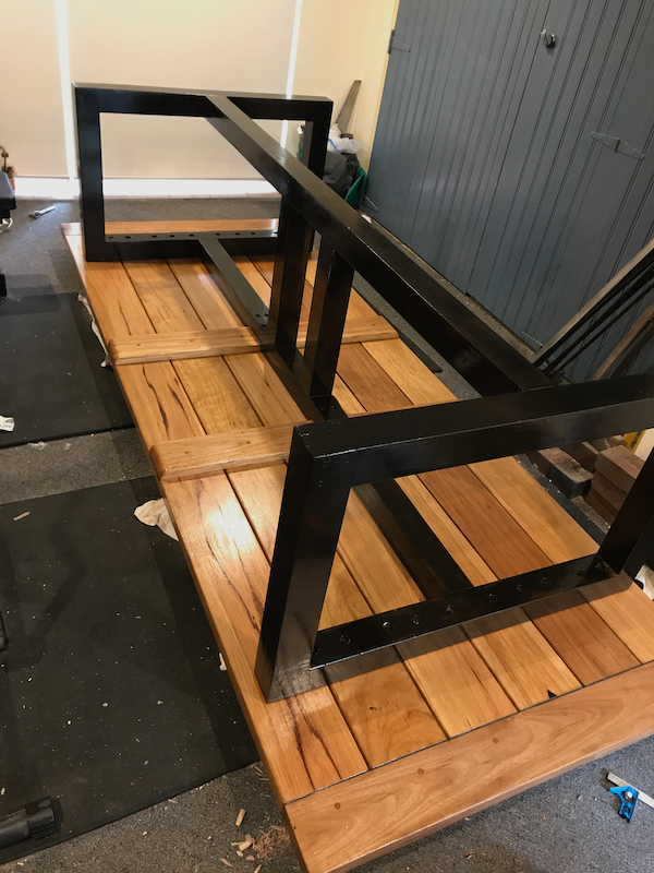

Dowel pinned bridle joints for legs
For the base it was just two coats of stain varnish to get it to the desired colour, then one coat of exterior clear varnish over top (sanding to 240 grit in between coats).
Ready for finish (stain varnish)
