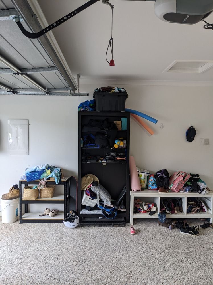

I’m the first to admit that I'm not a tidy person. Not even close. Normally my brain is so full and the day is so busy that I just dump things as I go and clean up at the end of the week.
My garage sees the worst of this because that’s my first port of call when I arrive home.

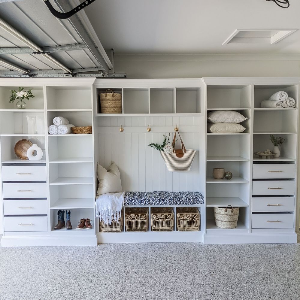

In the end the project only took three days from start to finish and the best part is that it looks amazing.

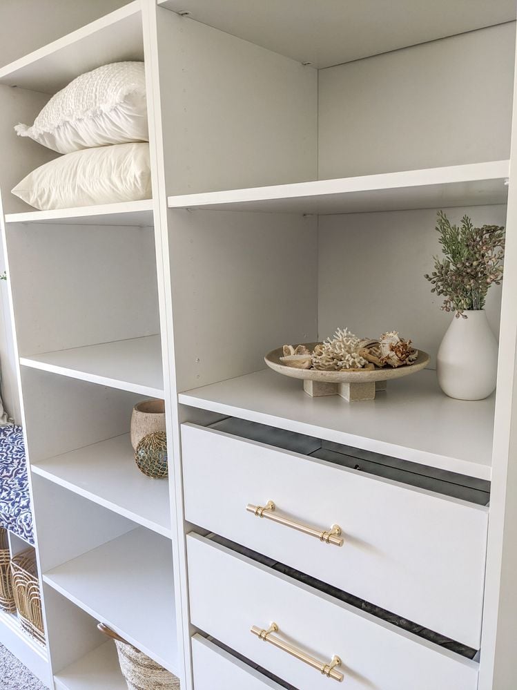

- 2 x Flexi Storage Walk-In Wardrobe four-drawer, three-shelf units

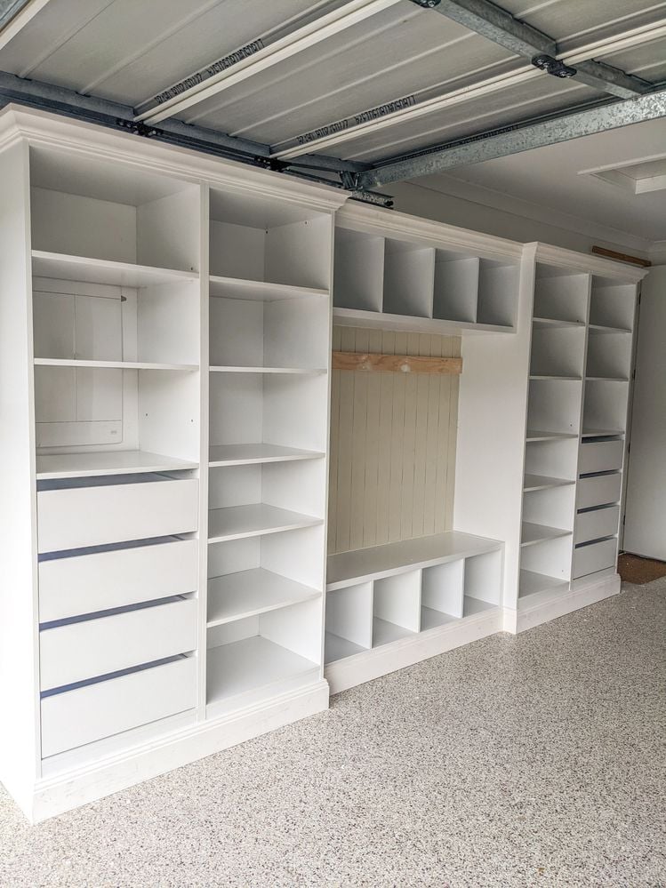

Measure your space. Make sure your cabinets will fit where you want them to – in particular under your garage door roller as this height can vary. The dimensions of this completed unit are: 400cm x 220cm x 54cm. You can omit some of the shelving if your space is smaller.
Step 2

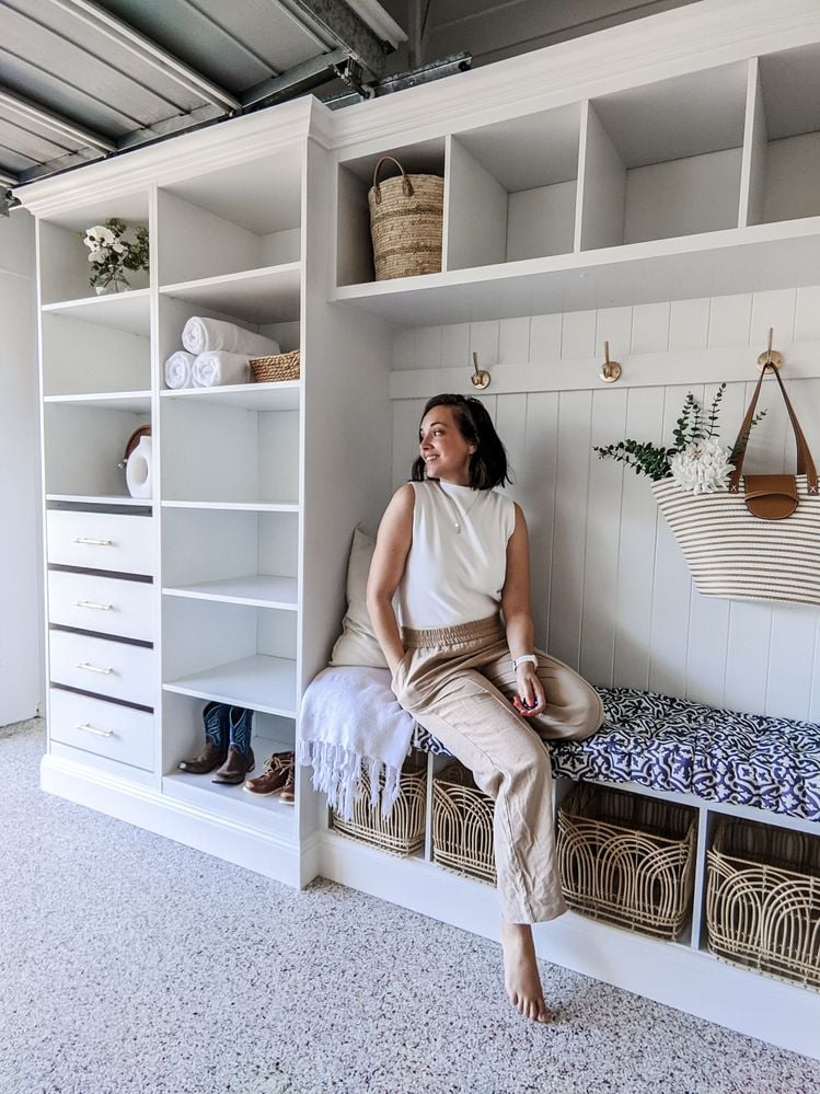

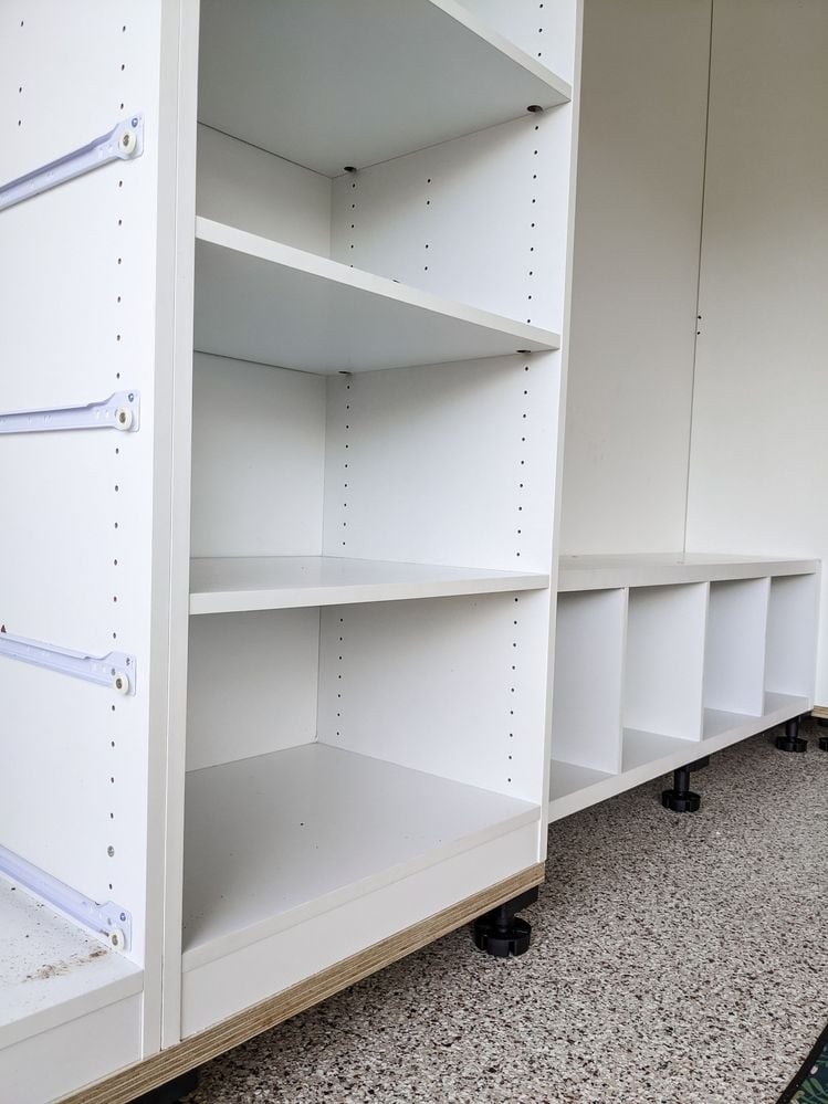

Assemble your Flexi Storage units and Clever Cubes. Once finished they should look something like this (the top cube unit isn't hung yet).
Step 3
Make plywood bases for the tall cabinets. I made one piece for each end (so two cabinets stood on each plywood plinth). Cut the ply to size using a circular saw if you have one or an old-school hand saw if you don't. Our dimensions were 122cm x 48cm.
Step 4
Screw adjustable legs to the bottom cube unit and the plywood bases. Then stand the cabinets on the bases.
Step 5
Anchor the cabinets to the wall using the wall anchors provided.
Step 6

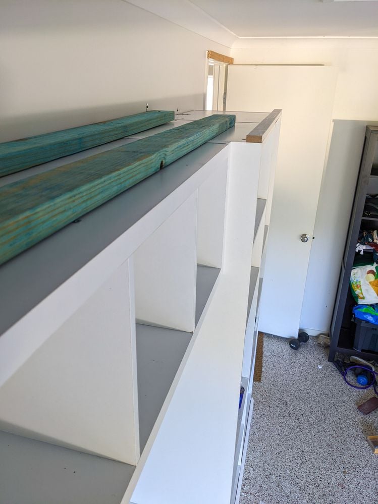

Attach two pieces of structural Pine to the top cube unit, leaving a long overhang on each side. Lift it into place and attach by screwing it into the tall cabinets. We also added some sideways screws for stability.
Step 7

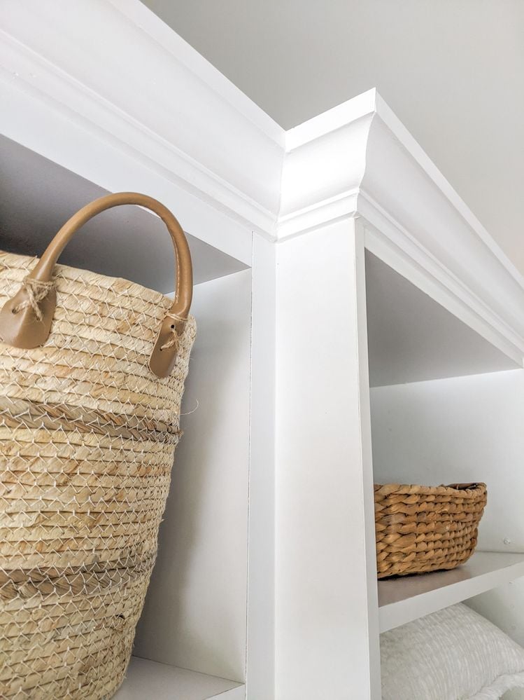

Begin cutting your skirting trim. Remember to mitre-cut the corners on a 45-degree angle to create a seamless look. Work slowly and remember the old saying "Measure twice, cut once." Nail the trim into place into the ply bases. Be sure to use a nail punch to hide those nail heads and make filling easier later.
Step 8
To attach the top cornice we first nailed some scrap pine to the top of the units so that we could easily attach the cornice to the pine with nails.
Step 9

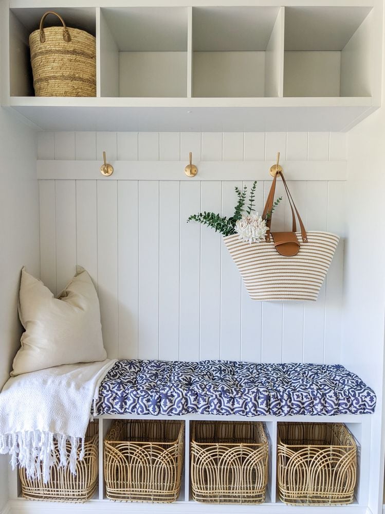

Cut your VJ panelling to size and nail or screw it to the wall. I added a piece of pine to this section to hang the hooks off. This is purely visual and if you don’t like it you can omit it.
Step 10
Fill, fill, fill! Holes from nails or screws can be filled with Spakfilla. Long gaps, such as the gap between trim and cabinet, should be filled with No More Gaps in a caulking gun. I also filled the adjustable shelf holes that run down the cabinets. Once dry, sand any excess filler until smooth.
Step 11
Paint the trim using Aquanamel in the colour Casper White Quarter. If you want to paint the whole unit a different colour remember you will need to prime the melamine shelving first or the paint will not stick.
Step 12
Attach handles and hooks and you’re done!
After completing this unit I stood back and realised this would make a great TV unit – just wall-mount a TV where the bench seat is. It could even be a home office – simply omit the bottom cube unit and add a desk. The options are endless.

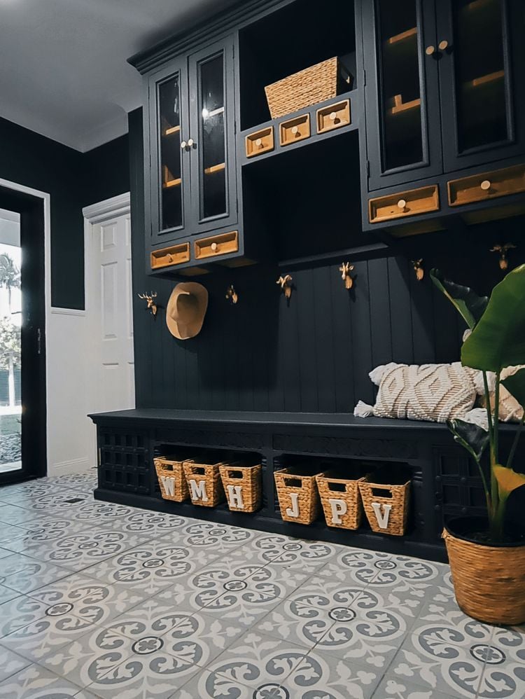

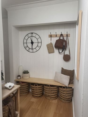

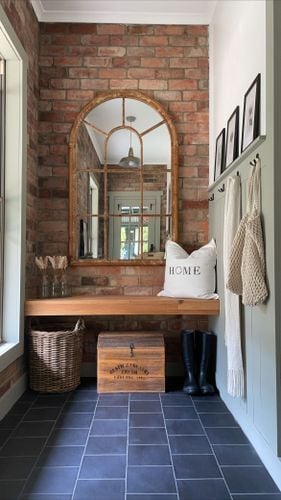

Farmhouse-style mud rooms make attractive, practical spaces for removing and storing dirty boots and shoes as well as coats, hats and other items.
Bunnings Workshop members have been extremely creative in creating mud rooms in their entryways, laundries and garages – especially when it comes to upcycling old cupboards, hutches and other pieces of furniture.
Workshop member marisamoloney turned an awkward, dated space into a stunning mudroom and laundry with plenty of storage.
Workshop member AngieLee created this striking entryway mud room.
Member housetohome turned a dim, bare enclosed area into a practical mud room with rustic style.
