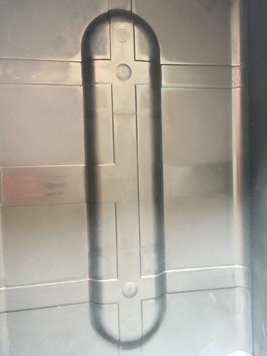

Hi. I have just purchased this raised garden bed - how do you stop potting mix from going down the overflow?

Hello @helen63
I see that you've got the Fountain Products 700 x 375 x 655mm Charcoal Raised Garden Bed. If you look inside the tub you'll notice the area where the legs clip onto are actually hollow. Those hollow portions of the tub are actually the overflow holes of the garden bed. the legs themselves are hollow and should allow water to pass through them. I've placed an image below to give you an idea of their location.
this is inside
