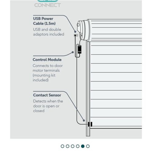

Now the magnetic contacts will be terminated in either 2 ways as per below depending on the door setup.

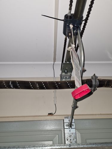

* One way is over head where the panel lift motor is centre and behind the panel
* The other is to the side and is as pictured below.
The contacts can be installed with the supplied double sided tape, I tend to use a dab of silicon as well or in this case went a bit nuts with liquid nails this just ensures the tape doesn't let go.

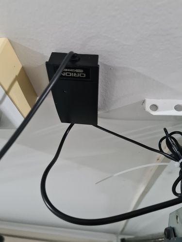

The controller fixedly with the supplied double sided tape and can be stuck to the side of the motor or roof, the USB plugs into the ceiling mount GPO with the power block and double sided adapter if required.

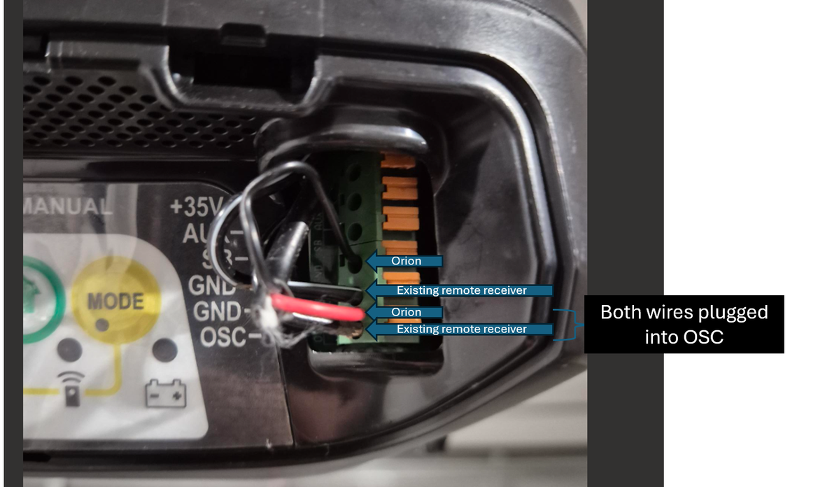

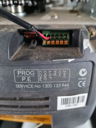

Now the other cable that has nothing on the end but bare wire it will be terminated into the motor control terminals. These are extra low voltage terminals 5 - 24 VDC depending on motor
Follow the instructions but Red will go into OSC (open shut close) and Black COM (common) unless stated in the instructions.

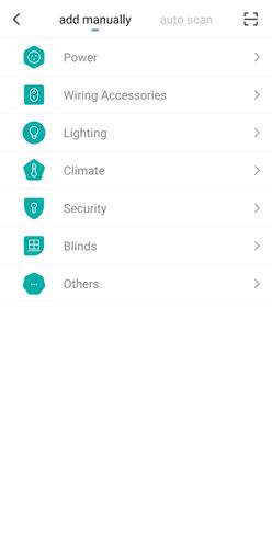

Now that everything is connected let's turn it on, the instructions will ask for yoi to open your Grid Connect App and then hold down then button on the garage controller for 5 sec. Click on the + symbol and then Other the device will show up and step through to add it.

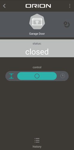

Once it is setup it will open the device and you can click on the button open / close give it a try....

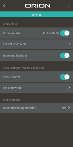

Now click on the settings icon top right hand side.
Now have a look at the 2 first options I have set both of these to 10 min this is the alert when it is left open.
The 3rd Open notification I have on as well.
The 4th the voice control is so you can open it via Google Home voice on your phone or your car a pin code must be set for this but if you don't want a pin then follow my tutorial here.

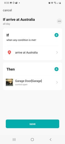

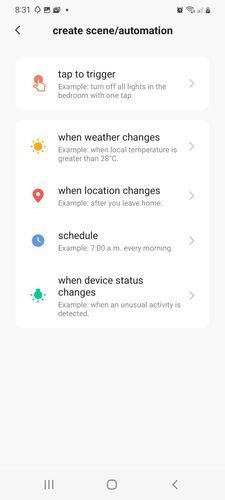

If you would like to set up Geofencing to open the garage or gate then you.
* Create a new scene
* Click when location changes
* Click when arriving
* Set your home pin
* Then condition click the garage or gate control and select open.
* Click save.
The same can be done for close on leaving.
