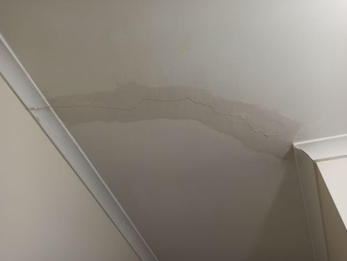

Hi all, l have tried patching up this crack twice with tape and multiple layers of putty but it keeps coming back slowly. What's the best way to fix it? Much appreciated your help.

If the crack on your ceiling keeps coming back, it is an indication that somewhere along your ceiling structure expansion is occurring. In these conditions even if you re-plaster the area the crack will return because of the expansion. In order to prevent your ceiling from developing further cracks, an expansion joint must be installed by a plastering professional.
Installing the expansion joint requires knowledge and experience in using the product. I don't recommend it as a D.I.Y. project. I propose engaging the services of a plastering professional to properly install the expansion joints for you.

Is this a single story building or is there a floor above this?
Reason I ask this is because it could be caused by a broken roof truss chord in the roof above this area.
Personally, I would get a qualified builder to have a look at this, as there seems to be some abnormal movement going on here.
Patching this up isn't going to solve any underlying issue above the ceiling.

It's a single storey building. I am not sure should I get a builder to look at or should I get a professional plaster to do it!? But I am thinking it's better to have a look above it.

Getting an experienced builder is sometimes better as they might have the skill to do plastering as well.
The only reason I suggested a builder is because, seems this crack has come back a second time after it having been repaired, suggests there is structural movement apparent.
A ceiling should not crack just because it does, there seems to be some sort of lateral force that is causing this to happen.
I would personally get this looked at sooner rather than later, I'm not trying to scare you at all, but small cracks are easier to remedy than large ones.
