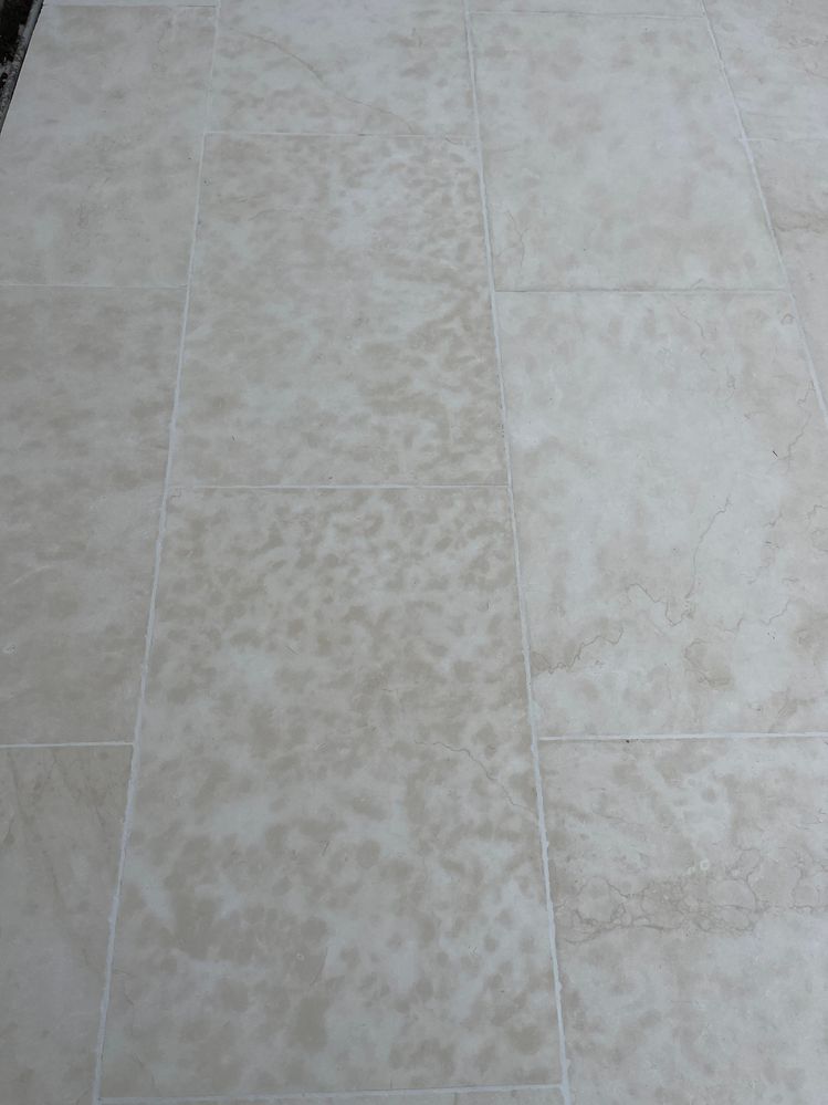

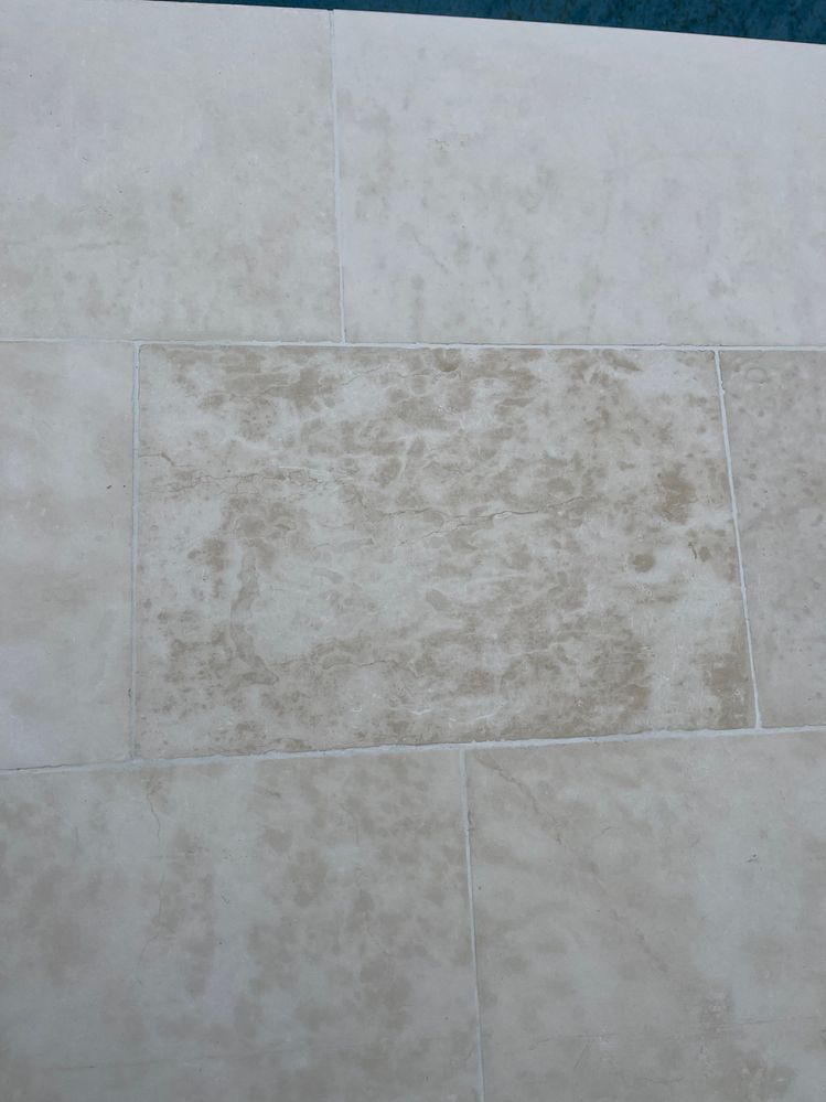

We have these beautiful lime stone pavers for our new pool. Unfortunately the person who came to clean and seal used acid cleaner. Now our brand new lime stone has reacted and is not looking good. Any suggestion to get it back in the original state.

Thanks for those images. This mottled effect could be moisture trapped in the pavers that now can't escape due to the sealer. How long after the tiles were cleaned before the sealer was applied? Before the sealer was applied, was a moisture check done on the pavers? This would have involved a piece of black plastic being taped down on a paver for two hours to see if moisture was drawn out. If these tiles are adhered to a concrete slab, do you know if a membrane was applied over the slab before installing the pavers? Did they use Crommelin 1L DiamondCoat Clean N Prep after the acid clean?
If this moisture is only present due to the pavers being damp when the sealer was applied, then you need to open up the pores and let them dry out. This would involve scrubbing down the area with Crommelin 1L DiamondCoat Clean N Prep and then waiting for this discolouration to resolve itself. You can then re-coat the site again to seal it. However, if this moisture is travelling up from a concrete slab, then the issue would be harder to resolve.
It's essential to ensure the pavers are fully dry before coating, and the required check must be done to ensure moisture is not trapped. You would need to wait several days after rain or cleaning for the pavers to dry out and pass the moisture test.
