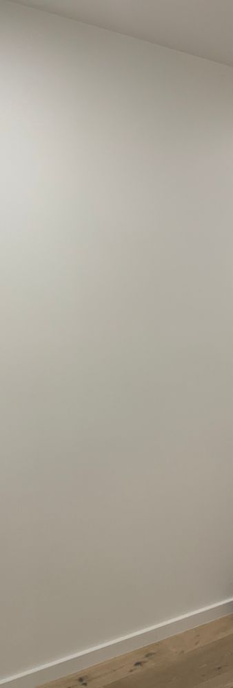

Hi I would like to install Laminex Surround or similar from the floor to ceiling. We have square set ceilings 2.7m. I am wanting to know is it best to remove the skirting board (and not replace) or install above the skirting board? Thanks

Check out the D.I.Y. Advice videos for installing Surround by Laminex on the Bunnings website. Last step is to install skirting boards on top of the Surround boards. So in your case you'd need to remove the skirting board and then replace it.
