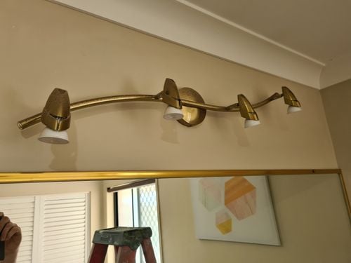

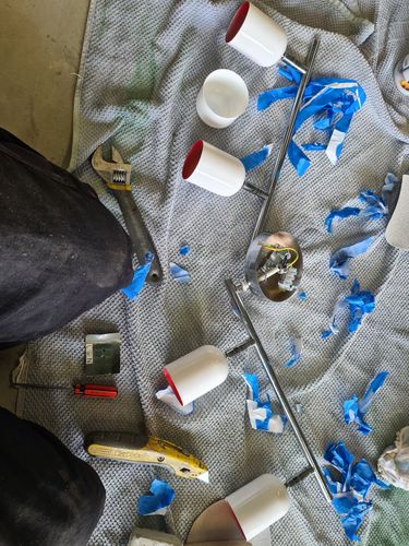

I had this ceiling light mounted in the kitchen that I replaced with smart downlights and I have been looking for a replacement wall light for the ensuite for some time so I decided to revamp this one and install into the ensuite.

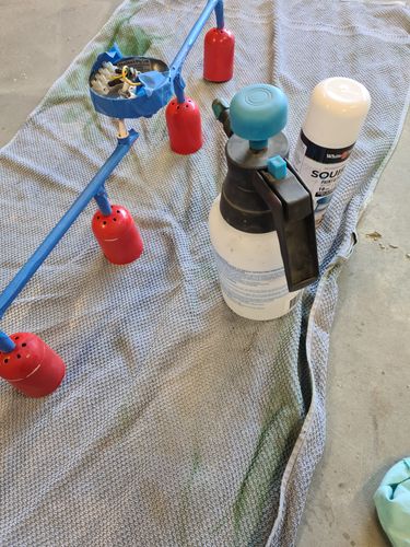

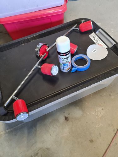

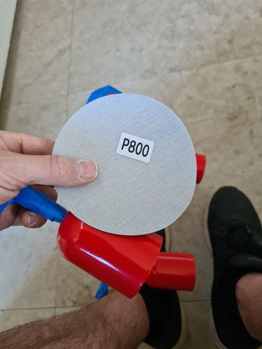

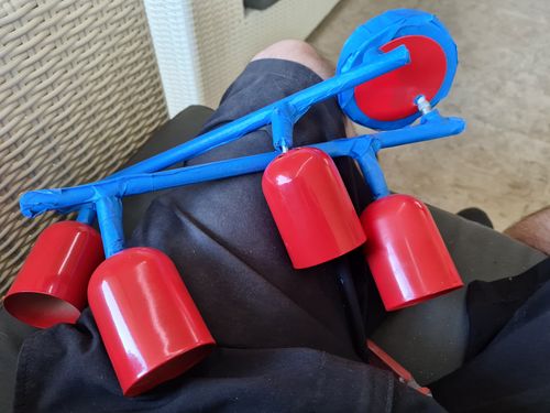

I basically pulled it apart, sanded all the red paint parts, taped up all the chrome parts, painted the sanded red parts white and then put it all back together.
What I will say I wasn't to overly impressed with this paint I found it a bit thin and caused runs even with light coats I usually use rustoleum and I cheaped out.

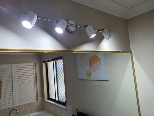

The process took me around 3 days due to waiting for coats to cure enough due to paint but I am happy with results.
