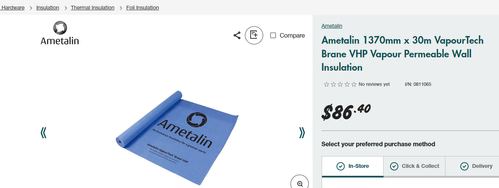

Hi @Bondy2 I agree with @EricL, you could use, I have used this product before on weatherboards, with the earthwool batts
Thanks Joe, I will use that product (when it stops raining). Just one question...As high temperatures here in Wagga are a problem, should I put that Ametalin sheet with the silver side facing outwards?? Facing the steel corrugations.
Hi @Bondy2,
Just so you're aware, the Ametalin 1370mm x 30m VapourTech Brane VHP Vapour Permeable Wall Insulation is a permeable vapour barrier and does not include a silver face but does have a correct directional facing. You'll find "This side facing out" printed on the product.
The benefit to this product over a traditional silver-back sarking, is through the use of VapourTech®Brane® technology or potentially black magic, water vapour can travel through the insulation to the outside, but the water outside can't travel inside. This helps prevent the build-up of condensation within the structure as very high levels of water vapour are allowed to absorb and diffuse through the core non-woven structure. Silver-backed insulations are vapour impermeable and won't assist in dissipating any internal levels of trapped water vapour, which can become a huge problem inside a small insulated steel box.
