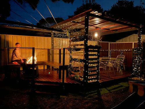

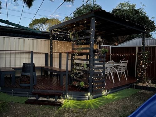

Here is a basic DIY gazebo and deck for an outdoor dining space with a small fire pit area that I put together during lockdown 2.0 last year. A great way to renovate a little space in the backyard.

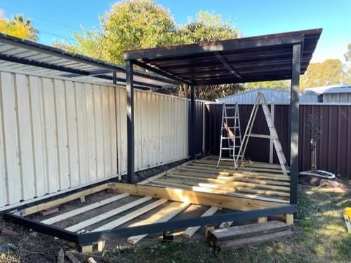

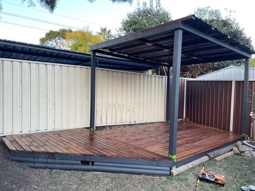

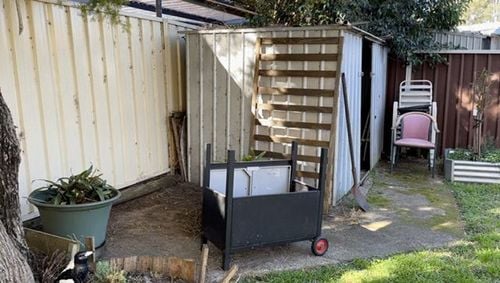

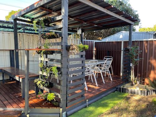

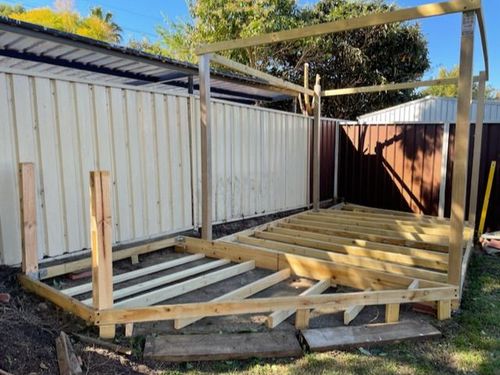

I started by relocating an old shed that was mostly holding junk, giving me access to an almost flat concrete slab to fix some 90x90x2400 treated pine posts too. The frame is a very simple butt jointed rectangle with 90x35 MGP10 pine and I used 90x22 treated pine decking boards. For the roof I used 10 colorbond fencing inserts in Monument and colour matched some exterior paint which I used on the framing. The decking boards and seats got 3 coats of walnut stain.

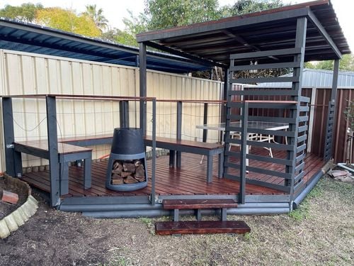

The fire pit area sits a little higher than the dining space, which was dictated only by the uneven slope of the slab. I used a piece of 190x35 MGP10 as base board at the end of the dining area to create the raised platform look, which I’m actually happy that it went that way as it makes it look more like two segregated areas. Although this did mean I had to make some makeshift stairs from some old sleepers I had lying around, which I coated in stain after a thorough sanding. The fire pit is a Jumbuck conical fire pit also from Bunnings, which fit the small space perfectly and the colour also matched the frame.
I added some wire balustrade around the whole area to further divide the two spaces and to stop my nephew from getting into mischief.

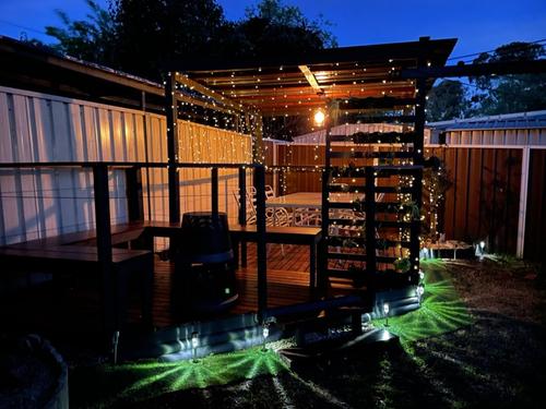

Finally I painted some old timber bed frames and fixed them vertically to create some vertical gardens using mostly succulents as it is a difficult spot to water. I also used some fairy lights and wired in a single light over the dining area to make it a nice little spot at night.
