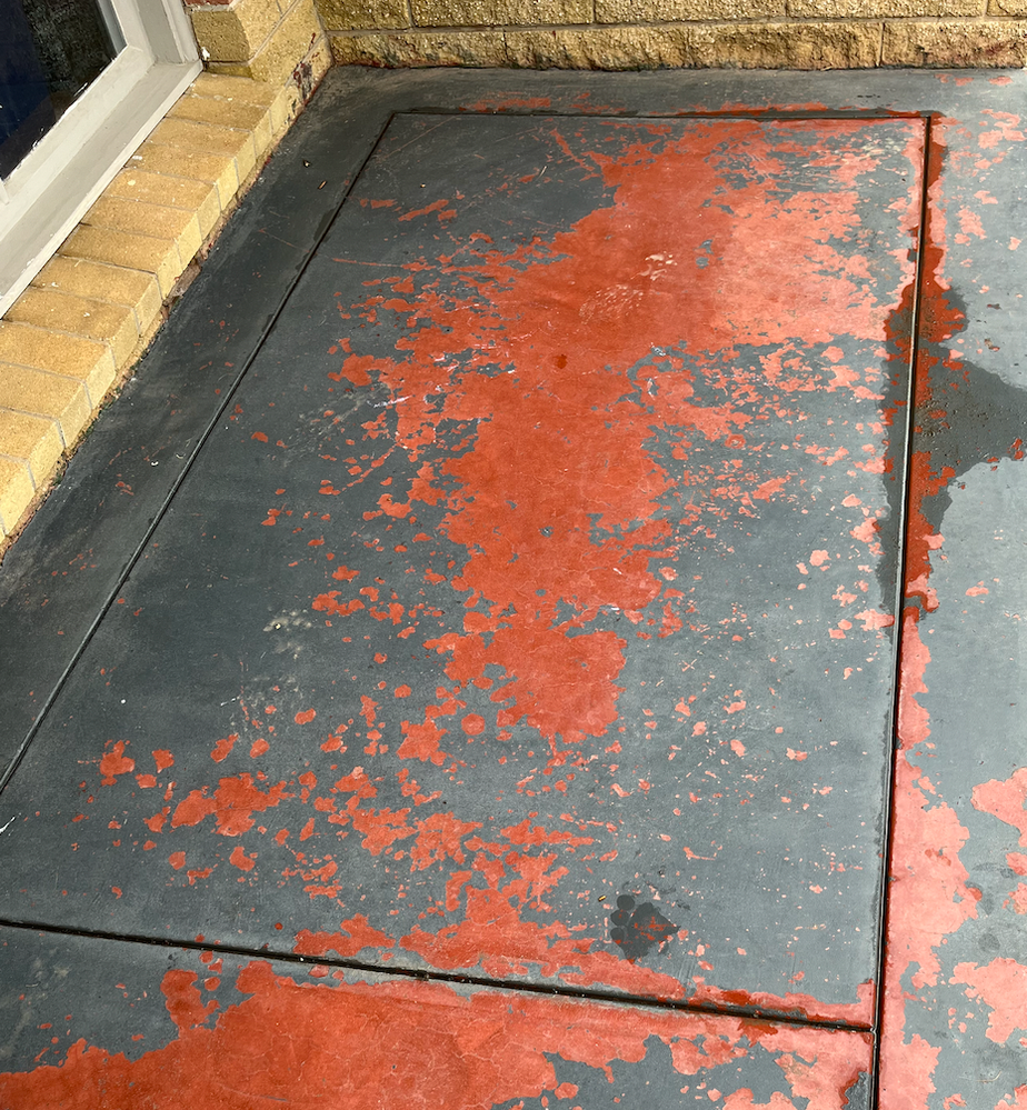

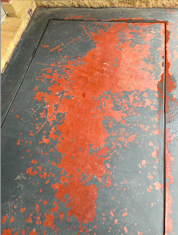

Yes, I will take some pictures this evening and will update here.

Ignore the water. I washed it to clear the dirt.
Hi @krishna,
Concrete paint is designed to be applied over prepared concrete, or it can be applied over previous paint if it is not compromised. Your grey paint coating is compromised by peeling and flaking. It is not a suitable surface to paint over. Unfortunately, the brown surface (paint?) also appears not to be a suitable surface to paint over, as the grey paint obviously hasn't been able to adhere correctly. So, it's a bit of a double-edged sword, you can't paint over what's there, and even if you removed the grey paint, the brown paint doesn't appear to be a suitable substrate either.
Unless you are prepared to grind all the paint back to bare concrete, which would be a reasonably intensive process, I recommend you take a scraper and chip away any loose grey paint. You might like to give the whole surface a light sand with 180-grit sand before coating it with your new paint. Remember to wear a dust mask and protective eyewear. This should be seen as a temporary solution. The new topcoat will only ever be as strong as the compromised substrate. However, if you're lucky, you might see several years of life out of it.
