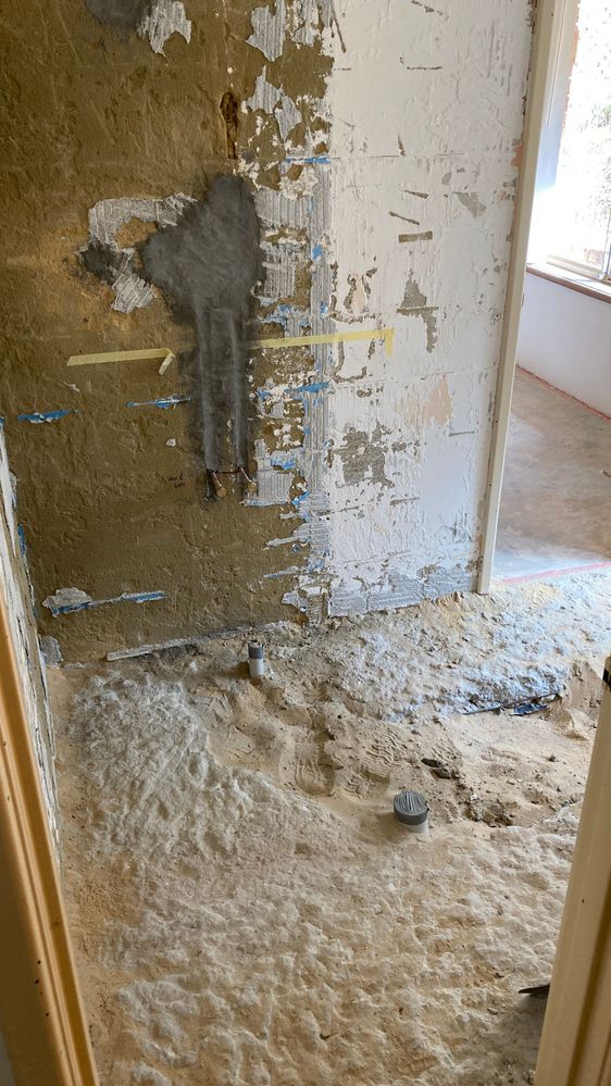

I'm hoping for some advice on the scale of floor demolition/restoration we have to embark on. Basically - if I am expecting to have to re-screed for different falls across the whole floor, does that mean I have to chip out all the existing floor back to the concrete? In addition, because I have to remove some of the concrete to get new drain pipes laid, how do I restore the concrete in those parts afterward?

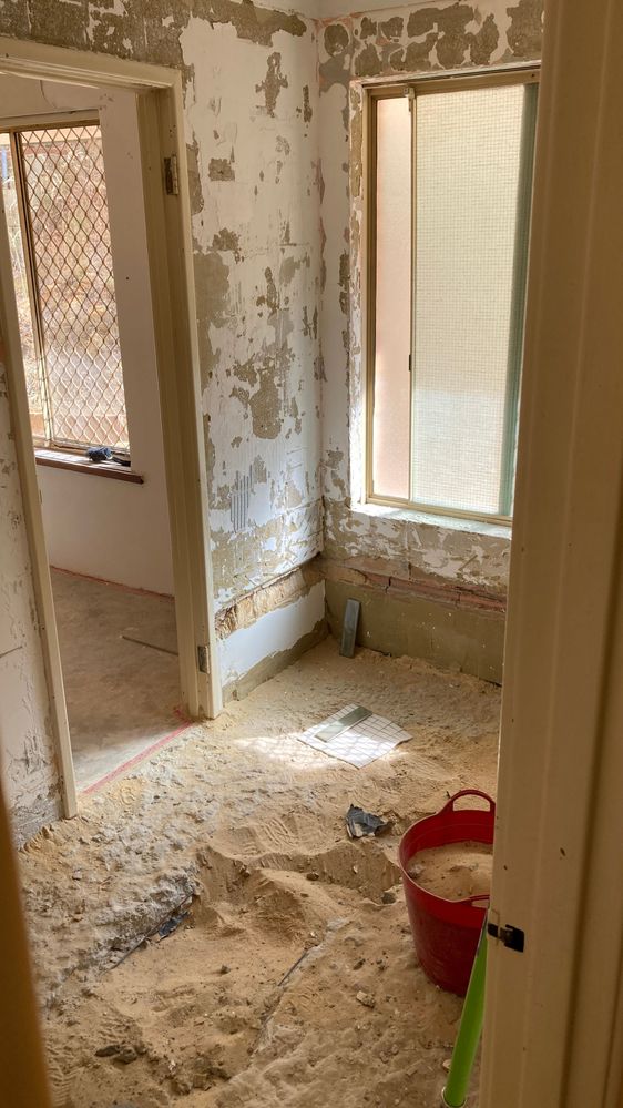

We have made good progress demolishing the bathroom we are renovating. The bath, vanity and shower hob are out. As per our other posts, we are rearranging the bathroom so that the shower is where the bath was and the vanity is where the shower was, and there will be no bath. I am still deciding on how the fall should go, but obviously a good portion of the room needs the fall changed, if not all.

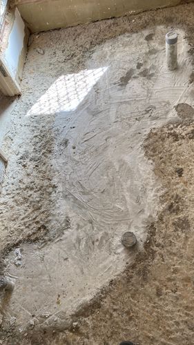

The plumber has advised how he will need to alter the drainage and has said we can save money on his labour by removing a line of concrete so he can lay the new drainage pipes (basically, a line of concrete to be removed from near the corner diagonally opposite this one, to this one). So now I have to get a grasp on the scale of what to remove next, what extent to go to, and then how to restore it so it can be screeded and tiled on etc.

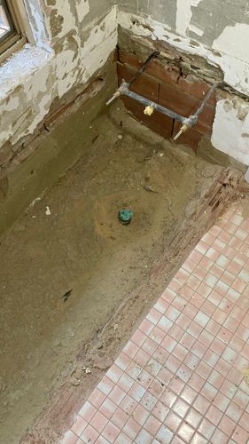

The picture below is where the bath was, basically now where the shower will go, showing the concrete, sand below that, the broken brick bath hob, and the tiled edge of the rest of the floor.
Previous bath location showing concrete slab and floor tiles to right
