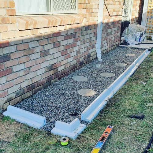

Short post (due to lack of photos) - One of the first outdoor projects my wife & I did. The area underneath our eaves were mostly dirt and would sometimes be muddy when we were hanging things out to dry or bringing them in. We travelled to Bunnings to get our materials and came back and completed this the same day:
Step 1 - Dig out the area, ensure there is no grass of weeds.
Step 2 - Place weed matt down, we cut it around the drain hole.
Step 3 - Mix a small amount of concrete and place that around the edges, and where the circle step stones are going, the garden edging and step stones are then placed on top.
Step 4 - Place Sand on top of the dirt area.
Step 5 - Place pebbels over the top of Sand.
The area has still held up two years later and makes life easier especially during our QLD weather events (no more dirt feet!), our dogs also hate walking on the stones so there's never any poop or pee under it now, so that's a plus 😅.
