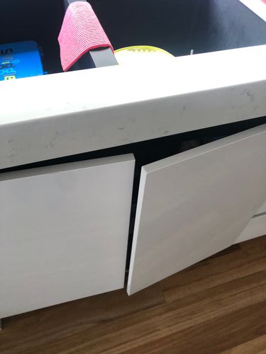

my soft close door wont close. i have hettich hinges. they start to close then stop before it's fully closed.
is there anyway to adjust the closing speed of the hinge?

See attached photos. The door doesn’t close all the way. I need to push it to close completely
Thank you for posting those photos of the hinges and your door. Have you made any attempt to adjust the screws that are on the hinge itself? You'll notice that on the hinge assembly there is a Philips screw head at the very back of the hinge. This controls the forward and backwards position of the body of the hinge.
Your goal is to move the hinge far enough forward so that there is a gap between the body of the cabinet and the door. If the door is too close, it catches on the leading edge of the cabinet and prevents it from properly closing. You'll need to adjust both hinges on the side of the door.
However, if after the adjustments the hinges still refuse to close the door properly, it is quite probable that they need replacing. I've placed an image below to give you an idea of how to adjust the hinge.
As there are no handles on the cupboard doors I presume they have push to open mechanisms ?
Therefore when the soft close hinge finishes its travel it will come to rest on the push to open mechanism, the door then needs a push to be fully closed.
I have found that push to open mechs do not work well with soft close hinges.
Hope this is helpful
