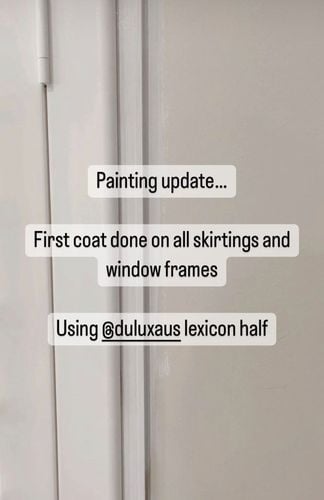

Once the walls were cleaned, I started by repainting all the window frames and skirtings using Dulux aquanamel in lexicon half (gloss).

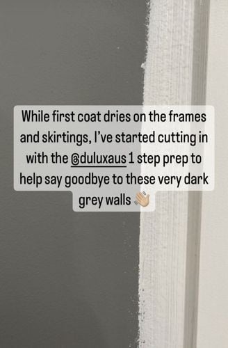

I then started cutting in on the walls using a brush. I painted the walls with Dulux 1step prep to help conceal the very dark grey.

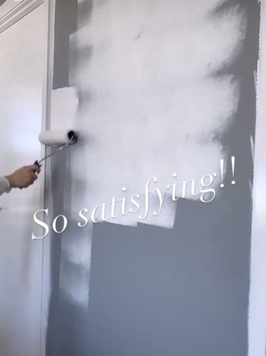

And coated the rest of the walls using a roller and the 1Step prep paint.
Step 6
I then did two full coats on the walls using Dulux Wash & Wear low sheen in colour Lexicon half.

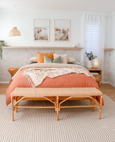

I wanted to create a feature wall behind our bed and decided to try creating a half wall, wall paper feature. I used a string line to mark out the wall to ensure the line was straight. Once the line was straight, I installed the wall paper and used the stanley blade to cut off any excess at the bottom.

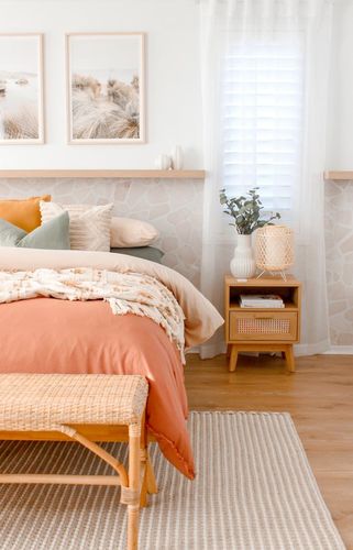

I also installed a floating shelf on the feature wall. I installed the shelf where the wall paper joined the painted wall so it acted as a divider separating the two areas. Installing the floating shelf was quite easy and looks great.
Step 12
I then finished off the flooring by installing white scotia flooring trim.
Step 13
I finished off by installing two picture frames above the floating shelf and assembling a new bed and bedside tables. I purchased the rattan bedside and the rattan bench from Bunnings along with the Cortina rug.

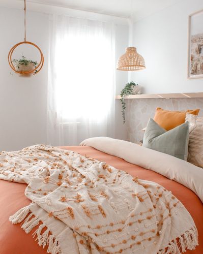

I installed an electrical free pendant light (used Puc lights instead) and a hanging plant, styled the room with all the finishing touches, bedding and accessories.
We love our new room and so happy with the end result!
