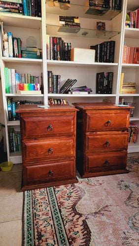

I bought these side tables from my local thrift store for $15 each.

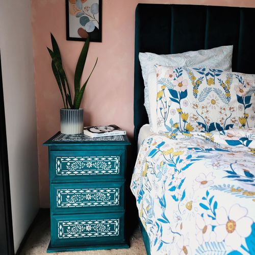

The first thing I did was to clean and sand the tables. Once that was done, I prepped them with the Benjamin Moore Stix Primer. I let it cure overnight and then went in with dulux paint in the shade Turkish Aqua. I ended up doing 2 coats. They gave ample coverage.
Once that was dry, I used a stencil in bone inlay design and used a small paint roller to stencil the design.
Sealed it with a coat of clear varnish and added new knobs.
I'm quite happy with the end result.
