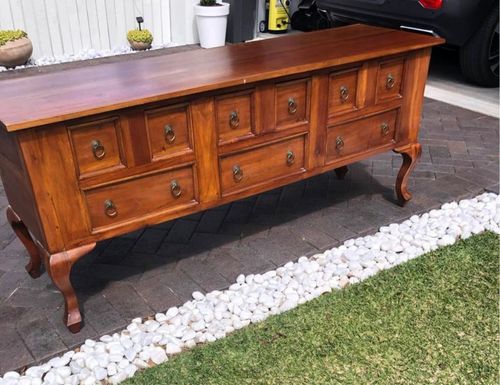

Although the beautiful wood was too dark and a little too pink/red for my vision.
I had visions of a light wood cabinet, almost a driftwood look. I wasn’t going to achieve that by staining, so I opted to bleach the wood.

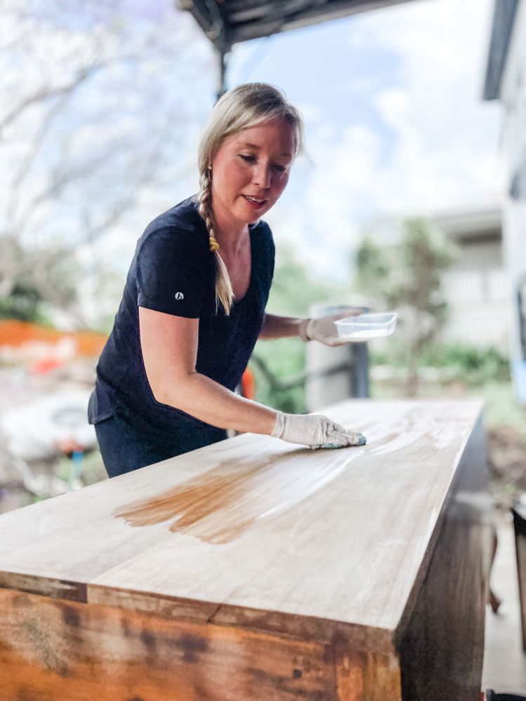

I found one option: mix 1 part bleach with two parts laundry detergent. This very wet, frothy solution left the wood with drip marks. - I would not recommend using this method.

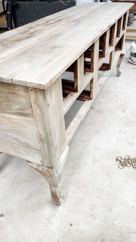

My second attempt was to use bleach on a cloth. I used a small amount and treated it like a stain, rubbing it onto the wood and wiping it off with a dry cloth. I repeated this process twice until I got the desired look.
