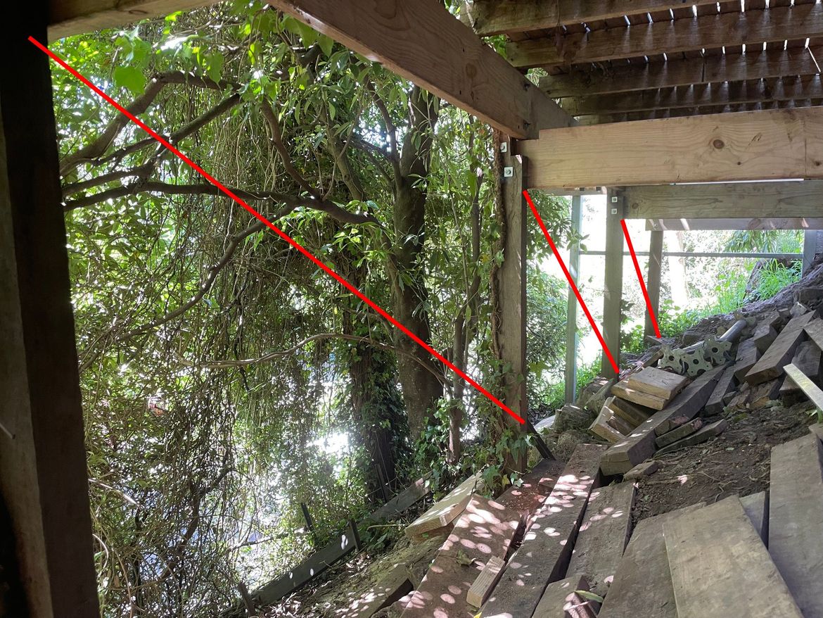

Hi all, I have an old deck that I have recently done some repair works to, to replace some bad timber and get it all levelled. One thing I have noticed is the posts do not have any cross bracing, and some have developed a sidewards lean over the years due to a tree that has pulled the deck with it. I was thinking of using some galvanised punched strapping to help further brace it. I'm not sure if this is the right product though?
The deck is on a slopped block, so one row of posts are about 1.5m, while the other row are about 400mm. I want to brace the taller posts as shown with the red lines. I would be interested to hear others feedback on the right material to use for cross bracing.
