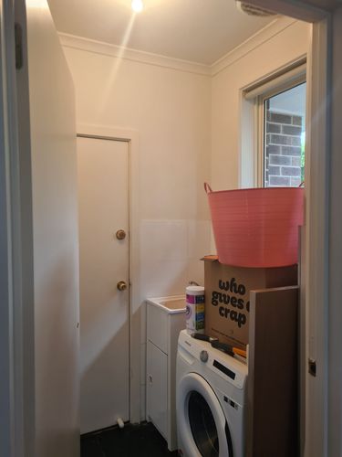

This is the before which wasn't great!

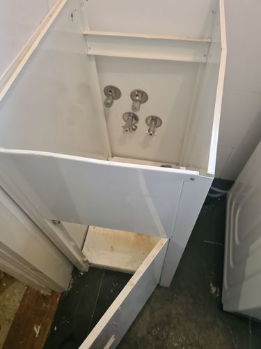

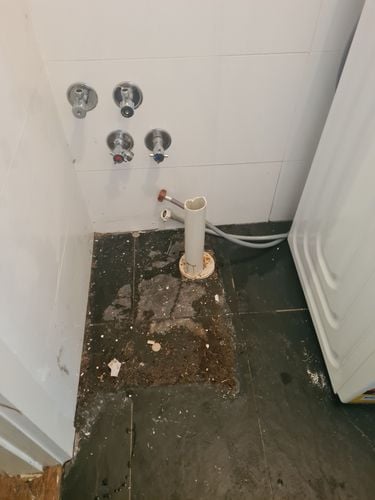

I switched off the water and disconnected the sink and then removed the old laundry tub.
I then after cleaning replaced this with a 600mm Kaboodle base cabinet with cut outs with a hole saw and jigsaw for the taps, drain pipe and washing machine taps and hose.

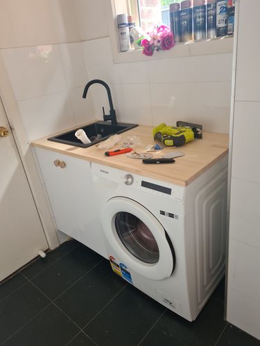

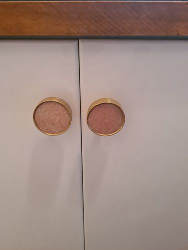

Next cut a pine FJ laminate panel from Bunnings to size for the benchtop - its quite a narrow space and I didn't want the benchtop the whole way across so that I could fit the clothes rack in at the end. Added in the Kaboodle doors (modern white) and some cute door handles from Bunnings.
Once I cut the hole for the sink I thought the pine colour was a bit too light and likely to get quite dirty so decided to stain this.

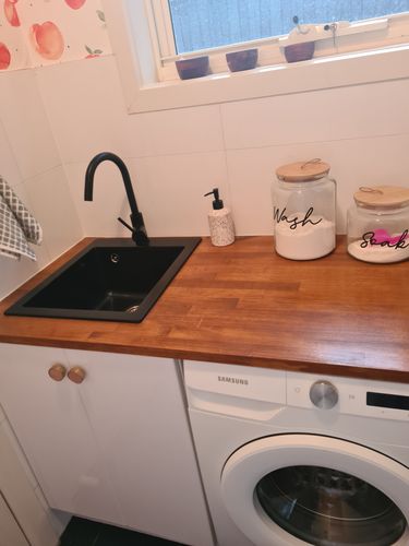

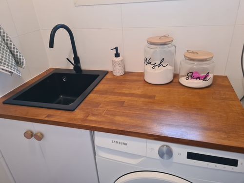

I stained the benchtop with Cabot's water based Mahogony stain for a much darker richer colour and added two coats of clear varnish and then added this to the Kaboodle base cabinet and the tile behind the washing machine with 90 degree angle brackets before sealing the sink and benchtop with silicone.

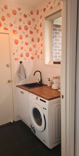

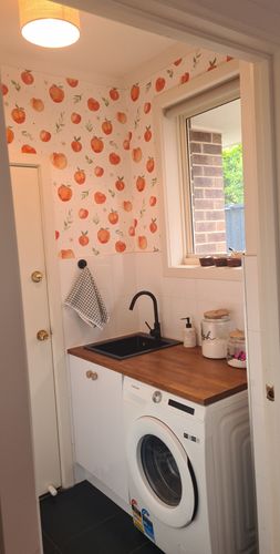

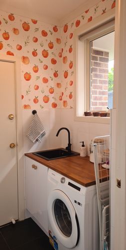

I then connected the sink, added a kickboard and then wall papered in a beautiful bright peach print and freshened up the paint on the door and window frame.
Some finishing touches with a bunnings lampshade, kmart laundry containers, towel and big W towel holder and all done.
This is the end product ☺
