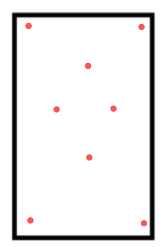

Our current dinning table is 2100x1050x790mm. We want to make a makeshift table to add to this (and using tablecloth) to create the illusion of one long seamless table.

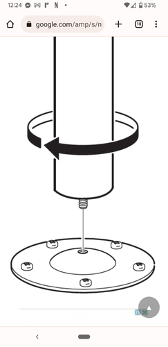

We've got EIGHT IKEA olov adjustable legs that will adjust to the required height. Our plan was to buy a 2400x1200x25mm non-structural CD plywood and get it cut down to 2000x1050.
We'll fasten the leg plates into the tabletop and then screw the 8 legs to them. We intend to arrange the legs on the diagram shown.
This table would only be used for a few hours and then dismantled until the next family gathering. The legs will unscrew from the plate and get stored in the cupboard and the tabletop would be stored under the king single bed.
We've never used plywood before so we're not sure if it's strong enough. If there will be too much flex in a piece that large.
Has anyone created a large table using 25mm thick plywood? Is it strong enough? Is 8 legs supportive enough in the way we plan to place them?
Any advice or help will be great.
NB the plywood will purely be a flat tabletop, we don't plan to add any additional support (such as braces)
