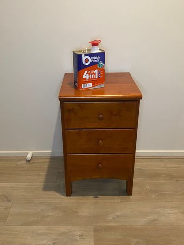

i had a bedside table that needed some loving, following are the steps I took ;
1. Cleaned the bed side table using sugar soap.
2. Light sand all over using block sand paper in 180. Grit

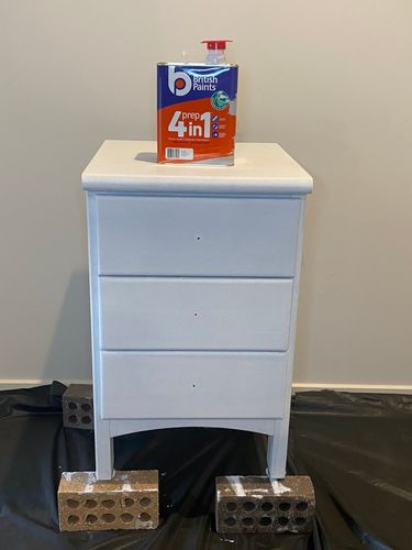

3. applied 2 coats of prep 4 in 1 by British Paints , allowing drying time in between.

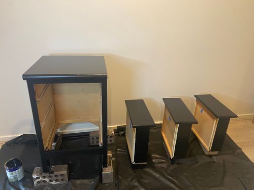

4. Decided on the colour BLACK ACE in a H20 semi gloss enamel ( British Paints )
I applied 2 coats with drying time in between.

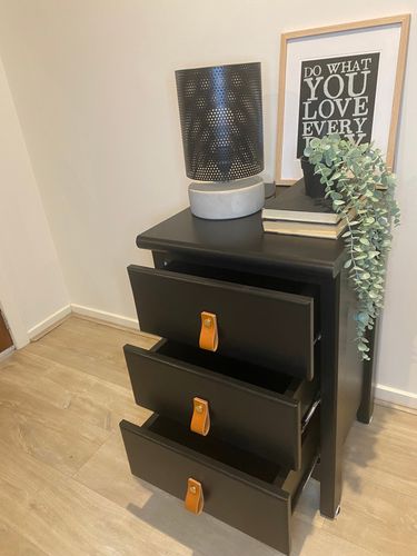

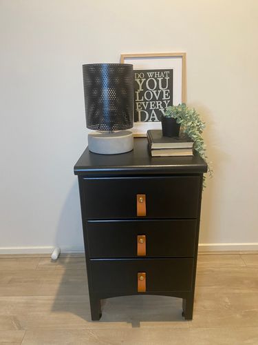

5. Then lastly I applied the hardware to the bedside table .
A great upcycle that suits my 18 year old sons room perfectly .
