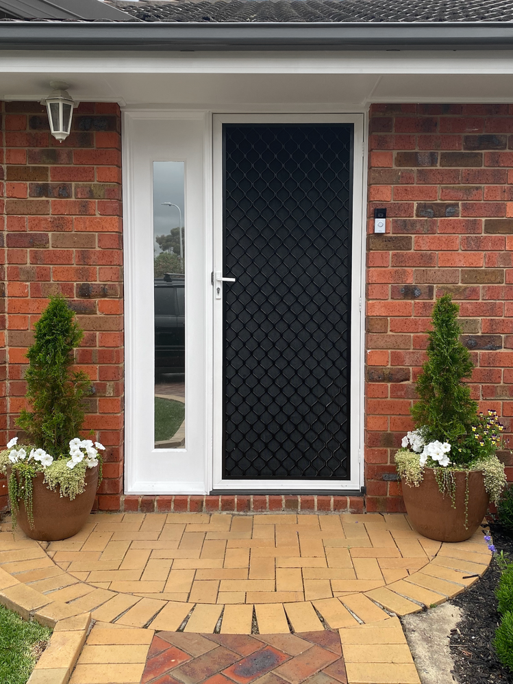

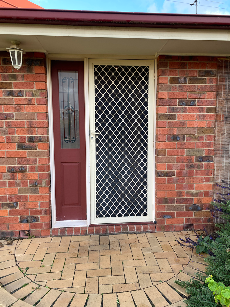

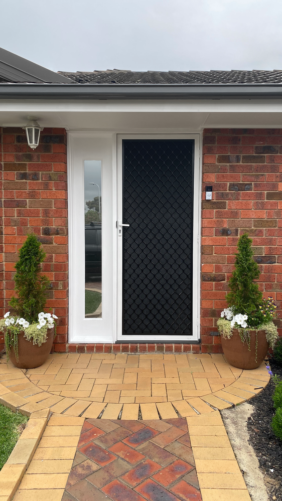

We originally planned on replacing the cream-coloured screen door for a new security door that didn't have the diamond grille. The screen door worked perfectly fine and it seemed like a waste to replace it just for aesthetic reasons. Instead, we decided to paint the diamond grille section black to give it a less-dated look.
All up, the project cost around $100 as opposed to replacing it for a brand new door around $1000.

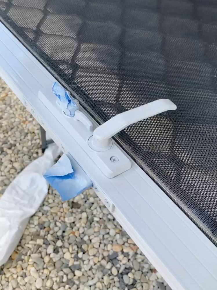

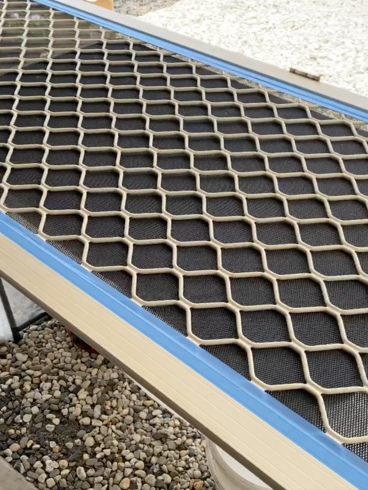

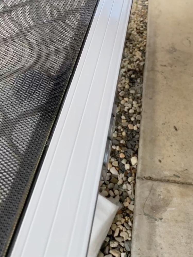

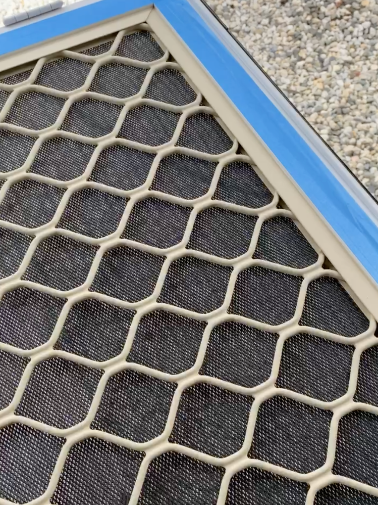

2. We started with the back side of the door and taped off the mesh area. We then sprayed on the gloss white enamel spray paint onto the door frame. Once it was touch-dry, we turned the door over and repeat the same step on the front side.
3. Repeat step 2 on both sides after the first coat has dried.

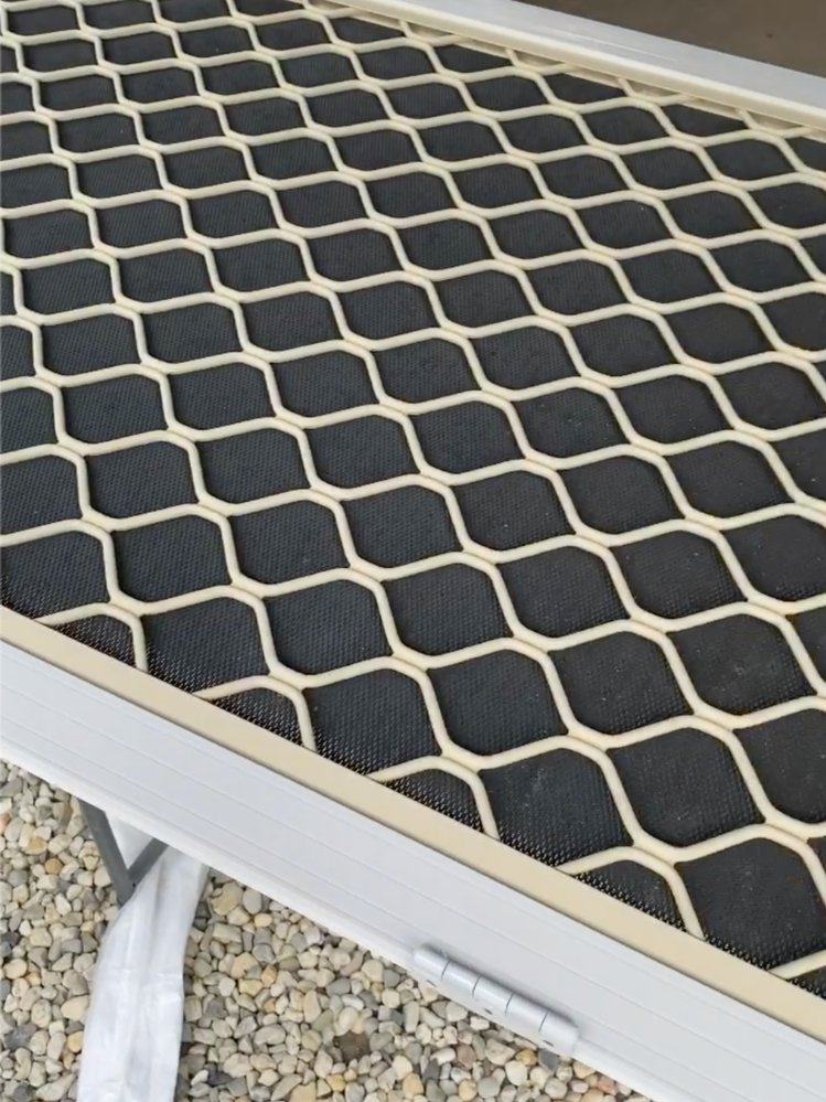

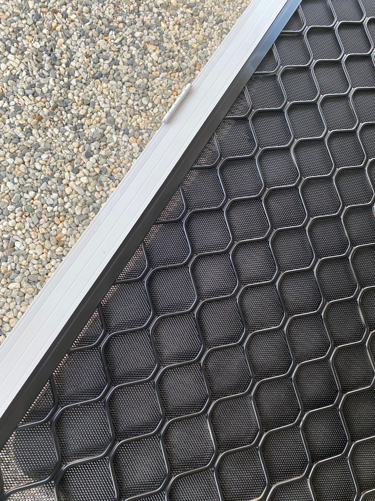

4. Once the newly painted white screen frame has dried and cured, tape up the screen frame and paint the diamond grille and security mesh. This part is a little more time consuming because of all the angles you have to spray the diamond grille at.
