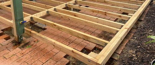

Hi All 👋🏼
Looking for advise on a new deck installation please. Looking at Span tables and forums is leading to conflicting info.
Current POA below:
Deck dimensions 4650mm x 3600mm
Currently 200mm from brick pavers to door lip (no step)
Deck bearers 90 x 45 MP10 (4650 length)
1800mm spacing
Joists 90 x 45 MP10 (hangers need to be used due to clearance)
450mm spacing
Posts 90 x 90
Notched for bearers
1800mm spacing
Concrete Set at 600mm depth
Questions:
1. Are above materials and spacings sufficient ?
2. The bearers run perpendicular to the house away from the sliding door, how do these get secured on the house side. Holes for posts will probably be difficult with concrete foundations at the extremity ? Can beefed up hangers be used on the house brickwork ?
3. The deck will run slightly out of square (4650mm vs 4850mm) on the leading edge away from the house, will this be an issue ?
Many thanks in advance 🙏🏻
Picture of very similar plan below
