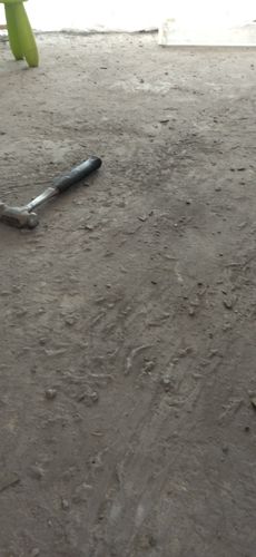

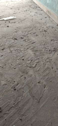

1. Some minor adhesive still on the concrete slab. I try to use my tiny Bosch grinder with diamond grinding concrete cup wheel. But it will take a lots of time to finish it. Any commercial grinder machine for rent in Bunnings to let the job done quickly?
2. After removed all the adhesive, there are some patch need to repair. See the pictures there is some dent on the floor. How to repair the dent. Is that fixed by floor leveler? Actually I just want to fix the dent. I dont want to level the floor to much.( It is 45 m2 big areas to level.) Or can I just let it go, put laminated flooring underlay straight away on the concrete slab?
