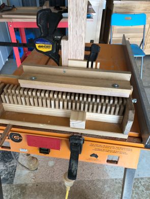

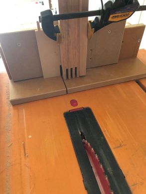

First of all I had to make a box cutting jig for may table say, I need the depth of the saw blade, for the joints, I then made a router planing jig to hold the base of the timber, Tas oak panel 18mm thick reduced to 9mm thick leaving the side to original height to allow for more gluing area for the side of the tray.
Box Joint jig.

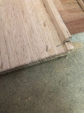

Base of tray after being router planed.

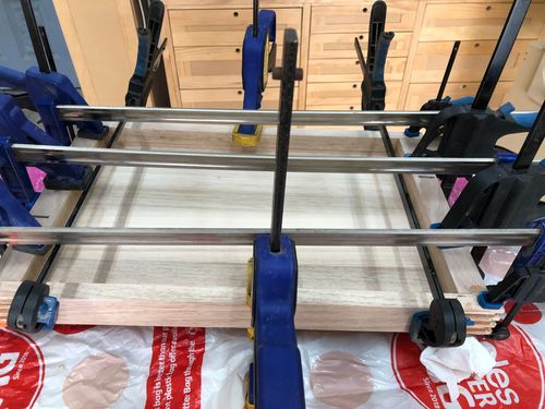

Glue up and clamping. I used weather resistant glue, Titebond 3.

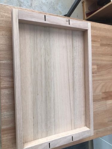

Slots were routered to fit the leather handles

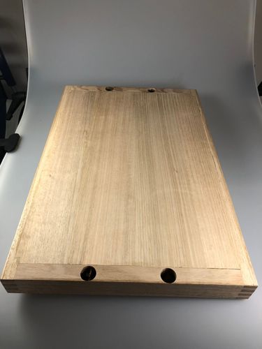

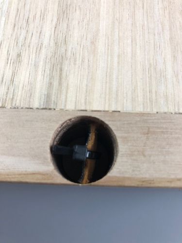

Holes were drill on the under side of the slots to hide the leather handles securing, I punch ed a hole on each side at the end of the leather and inserted an electrical tie to prevent the handles from pulling through.
Electrical tie shown here.

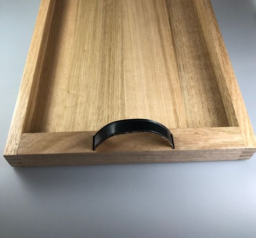

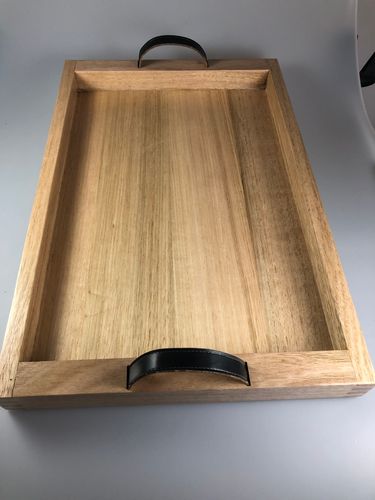

After lots and lots of sanding, it's finished.
Finally done. Well worth the effort for me.
