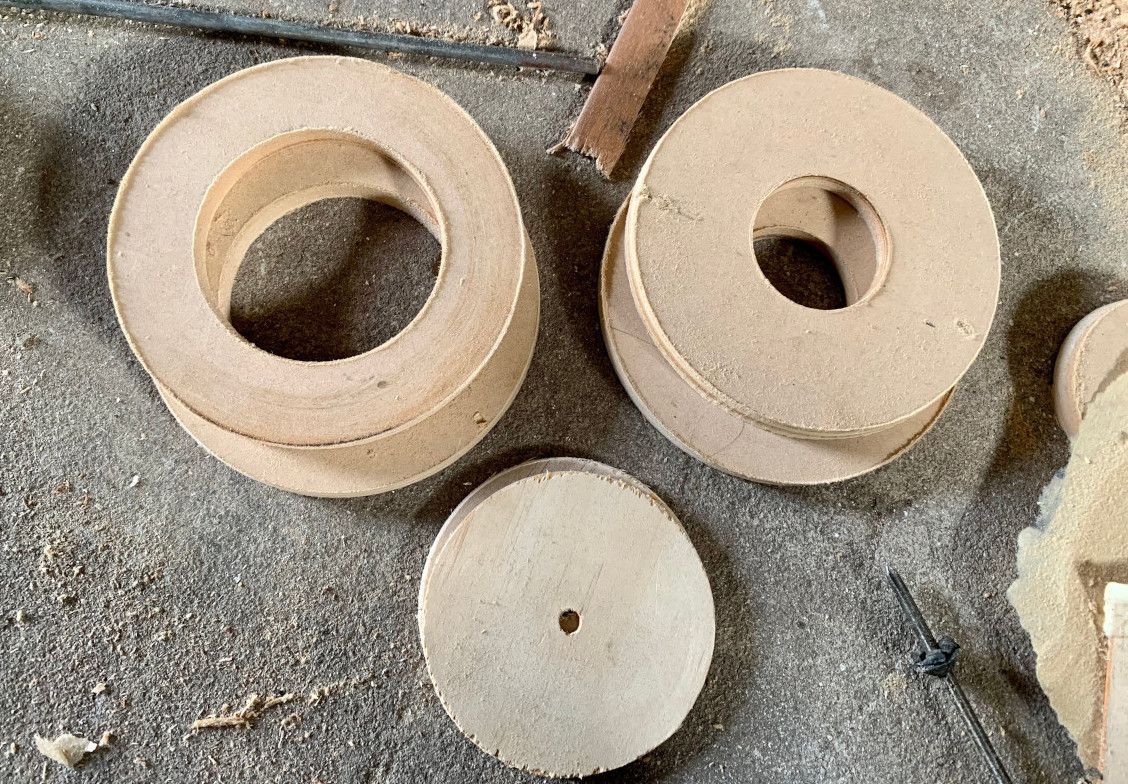

I looked at the various timber offcuts I had and decided to make the top and bottom ring plate with MDF (in future I would definitely use plywood or Pine!). I used a 120mm hole saw to cut four discs of 12mm MDF, then a 100mm hole saw to cut two discs of 3mm ply.

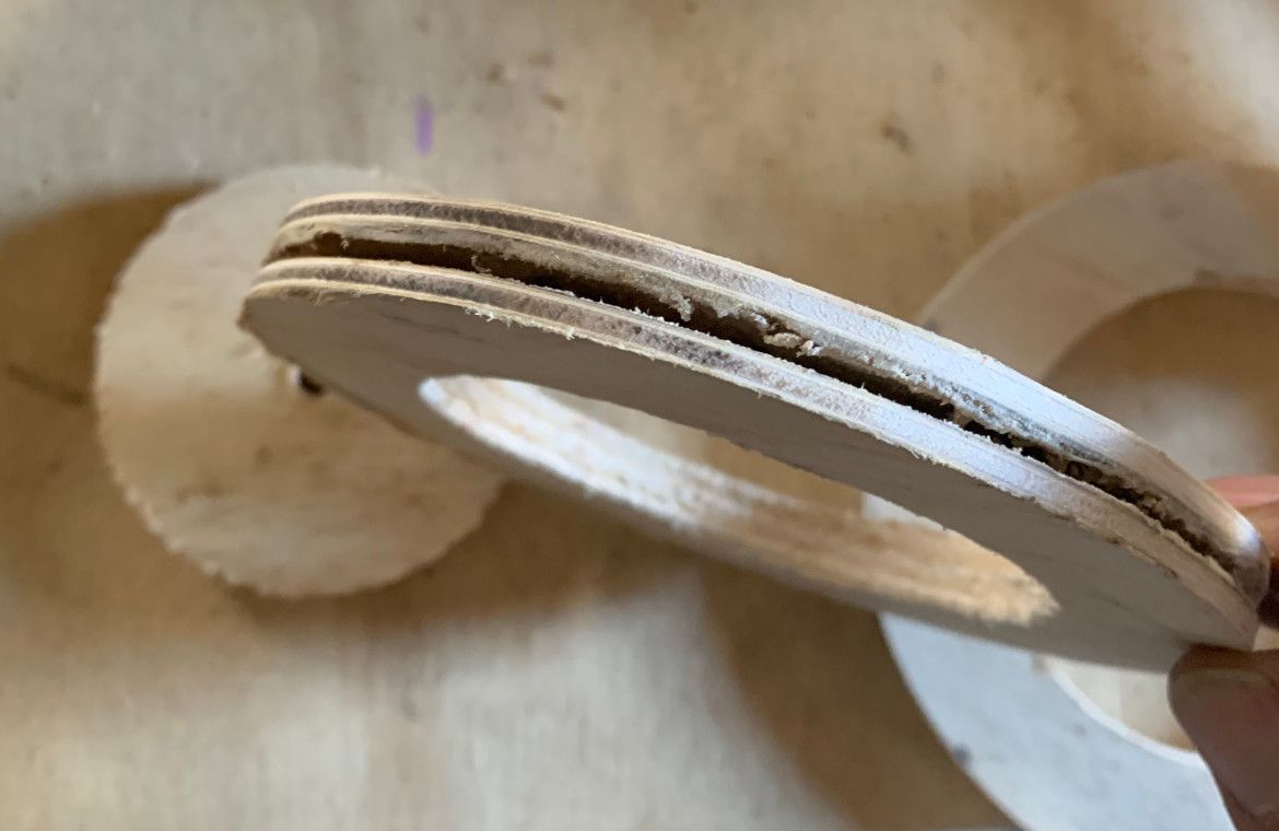

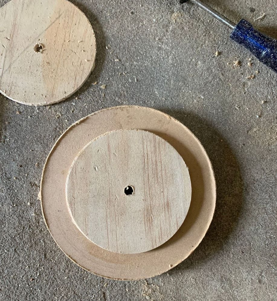

I took two of the large discs and one of the smaller ones and glued them together so that the two large discs sandwiched the smaller one.
The above picture shows discs made from ply. I scrapped these as they weren’t strong enough. But the picture shows the gap you will have between the three circles. This gap will later be used to insert your wood to create the pendant.
I then placed a heavy weight on the discs and allowed the glue to dry overnight.

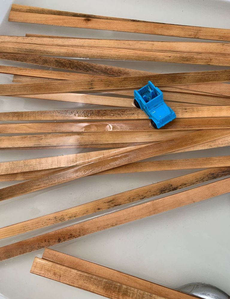

I soaked the timber in hot water for an hour in the bath. My son thought it made a great car ramp!

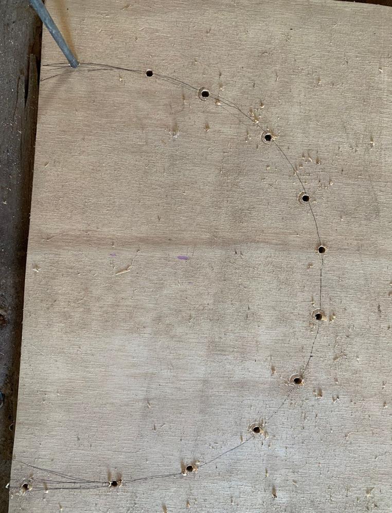

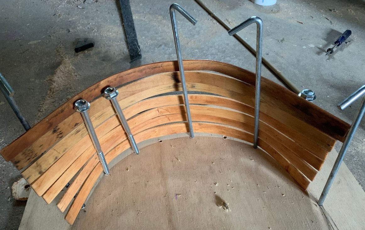

While the timber soaked I made a jig that would allow me to bend the strips so they had to extra flex when I put the pendant together.
I used whatever pegs and screws I had handy as supports and placed them in the holes I drilled. I wiped down the wood strips and carefully bent them around the supports, as you can see below.
I allowed half to dry overnight and then did the other half in the morning. You could make two two jigs to do the whole lot at once.

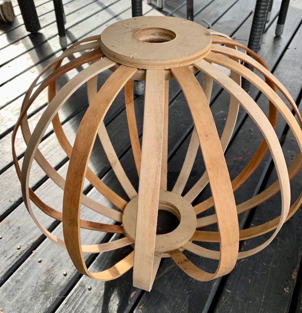

I then inserted four of the wooden strips, equally spaced, then attached them to the top disc.
I then repeated the process until I had 18 strips inserted.

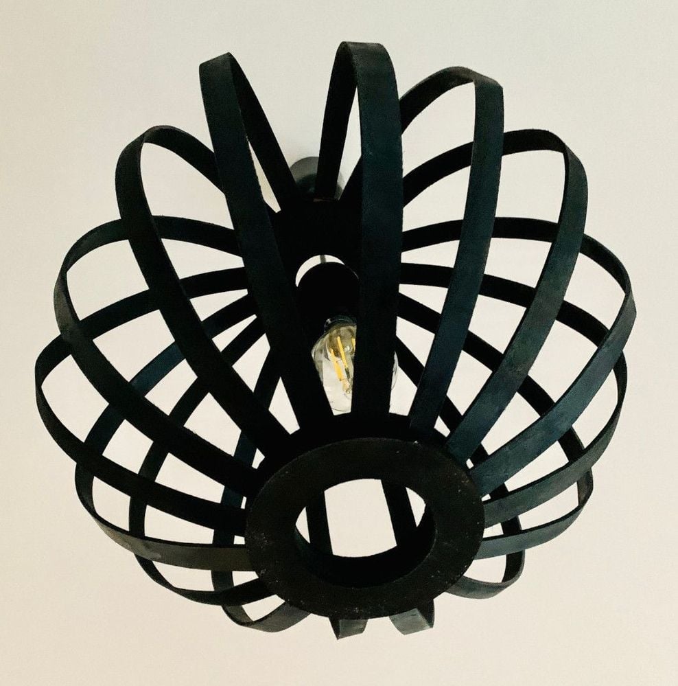

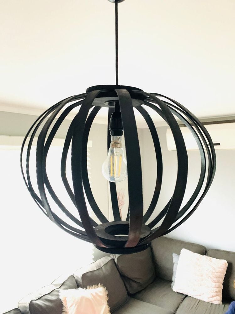

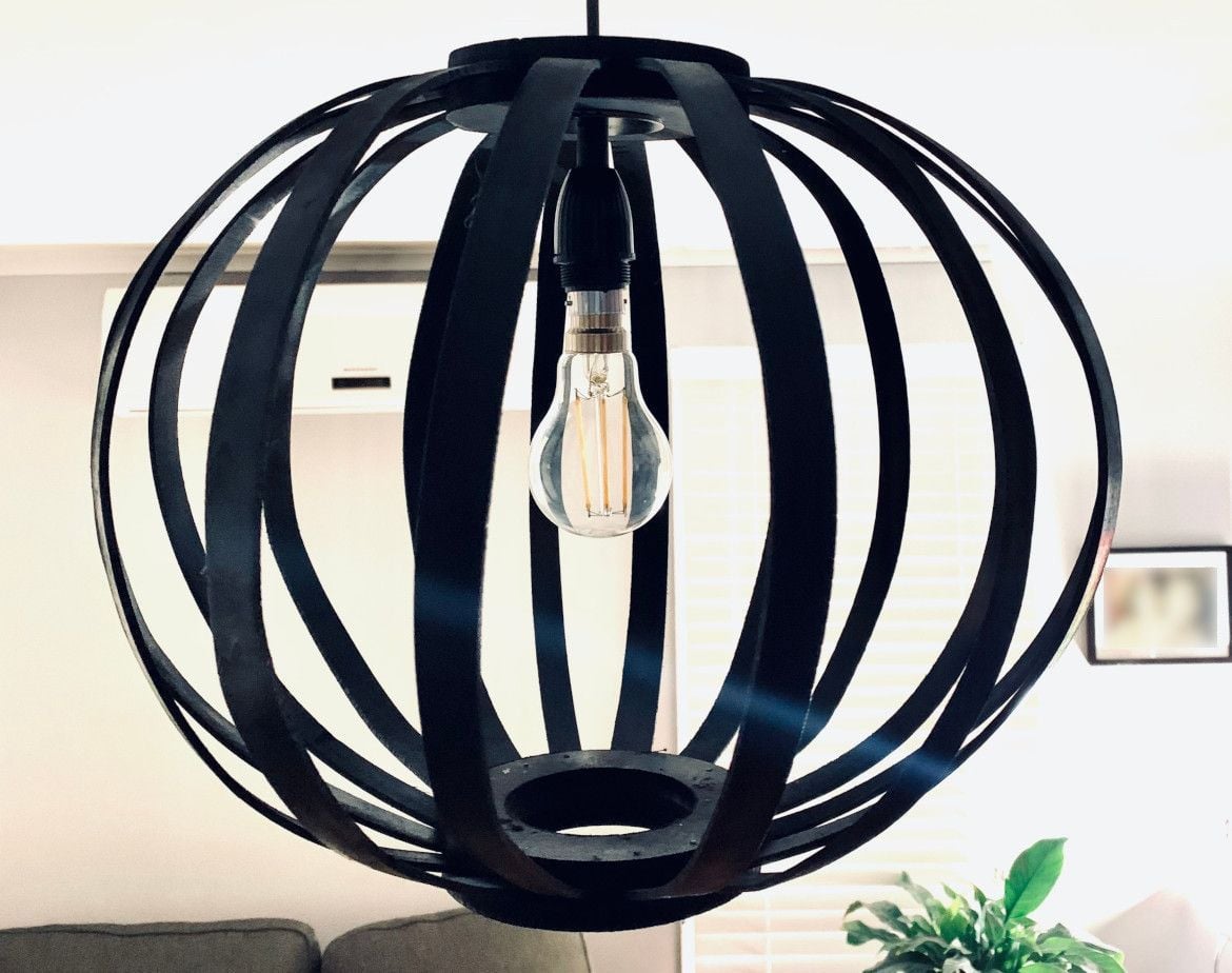

I added some extra nails between the plates for extra support. I sanded and painted ... and there was light!
The thin strips can be moved, so a larger bulb would fit too.
