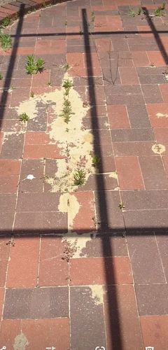

Hoping to get rid of 1) all weeds growth along the bricks lines for good (or at least 5-10years, if possible), particularly more during rainy season in winter & spring, without the use of any chemical spray on an uncovered patio area (if possible) use for BBQ. There's a fruits bearing grape tree & other plants nearby, hence harsh chemicals is to be avoided. 2) flexibly seal up the gaps in between bricks & stop ants (potentially living underneath the bricks) from lifting up soils underneath to the surface, with minimal risks of cracks later on between brick lines & on bricks (in case of expansion/contraction along the lines & edges.
Planning to pressure & blow wash the entire Patio to have all the soils & weeds cleared from the surface. What should I use to properly seal up all the joint lines, in the most efficient & effective way, with minimum impact to veggies & fruits bearing plants nearby ? Thank You.
