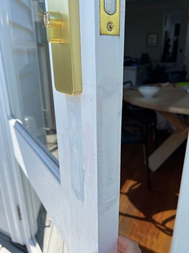

How can I paint this so to get a good coverage without having to do the whole door again?

Is it just this section that the paint hasn't covered sufficiently, or are there other areas? You could attempt to touch these areas up with additional paint, but you'll get the best results if you paint the entire door with another solid coat. I'd suggest touching up the areas with another coat and seeing if you are happy with the results; if not, paint the whole door.

@MitchellMc is right you will get a much better finish repainting all over as a even a different brush will leave a possible different texture. Even if you painting out of the same paint can colours need to be mixed in properly.
Sorry to say Dont forget to remove door handle and door jamb metal hardware before painting if your skill lets you.as tape masking not always so precise. Use you phone camera to record where the door bits are positioned as you dismantle them at need
If you are using exact paint colour if you are careful you can cheat painting near the door glass and not go right into the corner touching the glass using artist small paint brush. this will save on masking up and avoiding paint bleeds onto glass and having to scrap paint off. This seams ironic painting full door but missing a paint slither but if you are careful this will save you extra time and work. But mask up windows with good quaility masking tape ask at Bunnings paint section for the non bleed tape.

I'm in total agreement with @MitchellMc and @Jewelleryrescue. Repainting the entire door will give you a nice uniform finish. I know you were keen to just do a bit of the door, but giving your exterior door a uniform finish means that the paint will be evenly spread and provide you with even protection.
I suggest using Bear 24mm x 50m Washi 14 Days Masking Tape. It will provide you with a superior seal and resists bleed-through. It provides clean sharp lines and has UV resistance. Make sure to use Pro Renovator 38mm Plastic Scraper to make sure that the tape is flush with the surface.
It’s just this section, but have take. On board all tips
