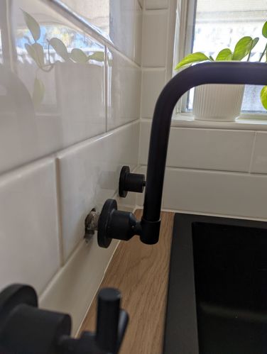

Hello community, we got our laundry renovated and we're trying to change the taps.
The bit that there spout attaches onto sticks out too far from the wall, any suggestions as to what we can do? I.e is there a collar/cap we could put in between? TIA
A Licensed plumber would probably have to tools to shorten and clean up the thread. This should allows the tap outlet to fit flush to the wall.

It's great that you've received excellent advice from @SteveT. Getting a registered plumber is an ideal way to trim down the length of the threaded outlet in your wall. Just to add to the suggestion made, you can also use a raised cover plate to cover the gap between your spout and the wall. I recommend measuring the gap you have and having a look at the cover plates available at the store.
If you're feeling creative and looking for something similar in shape you can use a Holman 50mm PVC DWV Push On Cap. You'll need to drill into the centre of the cap so that it fits into the threaded outlet and spray-paint it black to blend in with the tapware.
