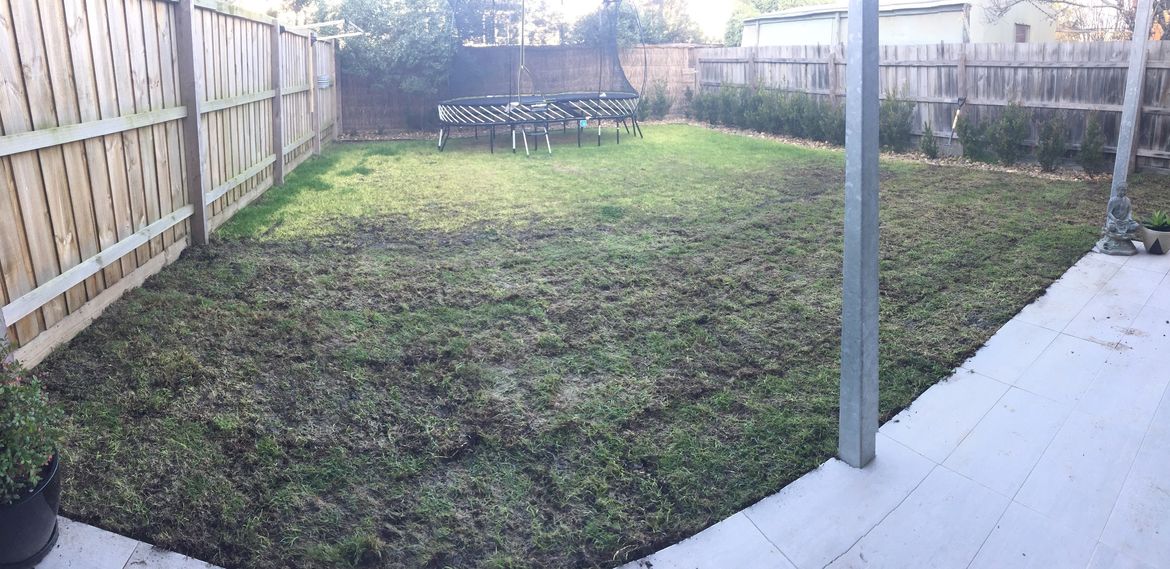

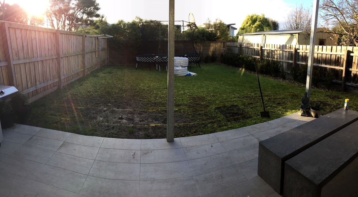

Photo 1 - The before shot. Muddy mess, drainage lines marked.

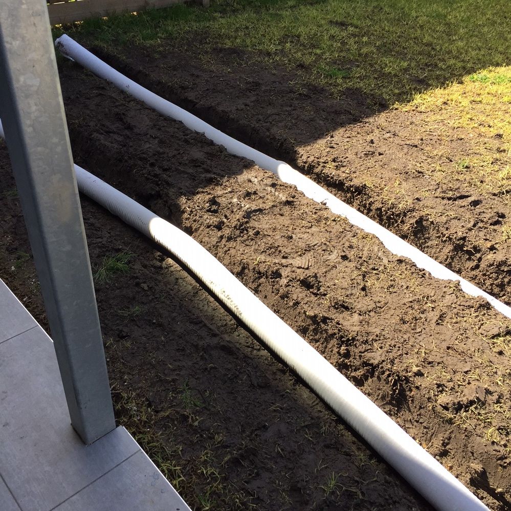

Photo 3 - Agi pipe with a filter sock laid into drainage channels

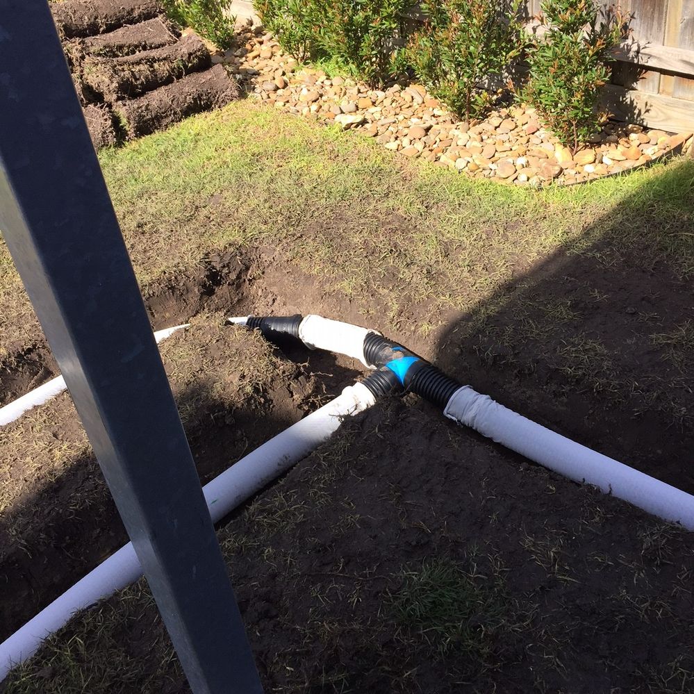

Photo 4 - Intersection of pipes as they lead around to the existing drainage pit
Photo 5 - Agi pipe / filter sock shallow end

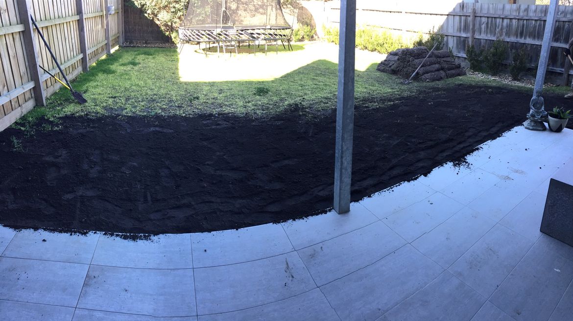

Photo 6 - with agi pipe laid, drainage gravel poured into the channels and top soil spread across the top.
Photo 7 - freshly laid turf and the finished product. We decided to lay turf above existing ground level so that the grass level was flush with edge of patio.
Previously the patio floor sat about two inches higher than the grass.
Kids now pace back and forward on the patio trying to work out how to get to the trampoline! 😂
