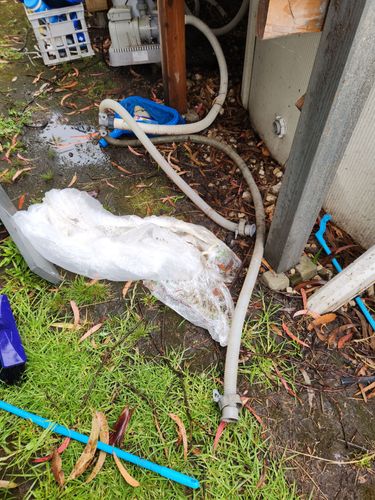

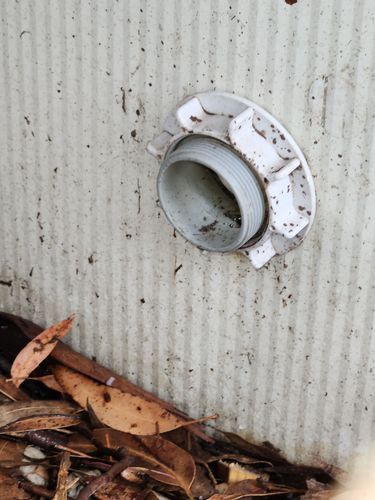

Eric, the pool is already in situ. Just changing over hoses to pvc. Have included some photos on my other post

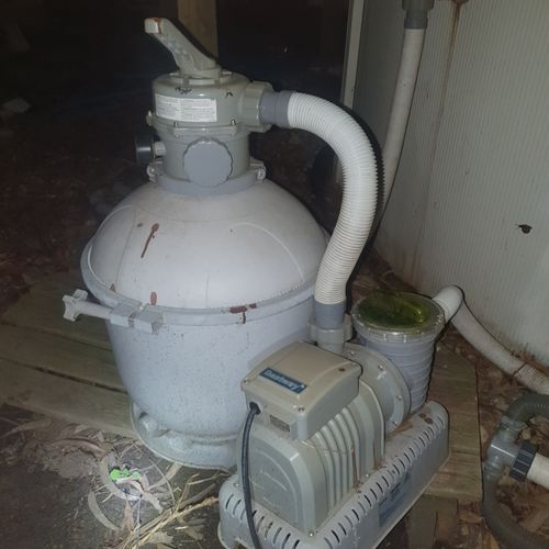

Thank you for posting those images of your pool pump. You'll notice that your hoses have a very specific fitting that allows them to sit flush with the pump mounting. One way to link them with standard PVC pipes is to measure the outer diameter of the fitting and the inner diameter to see which side we can use. The drawback with this method is that you'll need to cut the hose to use the PVC fittings.
The good news is that the hoses can be replaced and is available from the pump manufacturer. I'm afraid this will have to be a test-and-see situation in order to find out which PVC pipe is compatible with the fitting. I've placed a sample sketch below to give you an idea of what you need to measure. I suggest bringing one of the hoses so that you can compare it to the PVC pipes at the store.
The sizes I've indicated on the sketch are for example only, they are not the actual size of your fittings.
Let me call on our experienced members @TedBear and @MikeTNZ for their recommendations.
I think your best option would be, looking at what you've got there,
Is to have a dedicated pool technician have a look at this installation.
Don't get me wrong, I'm not trying to pass the buck or blow you off here, the fittings you have are not something
a usual plumber would carry, they could possibly get them, but most pool technicians carry fittings like this in their vans.
And a pool technician would be the perfect person to recommend what needs to be done to bring your pool up to speed.
When was this pool last used?
I note that the filter on the pump inlet looks quite green, that could have happened over winter with the suction and discharge lines being left open to the atmosphere.
Either way that I can see, professional help is required to bring your pool equipment back to a good standard.
