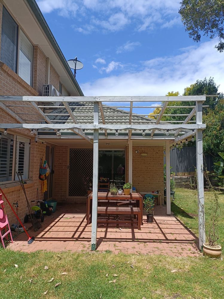

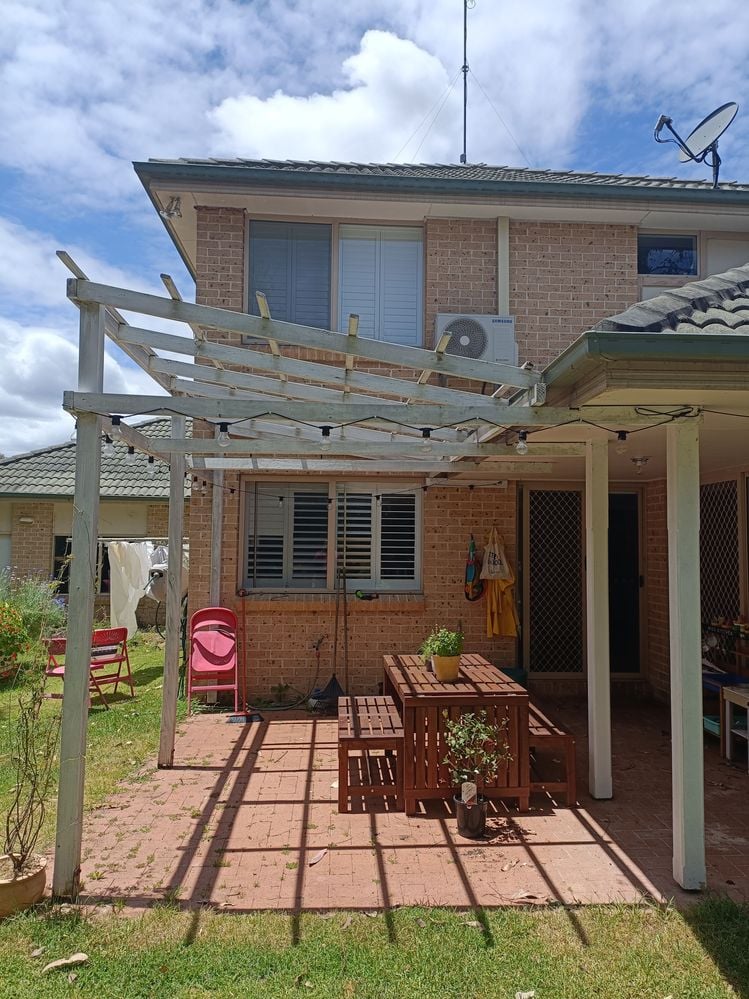

I'd love to install shade cloth to allow us to use this pergola area more.

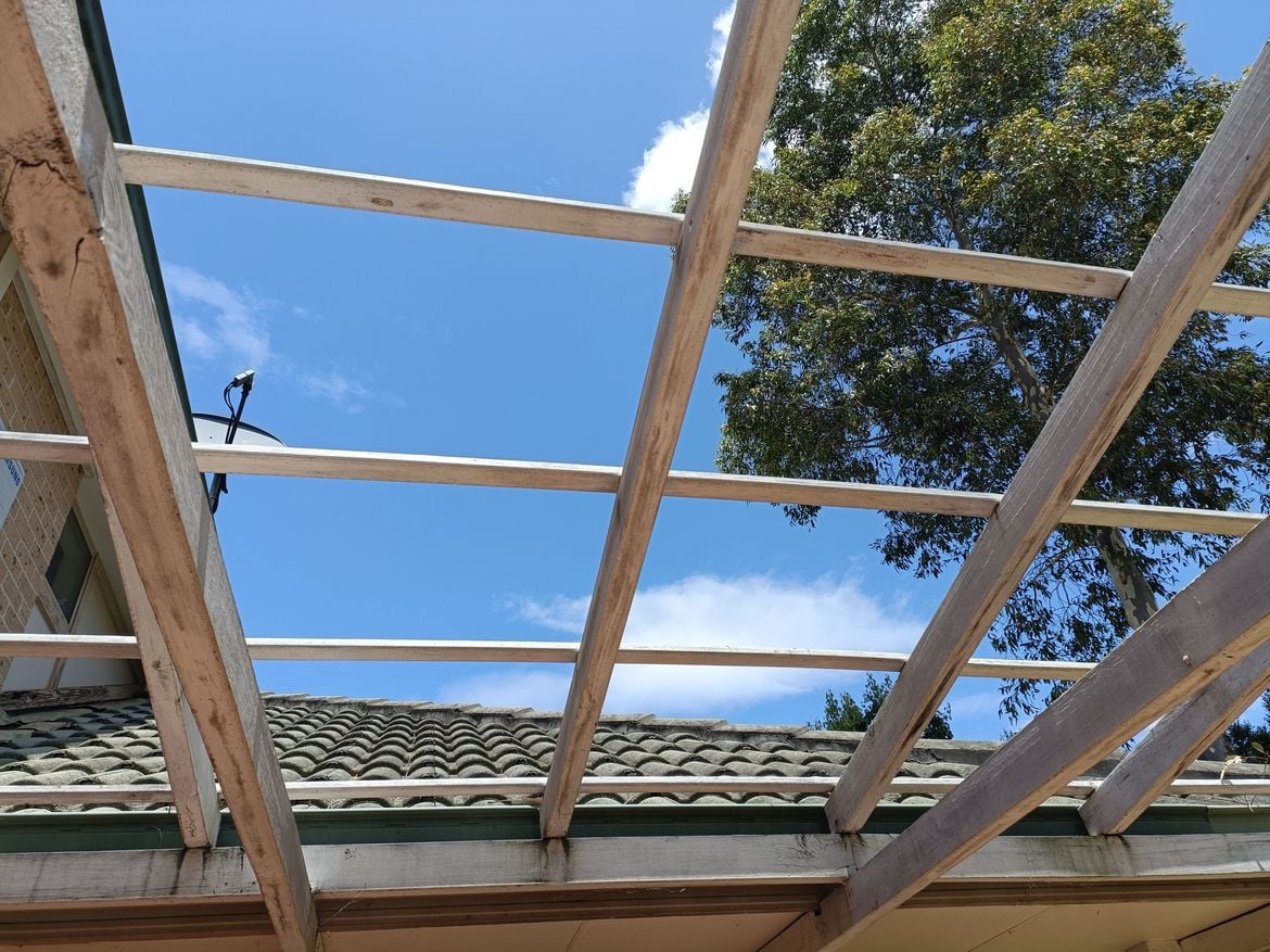

The approx. area is 4.2 x 2.5m and there is ~69cm between the top beams (there are 6 long sections of 2.5m so need approx. 15m of shadecover at 70cm width?)
I only need it to last 2 years or so, but do want good UV protection.
I understand heavy rain would come through.
My Qs:
1. Do my calculations look ok and is it feasible to cut this product up in this propsed way:
Cut this into 70cm strips (would cover 5 sections) https://www.bunnings.com.au/coolaroo-3-6m-wide-70-uv-shade-cloth-per-metre-stone_p3300427 $29.80/linear metre. Need 2.5m = $74.50
Cut this into 70 strip for final section https://www.bunnings.com.au/coolaroo-1-83m-wide-70-uv-shade-cloth-per-metre-stone_p3300426 $14.90/linear metre. Need 2.5m = $37.25
2. If I'm only expecting this to last 2 or so years, is a staple gun a fine way to install? Or do I have to use timber fasteners?
3. Would you install the shade cloth from the top of the beams, or from underneath?
MANY THANKS in advance for any advice you can give. I've never done anything like this before, but would love to learn how.
