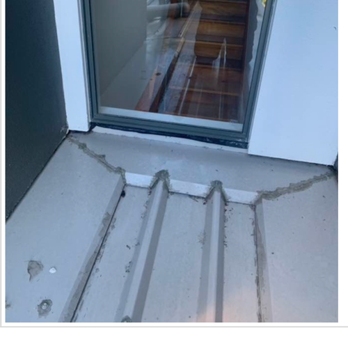

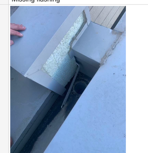

I am trying to self repair our roof as we can't find any one atm. This roof is
Trimdek and Colorbond, Please can you advise what is the best way to fix the following two problems;
1) Hole in Trimdeck
2) Missing Flashing

Thank you for sharing your question about repairing your Colourbond roof. I suggest a combination of Australian Handyman Supplies 1200 x 600 x 0.55mm Galvabond Mini Sheet, Selleys 290ml Grey Storm Waterproof Gutter And Roof Sealant and some Blind Rivets.
I propose measuring the area you're trying to cover and cutting out the general shape of the patch using tin snips making sure to allow for overlaps. You can use ordinary timber and a mallet to make the bends in the mini sheet. Make sure to test fit the patch so that you'll know that it covers the area you're trying to repair.
When you're confident that the patch is in the right shape, do one more test fit and drill pilot holes for the blind rivets. Apply the roof and gutter seal and fix it in place with the blind rivets. I've placed a sketch below to give you an idea of what it needs to look like. Please have a look and tell me what you think.

Finally got around to doing it, did i quickly and didnt have the equipment to get nice right angles, buit it works, thank you for all the info

Thank you very much for posting that update. The repair looks very good and should prevent rainwater from entering that section of your roof. Your choice of using the Cromellin waterproofing set is perfectly fine. I suggest looking at the Dulux Weathershield to paint over the repaired section.

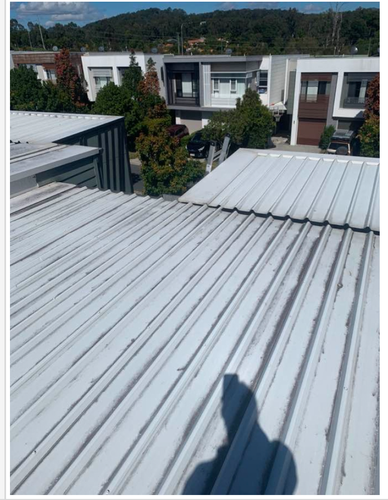

My next project to seal the roof;
One simple question, I need to replace the Neoprene Washers and screws, Can you please advise the size or link to suitable product and size. Also, replace screws just in case..
My plan is to ;
1. Replace all Neoprene washers and screws.
2. Remove all existing Sealant.
3. Apply Crommelin Exterior Grade Waterproofing ontop of Screws (Overkill, but hope it works for 40 years.)
4. Use Crommelin Exterior Grade Waterproofing and Reinforcing Fabric on all joins. Apply one coat, apple fabric, wait 4 hours, Apply finial coat.
5. Wait more than 5 days and apply Dulux White UV resistant Paint. (Any ideas which products, I should use , maybe Dulux Acratex® line???
So, this is the list of items to remove the sealant and reseal the joints. Just want to double check if this is ok,

Your list appears to be fairly comprehensive, and you should have everything you need.
Dulux Acratex is certainly a premium option that you can use on your roof, and it's typically considered the trade and more robust alternative to the Weathershield range.
