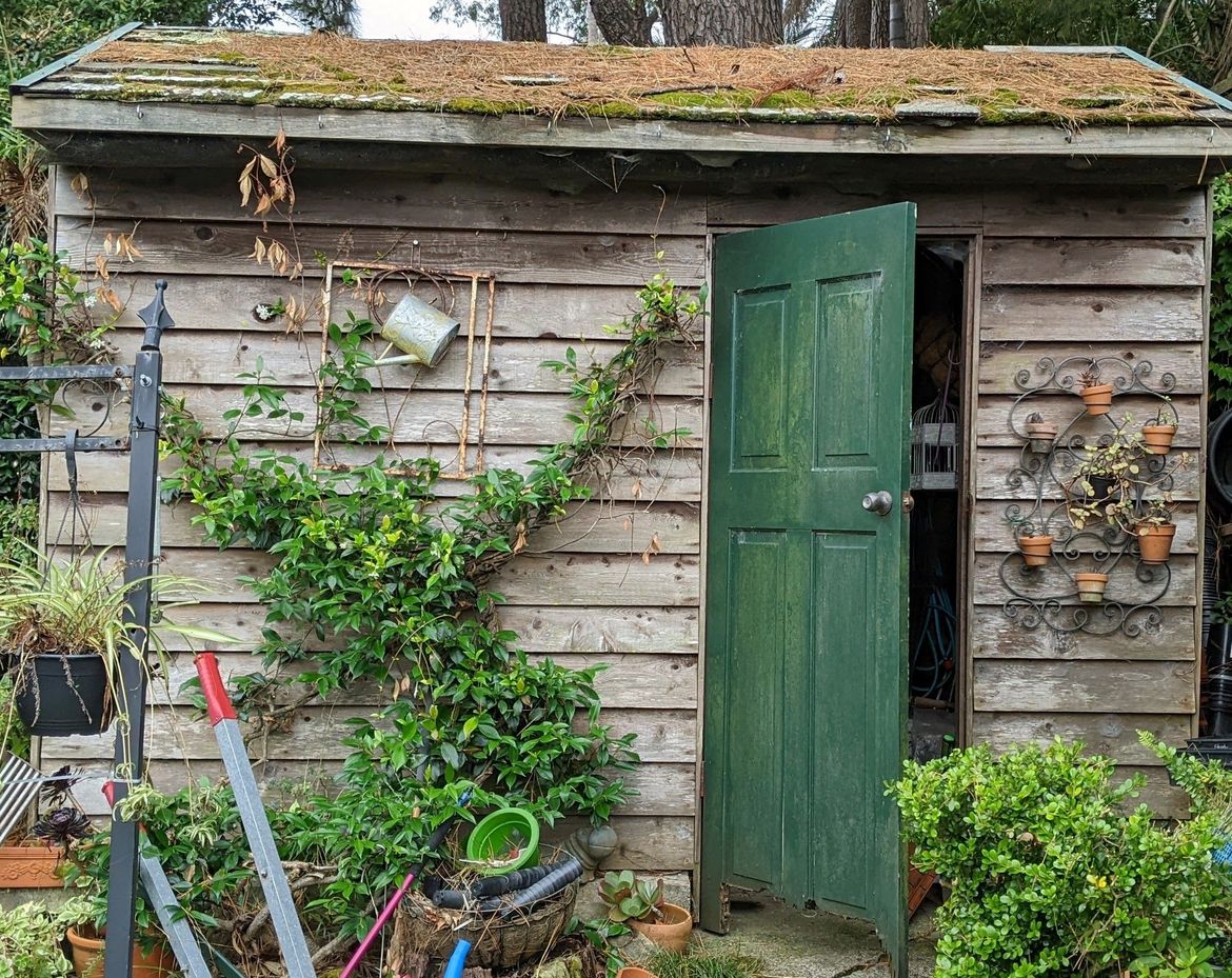

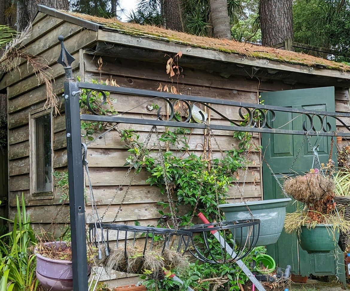

The shingles on this shed roof need replacing, but I would like to ask if it would be better to replace them with another material. What DIY options do I have to repair this leaky roof?

Personally, considering there is already sarking under the top layer of shingles, you could put either a layer of corrugated iron or coloured roof profile in place.
Bear in mind that you will need new flashings and hip caps to seal the sides and the top of the roof.
If you are going to do this work yourself, please make sure that the shingles have not caused the sarking to become wet and moudly, if this is the case, the plywood sarking will need to be replaced.
You can do all of this yourself or you can get a roofing company in to do this, if you aren't comfortable with heights.

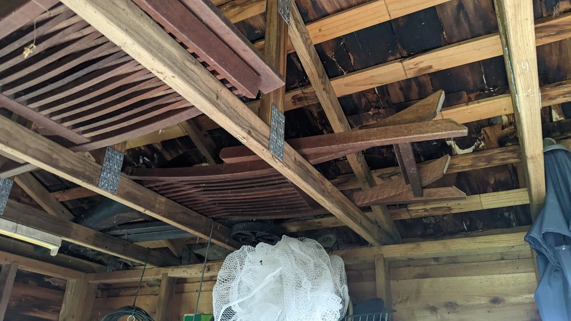

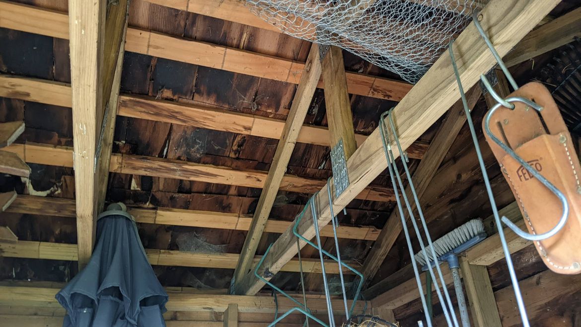

It's hard to tell from the photos but the shingles are directly on the frame in a single layer, perhaps the daylight looks like sarking!

You're right, the shingles do look like sarking on the underside of the roof!
What I would do first off, is remove the shingles, see what sort of water damage there may be to the top plates and the like,
replace any dodgy looking timber before you start on anything else
Considering you already have purlins installed, I would look at some bituminous builder paper on top of the purlins and screw the steel sheeting
to the purlins.
Bearing in mind, you must only screw through the upper parts of the corrugations or profiles, putting screws through the lower parts is guaranteed to cause a leaking roof, through capillary action, be warned.
