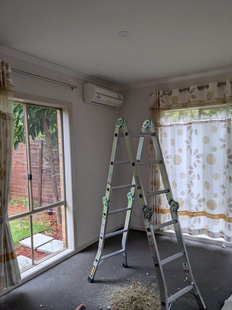

Had some work done on the ceiling for some downlights. Some fluffy insulation fell out - just wondering if it's a good idea to put it back inside the ceiling or not?

Hay your insulation looks like mine is treated paper (cellulose ) a very under rated resource and recycled material. Fire proofed rodent proofed and they wet it with stuff that sets the top like a crusty skin so wind dosnt blown it around. Lower cost too no itching.
@MitchellMc is right a small amount of insulation from around lights is not a problem but if it adds up to be a garbage bag full collect it and next time you access the roof take it up and tip it out Either way you probably wont notice any insulation temperatue changes.
I had to replace a meter square section of water damaged roof so it was worth while I collected it up and returned a big bag full after it dried out returned to the repair location.

If this were a new light installation, a portion of the insulation would need to be removed to provide clearance to the rear of the light. I suspect this insulation was simply behind the light fixture area. If the appropriate amount of removed insulation is considered, the remainder is negligible and doesn't need to be returned.
