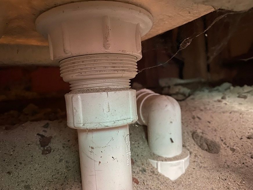

Hello Eric
Since that time in January '23, I asked for advice on "How to loosen the locking ring from the bottom of the tub" - Now I am up to that stage.
Please see picture of my locking-ring under the bath tub - What tool do I nbeed to remove, loosen this ring?my locking-ring under my tub
You've done excellent work in getting access to the bottom of the tub. I suggest using Multigrip Pliers to unlock the giant plastic nut that is holding the bath waste in place. It might be very tight, please make sure you have an extra pair of hands to help you in turning the locking nut.
Please make sure to wear personal protection such as gloves and goggles when working on your project.
Hello Eric -Thank you for your encouraging words - Yes, I got to it by applying the technique used in the video you sent - How to Remove tiles (my tiles were surrounding the bathtub). I will purchase the Multigrip Pliers - I'm certain the Craftright 250mm Multigrip Plier, will suffice? Before I do that, I will ask one question, does Bunnings hire out plumbers? Or recommend a plumber? - Once again and 100 times over - THANK YOU 😊

Hello Eric,
I did it - Thanks to your wise words and great instructions, also D.IY videos - I managed to do it all by myself🙌 Except when loosening the tub-sink - My good neightbour had pliers and came and did this for me🙌
I have move the bathtub and now I need to "block or cap" the drain?

Hi @Minitots101,
You can unscrew the S bend from the outlet pipe at the location I've marked below. It's the same process as undoing the pipe from the drain waste. Once you've undone this fitting, a 50 or 65mm cap can be glued onto the pipe to seal it. Just measure the pipe and pick up the correct cap at your local store. Please note that depending on your location, this might be considered plumbing work, requiring a licensed plumber.

So, once the cap is glued onto the pipe to seal it, can I then cover the entire area in cement?
See a clearer image of the same pipes sitting in the sandy area, the rest of the floor is cemented.
Please advise 😁Can I cemement where purple border iscan i saw the pipe lower and seal it?
That is correct, @Minitots101. However, once you undo that nut and disconnect the pipe from the S bend, you should be able to pull this entire S bend section out of the sand; no need to cut the pipes.
Mitchell - you're brilliant - thats what I'll try now🙌
