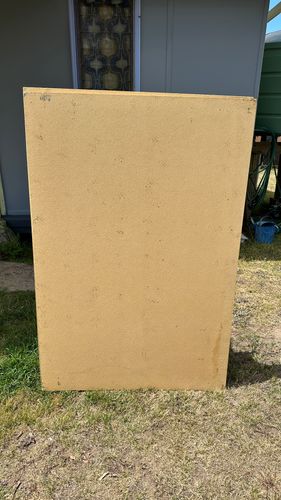

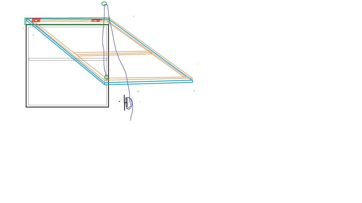

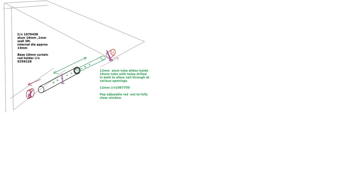

I'd like to build a solid wood panel window cover (just think of a rectangular piece of wood e.g. 1000h * 750w) that can:
- be flat against the window to protect from hail when need be, and/or
- can angle out from the bottom like an awning (hinge?), and/or
- can move squarely out from the window allowing for air but blocking sun/neighbours, and/or
- be able to open on either side in order to catch the breeze and drive it into the house from the left or the right
I have one little old window in the kitchen which only opens on one side, which was the catalyst for this post.
