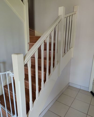

I have a staircase which is right now painted with oil based paint (not sure of number of layers). Can I paint it with stain and varnish? I want to change the colour of the piller to a darker shade.

Can you please confirm what kind of look you are after? Are you wanting to return the railing to it's original timber? Or are you just wanting to paint over in a different colour?
If it's the latter, you can simply paint over the existing paint as long as it is in good condition - that is, it is not peeling off. Most people would just give a light sand to ensure the paint adheres well and use an oil-based paint again.

Hi again @nitin0424,
To use a stain you would need to sand to remove all traces of paint, which would be a difficult task given the shape of the railing.
