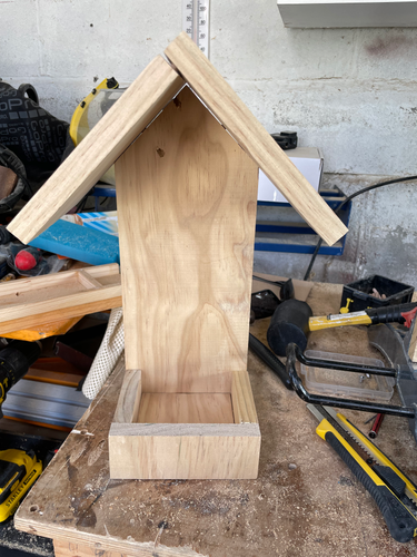

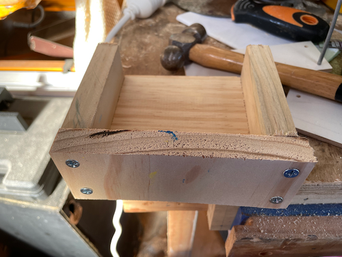

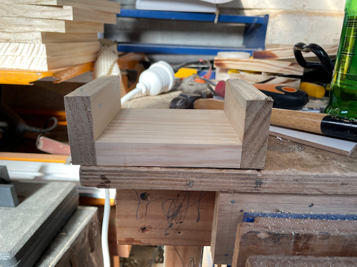

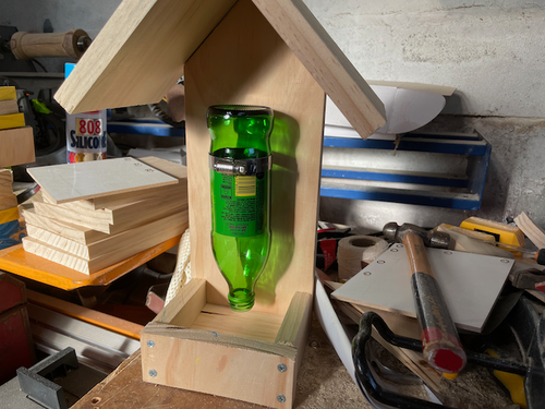

I can make one of these from one 1200 x 140 x 18 pine board from Bunnings. They're pretty simple construction but the first one I made differs immensely from the one I'm currently making. The first one I had the front butt up to the sides on the inside. Subsequent ones I had the front cover the sides thus hiding the end grains. This also gives the tray a little extra room while making it shallower for the smaller birds to easily get at.

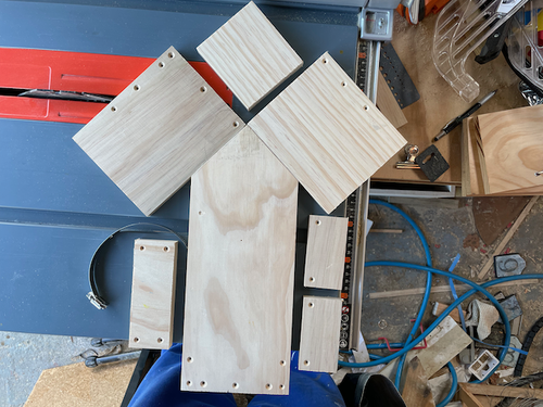

For the first 8 I used screws to hold everything together. I do however regret this look which is why for the current one I am using 6mm dowels. As you can see from the photos, this makes everything look so much nicer. I purchase a pack of the PG Professional 6mm Dowel Jointing Kits which gave me the dowel centres that made doing this so much easier. With that purchased I also purchased a PG Professional Dowel Fluted 6mm 60pk for stock because I'm at a point where I think I've nailed the construction of these.
However, I did find that the templates I made for the construction are now all wrong because the holes were drilled for the screws and I'm not using screws any more. I'll have to remake the templates to mark out the dowel placements.

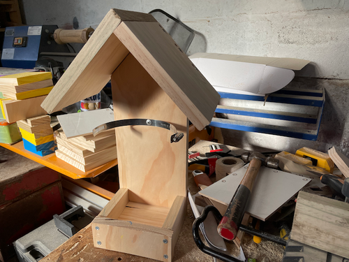

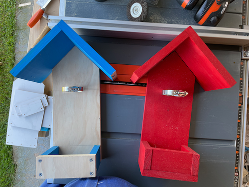

The bottles are held in using a Kinetic 46 - 70mm 316 Stainless Steel Hose Clamp which I cut to size and drilled a hole in the centre. They work great and can be loosened using either a 7mm socket (the driver end of a bit driver is 7mm so you can use that) or a screw driver.

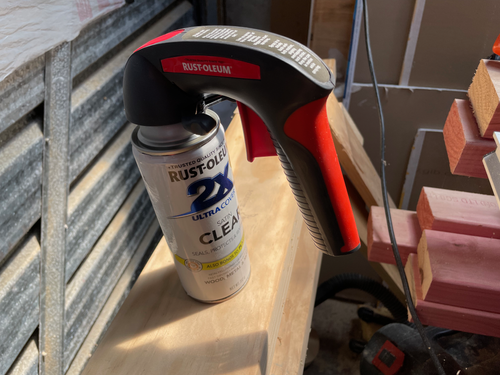

The first 6 I made Little Wookie and Mrs Wookie painted. The last ones I used linseed oil for a more natural look. ALL of them I covered with Rust-Oleum 298g Clear Gloss 2X Ultra Cover to protect them from the rain. I found a Rust-Oleum spray can gun at SuperCheap which I can say is magic for using spray paint.
