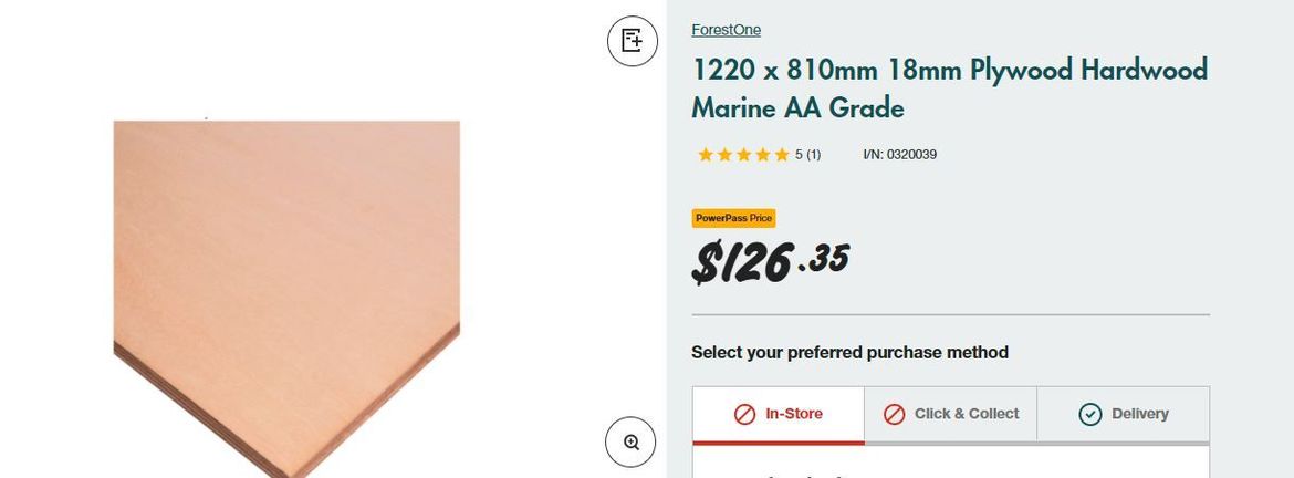

Thanks, It's a wheeled big box which I will make it to use it as dust bath for chickens. That's why I got a premium marine grade poly wood and I will reinforce it with 35 x 70mm pine. I will seal it with Marin Spar Varnish of Feast Watson at the end. Wheels are heavy duty locking casters.
