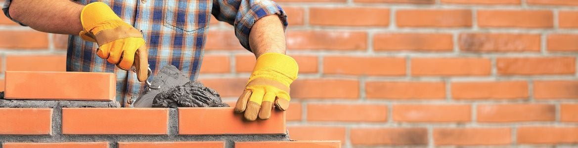

Mortar is made to be pliable and stickyMortar
Mortar is a blend of sand and cement, with hydrated lime (calcium hydroxide) added to make it sticky and more workable. It’s used for bedding and joining bricks and blocks in walls and other structures.

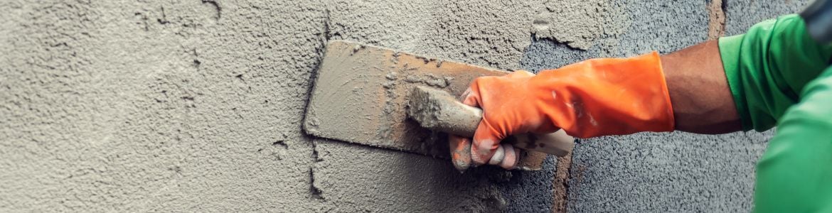

Render
Render mixes are similar to mortar but usually include more fine clay to further increase plasticity. Render is used for coating indoor and outdoor brickwork and block work to achieve a consistent finish.

Mortar
General purpose – 1 part cement : 4 parts sand (brickies’ sand is often used)
More plastic/workable mix – 1 part cement : 6 parts sand or brickies’ sand : 1 part hydrated lime.
Render
1 part cement : 3 parts sand : additives to suit
Some situations call for adding 1 part hydrated lime (note that lime should not be included when rendering below a damp course).
Renderer’s clay or admixes may also be added.
